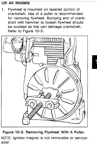

Texas Todd 1,026 #2 Posted June 6, 2017 You have to pull the flywheel to replace it. Pretty straightforward. Four bolts holding it onto the bearing plate beneath the flywheel. Pay attention to how the wire is routed. May have to loosen the bearing plate to get the plug through, or remove the plug and then re-attach. Share this post Link to post Share on other sites
B-100 10 #3 Posted June 6, 2017 Ok, so no gaskets or special tools needed? Share this post Link to post Share on other sites
Texas Todd 1,026 #4 Posted June 6, 2017 Just a wheel puller. There are some good videos on youtube of the process. Share this post Link to post Share on other sites

BOB ELLISON 2,983 #9 Posted June 6, 2017 (edited) I had the same problem with my c160 And it turned out to be a broken wire coming out of the stator. But I had to pull the cover and the rotor to get to it. I just soldiered it back and it's good to go. Sometimes that rotor is hard to get off. Put puller on and put pressure on it and use a hammer to hit the side of the rotor. Don't hit the fins. I use a brass hammer and a few Firm hits will pop it off. Edited June 6, 2017 by BOB ELLISON Share this post Link to post Share on other sites

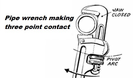

953 nut 67,248 #17 Posted June 13, 2017 6 hours ago, B-100 said: Is there anyway to lock the motor? You could remove the PTO and put a pipe wrench making three point contact on the crank shaft, rotate it so the key is touching the wrench so you don't damage the crank. 2 Share this post Link to post Share on other sites

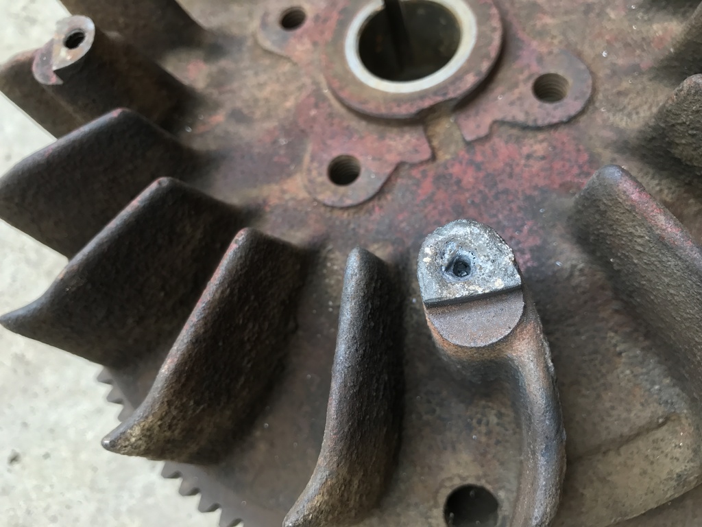

B-100 10 #18 Posted June 16, 2017 Ok, well I was able to get it all apart, got the stator off, but one of the bolts for the grass shield broke off in the flywheel. After trying to drill it out and having the bit break off, I figured since it was cast iron I could melt the bolt out. But in the process I melted some of the cast iron. Will this affect the balance? Share this post Link to post Share on other sites
pfrederi 20,828 #19 Posted June 16, 2017 Not that small an amount 1 Share this post Link to post Share on other sites
obone 142 #20 Posted June 16, 2017 I just replaced mine a few months back same model. An impact made it easy to get the nut off, but I almost broke the puller trying to remove the wheel. Be sure to lock tight the screws that hold the stator on. As I had one stuck in the magnet inside the flywheel when I first removed it. FYI the engine manual calls for 60-70 foot pounds. On earlier models with a 3/4"-16 thread it's 100 foot pounds. (Mines a 1977 and was the 60-70) Best of luck. Share this post Link to post Share on other sites
B-100 10 #21 Posted June 16, 2017 Does anyone think that the heat from the oxy-acetylene torch could affect the magnets? Share this post Link to post Share on other sites
pfrederi 20,828 #22 Posted June 16, 2017 I do not know for sure. I am working on a Techy right now with magnet issues. Tecumseh says hold a screw driver about 3/4" away from the magnet and see if it pulls it in...if it does it is OK. Would think the same idea should work for Kohlers..Check the magnet closest to your heat point,.. There is a lot of thermal mass in a flywheel I would think the the heat would have been dissipated. Share this post Link to post Share on other sites
953 nut 67,248 #23 Posted June 16, 2017 (edited) 1 hour ago, B-100 said: Does anyone think that the heat from the oxy-acetylene torch could affect the magnets? Depends on how close to the magnets the heat is. When heated above 176° Fahrenheit, magnets will quickly lose their magnetic properties. The magnet will become permanently demagnetized if exposed to these temperatures for a length of time or heated at a significantly higher temperature. If you are heating the area where you broke a drill bit I would suggest you wrap it with wet rags all around and under to act as a heatsink. Once you heat the drill to the point where it is red (1800 degrees) and allow it to cool completely you can drill it out because the heat will remove the temper from the drill bit. Edited June 16, 2017 by 953 nut Share this post Link to post Share on other sites
