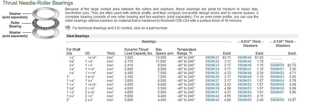

ronhatch 410 #13 Posted June 3, 2017 I found my steering to be hard on my C-101 too. To correct the problem I installed thrust ball bearings (poor mans power steering) in the spindles, replaced the 12" steering wheel with a 15" unit, played with the toe in and, of course, greased everything very well. It all helped, but it still steers hard, plus it doesn't turn as sharp compared to my 4016 Case or my B-10 AC which unfortunately, detracts from the mowing experience. 1 Share this post Link to post Share on other sites

DennisThornton 4,773 #17 Posted June 4, 2017 I think Mike will discover the cause when he jacks the front off the ground. But maybe we could expand this topic a bit by noting all that can be done to improve the steering. I drive my C-81 all over pushing snow and dirt & I don't complain about the steering until I've driven the Xis and hopped back on any of the others without PS. Can thrust washer bearings be added to the spindles of all the Wheel Horses? Any other tips not already mentioned in this thread? 1 Share this post Link to post Share on other sites
pfrederi 21,306 #18 Posted June 4, 2017 14 minutes ago, DennisThornton said: I think Mike will discover the cause when he jacks the front off the ground. But maybe we could expand this topic a bit by noting all that can be done to improve the steering. I drive my C-81 all over pushing snow and dirt & I don't complain about the steering until I've driven the Xis and hopped back on any of the others without PS. Can thrust washer bearings be added to the spindles of all the Wheel Horses? Any other tips not already mentioned in this thread? You can put thrust bearings on, but you will have to grind off a bit of the axle housing (top) so the spindle will stick up enough to allow you to use the snap ring. How to keep them properly lubricated would be a concern..this isn't a clean spot and dirt grit etc would stick to grease 2 Share this post Link to post Share on other sites
ronhatch 410 #19 Posted June 4, 2017 (edited) My C-101 spindles were really messed up because the PO ran it for quite awhile with bad wheel bearing. I replace them with spindles from a Jacobson that are longer in both length and height which in turn, allowed me to install thrust BALL bearing between the axle and new spindles. Ball thrust bearings are probably 3 to 4X the thickness of needle thrust bearings, but I felt because they are more enclosed, they would be less susceptible to dirt, plus the diameter of the balls are much larger then the needles which would also help ease the steering effort . The WH rims were ruined as well, so I also went with the wider rims/tires from the Jacobson. The wider tires may be a contributing factor to the heavy steering even though I maintain 20# of air pressure in the tires. This all raised the front of the tractor a little, but I like that look. Going from a smallish 12" steering wheel to a 15" helped as much as anything, plus it's better proportioned to the rest of the tractor. Finally, when I jack up the front end, it steers effortlessly. Edited June 4, 2017 by ronhatch Share this post Link to post Share on other sites

953 nut 70,340 #23 Posted June 4, 2017 3 hours ago, pfrederi said: You can put thrust bearings on, but you will have to grind off a bit of the axle housing (top) so the spindle will stick up enough to allow you to use the snap ring. How to keep them properly lubricated would be a concern..this isn't a clean spot and dirt grit etc would stick to grease I will be doing this on my GT-14 and plan to lubricate it then wrap with Heat Shrink Tape to exclude dirt. Only solution I could come up with. Share this post Link to post Share on other sites

953 nut 70,340 #25 Posted June 4, 2017 8 hours ago, pfrederi said: You can put thrust bearings on, but you will have to grind off a bit of the axle housing (top) so the spindle will stick up enough to allow you to use the snap ring. 7 hours ago, ronhatch said: I replace them with spindles from a Jacobson that are longer in both length and height which in turn, allowed me to install thrust BALL bearing between the axle and new spindles. Ball thrust bearings are probably 3 to 4X the thickness of needle thrust bearings, but I felt because they are more enclosed, they would be less susceptible to dirt, plus the diameter of the balls are much larger then the needles which would also help ease the steering effor Couple of good options here. Share this post Link to post Share on other sites
