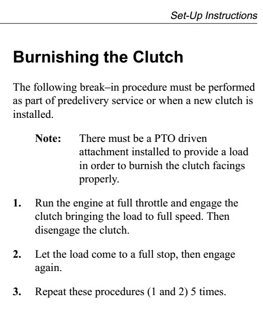

gwest_ca-(File Mod) 12,533 #5 Posted June 3, 2017 Likely nothing to do with the present condition but often wonder if the dealer would take the time to install an attachment so the following could be done as instructed at pre-delivery. Garry Share this post Link to post Share on other sites
slammer302 2,157 #6 Posted June 3, 2017 If I had to guess NO! I found my problem low voltage. The charging system isn't working. Did a quick check think is the regulator rectifier. Share this post Link to post Share on other sites
