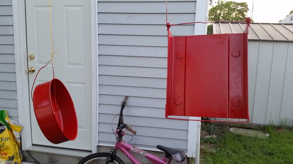

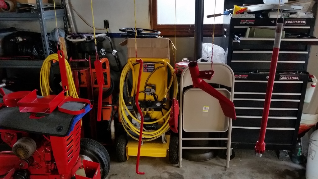

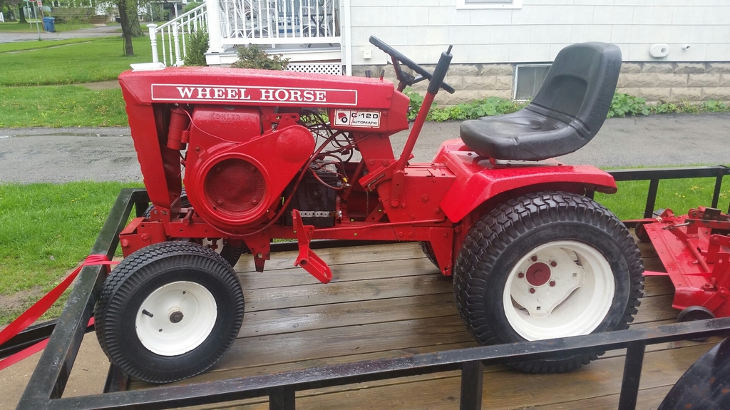

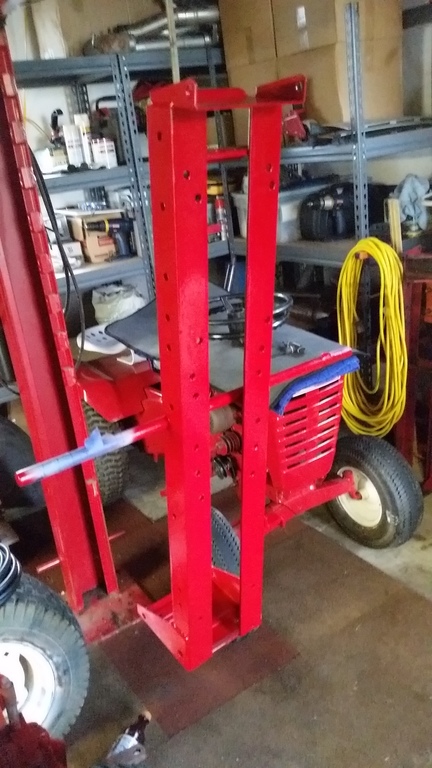

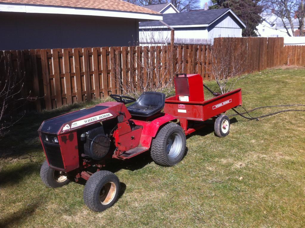

Tgtack 780 #1 Posted June 2, 2017 Will it get done? I don't know for sure, going to be close, but working everyday on getting this tractor back together and ready for the show! It is still in pieces right now, but back to making headway since I decided to use another frame and wait on doing the major repair to the original where the transaxle mounting plate is shattered. So here a few pics of what is happening right now. Frame is painted and ready for all the other parts. Front axle all cleaned up, back tight as a button, and painted. Dash support straightened, stripped and repainted. Hopefully I will get the tranny cleaned up and ready to paint tonight, headstand needs to go in the sandblaster tomorrow. Last pic is what she looked like when I brought her home. 6 Share this post Link to post Share on other sites

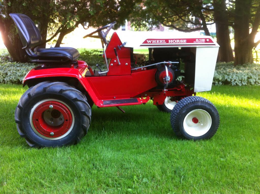

squonk 48,303 #3 Posted June 2, 2017 7 hours ago, WHX11 said: Looking good guy just do it on your own time and do it right. Remember haste makes waste and this ain't orange county choppers! Enjoy your restos and builds but keeping balance with family. The BS will be there next year too! Hug your kids. Yup what is it with all the drama on all of those shows. I did this tractor in 5 weeks. Bought parts at the big show. Had it done for another show the 1st of August a few years ago. YOU CAN DO IT! From this: To this; 5 Share this post Link to post Share on other sites

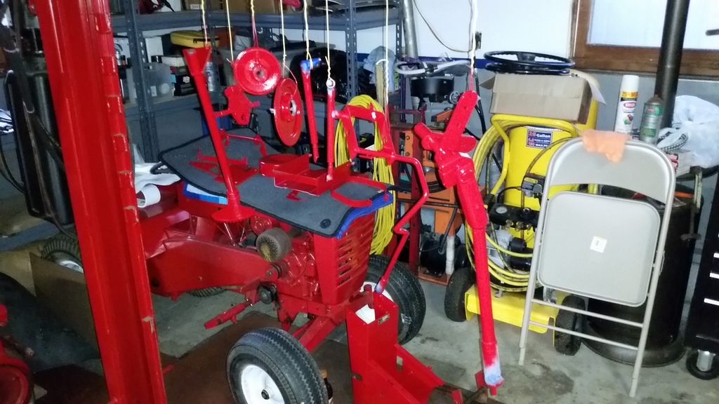

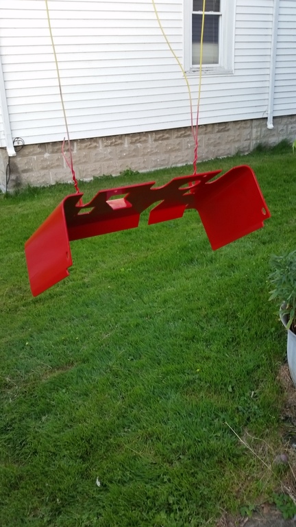

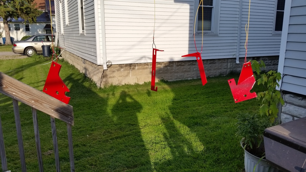

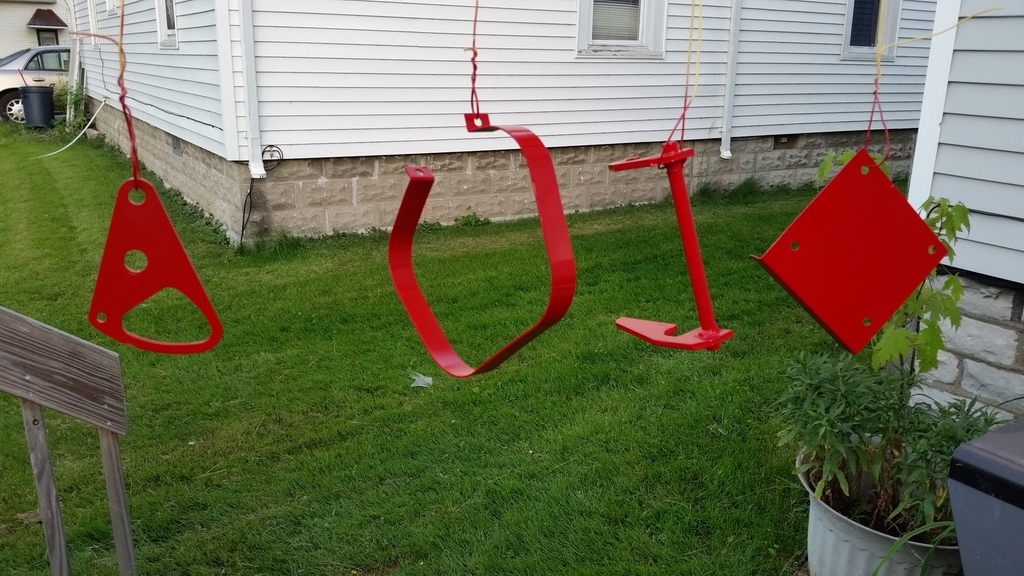

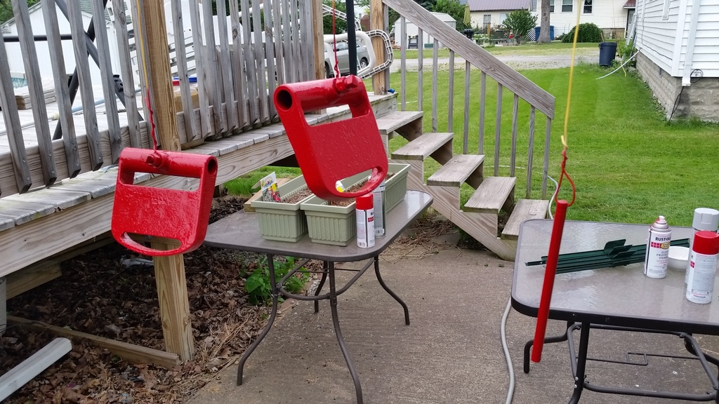

Tgtack 780 #22 Posted June 7, 2017 Sorry for not posting any info, been busy. Weekend weather was not conducive to getting anything painted. Got a few items shot late yesterday. Decals have been shipped, thanks Terry! Need to get the frame back on the tranny by this weekend to be done for the show. Big issue is the hood. Need to get old decals removed and painted. I am thinking about taking it to a body shop to see if they can work it in next week so I can concentrate on the rest. It also has two small holes drilled in it for somekind of a non original hood ornament (next to factory holes), need them filled. Got the cracks in the seat box welded up, need to grind them down and get it painted. Have a couple other parts, dash, lift lever, engine, and wheel/tire cleanup to go. So this is what was painted over last couple days. 2 Share this post Link to post Share on other sites

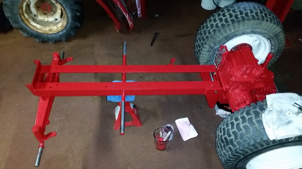

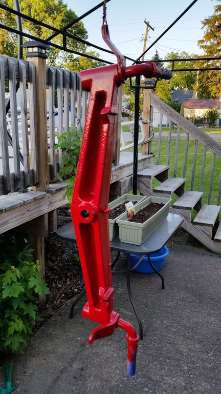

Tgtack 780 #24 Posted June 10, 2017 Been hard at it last couple days, finally got the frame and transaxle mated back together, marathon painting day today. For some reason the picture reminds me of the barn in Twister. Got to sand blast engine tins in the morning so can get them painted along with the fuel tank. Big issue right now is finding reasonable priced bolting hardware, ACE is through the roof for stainless or yellow zinc grade 5. Also no luck on a body shop, all booked up, will have to paint the hood and fenders myself. Need to order some parts from Glenn as well. 1 Share this post Link to post Share on other sites
