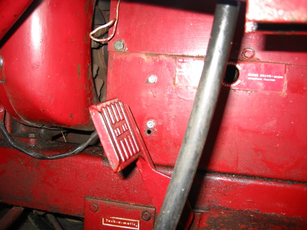

pfrederi 20,681 #2 Posted June 1, 2017 open the tow valve one turn (in the hole with the decal next to it left side of tractor) then try to push the tractor forwards and backwards...Does it stop after one turn or can you push it a distance. if it stops do not force it. A differential bolt may have broken and is getting wedged between the differential and the tranny case . If you force it too hard it can crack the case. Share this post Link to post Share on other sites

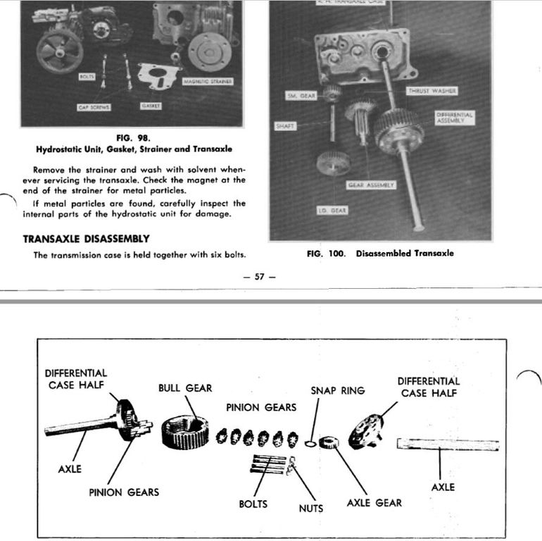

pacer 3,180 #7 Posted June 1, 2017 (edited) OK, I'll try and describe what is likely the problem. Wheel Horse made a design booboo on the differential in the earlier D series, they used grade 5 bolts (to soft/weak, 4 of them) in the diff and if/when one breaks it drops down into the bottom of the case and as the gear rotates around it strikes the broken piece, stopping it. Sometimes (often?) it will bust the differential case/housing and oil will pour out (this happened to me) I see I'm late responding -- as usual Edited June 1, 2017 by pacer Share this post Link to post Share on other sites

pfrederi 20,681 #9 Posted June 1, 2017 This is not an afternoon in the driveway repair project...but nothing to be afraid of either. There are several of us here who have done this and lots of help here. He will have to rig up some kind of dolly to put under the rear end to get the wheel off the ground so he can move it to where he wants to work on it. it is important not to force the unit as breaking the tranny case is a real possibility. You may have to download the manula here and print it out for him. it gives a good sescrpition of what has to be done to get into the transaxle. Probable the hardest part can be getting the hubs off the axles. There are thread here about that also The culprits are probably the four bolts in the picture. I replaced mine with Grade 9 bolts and nuts Share this post Link to post Share on other sites

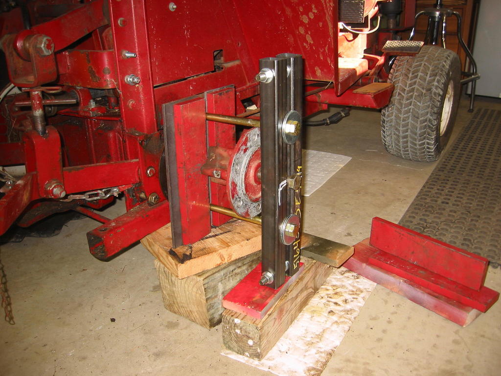

pacer 3,180 #13 Posted June 1, 2017 1 hour ago, pfrederi said: Then you have to pull the hubs which can be very difficult. I feel I should stress the pulling of the hubs possibly being difficult! These boogers can really be a problem. You would be wise to make up a puller similar to paul f or at least one to pull on all 6 of the bolt holes. A 3 leg/jaw puller is all too prone to break the hub - cast iron is somewhat brittle. Share this post Link to post Share on other sites

pfrederi 20,681 #16 Posted June 2, 2017 This is the parts manual for the tractor so you can see the parts involved. As long as you are in there I would strongly recommend you replace the axle and brake shaft seals. Also take a close look at the parking brake, many have been used to stop the tractor which grinds them down. Share this post Link to post Share on other sites
