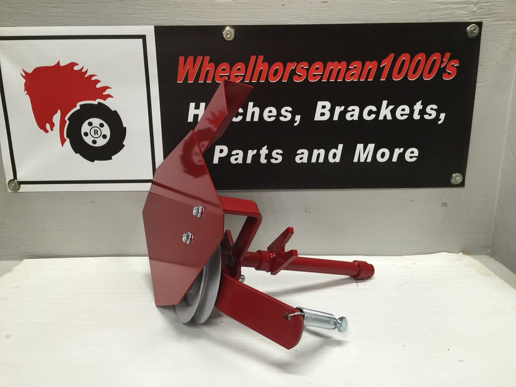

wheelhorseman 3,256 #4 Posted May 31, 2017 Which tiller belt tensioner do you have? Is it like this ???? Share this post Link to post Share on other sites
Duramax7man7 506 #5 Posted May 31, 2017 No. It's the one with a 90 degree bracket Share this post Link to post Share on other sites
