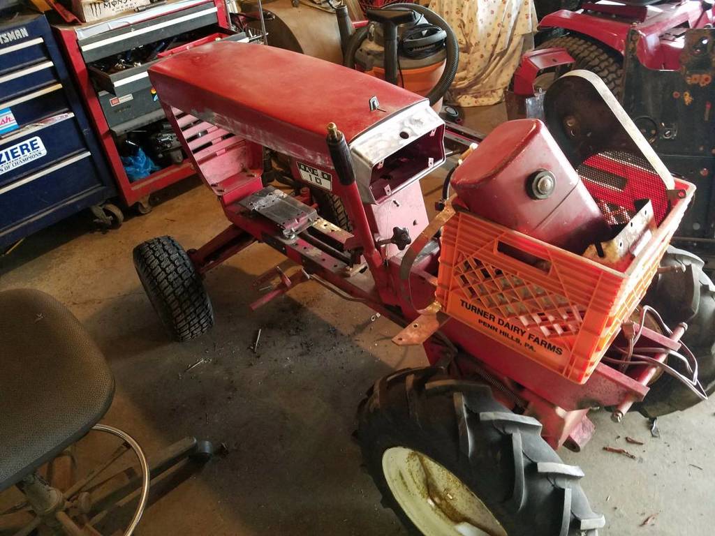

Tgtack 779 #1 Posted May 31, 2017 (edited) I guess I now "officially" own a 1968 Raider 9/10 (some had "9" and some had "10" decals?), while digging through the boxes of piece parts, I found the ID tag for it. Since I have the tag, it moved from parts donor to future restore. It will take some work, the head stand has major stress cracks, and is missing the lower mounting plate on the left side (broken off). The original engine is in a box of parts, and the solid state ignition is shot. No steering wheel, no seat, none of the dash components. Broken hub welded to the left rear axle 😡. Does have fully functioning 6 speed transaxle, decent fender pan with the correct tail light, original dash panel plate, best fitting hood I have seen yet, 0 play front axle and steering gear, and what appears to be the complete speed attachment plates and bell crank assembly for a 1968 42"SD deck (no deck). So, Model # 1-6931, Serial # 466813 (decal marked as a Raider 10) is back from the dead. As a side note, I bought this whole collection of parts (mix of Raider 10 and Commando 8 stuff and three engines, for $150 primarily for the set of vintage General Tire AG tires in the picture for my 854 restore. Edited May 31, 2017 by Tgtack 6 Share this post Link to post Share on other sites

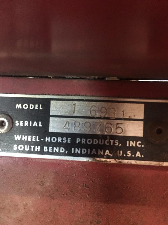

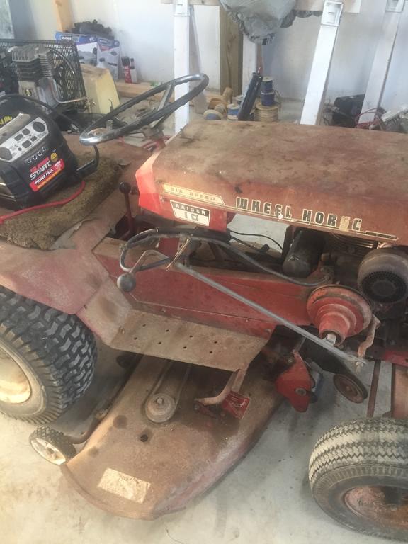

Kyle6294 3 #2 Posted May 31, 2018 Hello, I’m new to this forum, and new to wheel horses. I recently purchased a barn that had a wheel horse raider 10 in it, or that’s what the decal says. I looked up the model number (16931) serial (489765), and is says it’s a raider 9. Has a tecumsch motor. Needed a head gasket and throttle cable to make it run, we made the repairs and it seems to run like a top. I still need to get a belt from motor to deck. I am curious what it’s worth? I don’t really have the space or need for it. Also missing battery, I have been using a jump pack to start it. 1 Share this post Link to post Share on other sites
953 nut 66,569 #3 Posted May 31, 2018 10 hours ago, Kyle6294 said: . I am curious what it’s worth? A running with a deck should fetch $ 250 or a bit more in the condition shown. If you pit a battery in it and begin using it you will fall in love with it and never want to sell it! Share this post Link to post Share on other sites
Kyle6294 3 #4 Posted May 31, 2018 Thanks, the more I’ve checkout out this forum I think I’ll be keeping it for a project with the kids. 1 1 Share this post Link to post Share on other sites
carter.norbisrath 6 #5 Posted June 2, 2018 I have a Raider 10 identical to this. I can’t find any decals that look like these ones for a raider 10. I can find them for a raider 9 with the same hood decals, but not a raider ten. Share this post Link to post Share on other sites

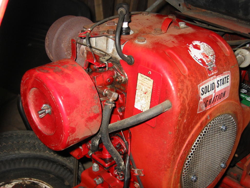

pfrederi 20,659 #14 Posted September 7, 2019 Some raider 10s came with HH100 like this one. As far as the horsepower Techy labelled engines HH60 6hp HH80 8 Hp HH100 10 hp There was no HH90. I have a feeling the 9hp rating by WH was more of a marketing thing than an actual engineering statement. 1 Share this post Link to post Share on other sites
oldredrider 2,553 #15 Posted September 7, 2019 My guess on the Raider 9 was that the Teccy was rated at about 9.6 HP, couldn't qualify as a "10". Honesty was a policy back then.......... Share this post Link to post Share on other sites
