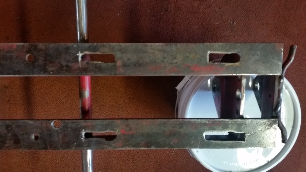

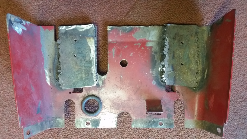

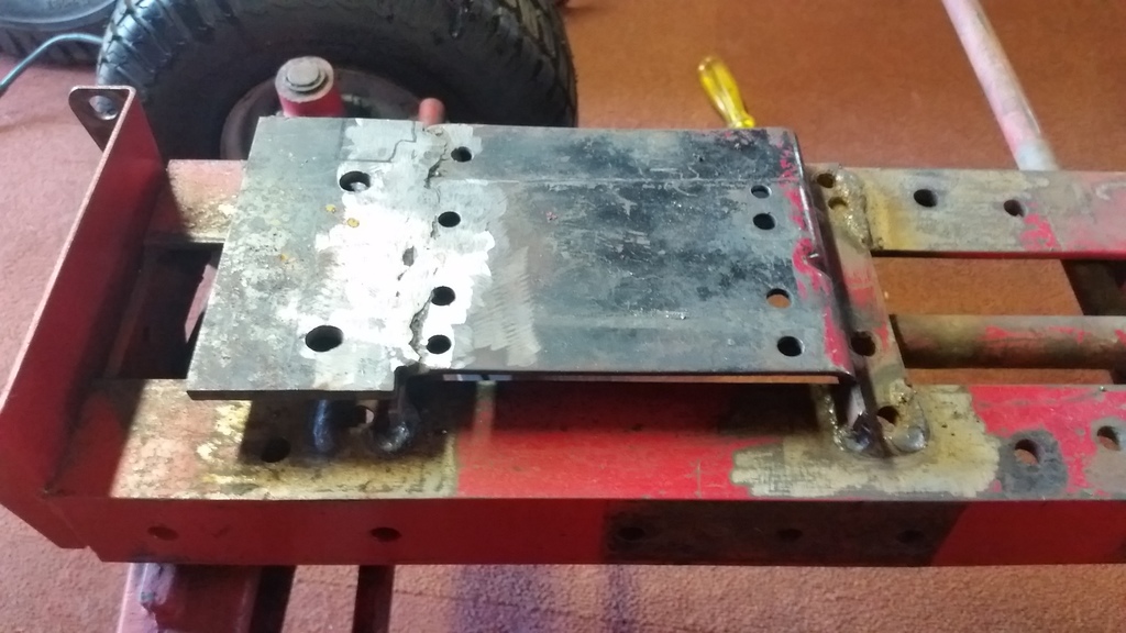

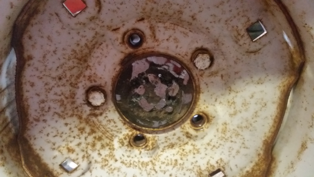

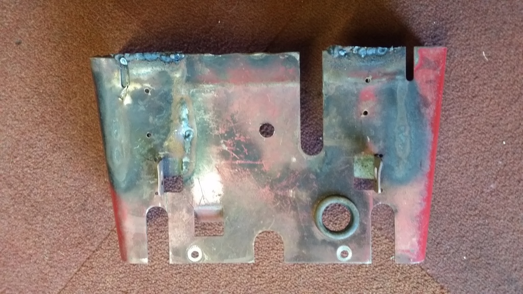

Tgtack 779 #1 Posted May 30, 2017 Sometimes, one really wonders "why" would someone do that? Here are some recent examples, let's see yours! 1 & 2, let's add plates inside the head stand gas tank mount, for no apprent reason! 3, let's drill holes in the frame for a motormount, don't use them, and weld it down instead! 4, not quite sure where the motor mount holes should be, so let's just cut slots in the frame! 5 & 6, dang it, I hate throwing away that broken wheel hub, let's just weld it to the end of the axle (who cares if it is straight)! 10 Share this post Link to post Share on other sites
slammer302 2,157 #2 Posted May 30, 2017 I had a work horse gt 1642 that someone welded the hub's and they really burned the weld in good and it leaked from the trans seals super bad but I would of had to hack it up to fix. I think I could do a two page post on the wheel horse abuse I've seen during my wheel horse buying adventures. 1 Share this post Link to post Share on other sites

Tankman 3,528 #10 Posted May 30, 2017 That poor Stallion! What was one thinking? Beautiful welds too. 1 Share this post Link to post Share on other sites

Tgtack 779 #12 Posted May 31, 2017 57 minutes ago, Tankman said: That poor Stallion! What was one thinking? Beautiful welds too. I plan on saving the Comando frame, will put in a thin backer piece and weld up the slots and grind it back flush. It's head stand is another story, it has serious stress cracks, and one side that bolts to the frame is broken off and missing. Even the fender pan is messed up, someone cut a huge rectangular section out of the middle where the seat mounts. Both of them had the nicest front axles and pivot pins I have seen. One of them is going to replace the seriously worn out axle on my 1276. There was a lot wrong with them, but they do have some nice pieces. The Raider has one of the tightest fitting straight hoods I have seen so far. Too bad it has the headlight cutout, or it would be going on my 1276. The steering shaft and fan gear on the Commando had very little play as well. Unfortunately, neither tractor had their serial ID plates (that I have found yet), and the solid state ignition on the 10hp Tecumseh is toast. The main reason I bought all the parts, was for an extremely nice pair of vintage General Tire "All Grip Traction" AG tires that will eventually wind up on my 854. Share this post Link to post Share on other sites

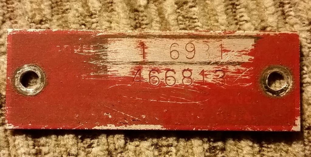

Tgtack 779 #18 Posted May 31, 2017 While I was digging through the boxes of piece parts last night, this is what I came across. The ID plate for a Model 1-6931, Serial #466813, which is a 1968 Raider 9 (odd because they had a 10hp Tecumseh and some they had either Raider 9 or Raider 10 decals). So, I guess this means that I am obligated to do a restore for this one since it made it into my possesion. So, once I finish the repair on the other frame to use for it, it will stand in the corner until my 854 is finished this fall. Now I guess I am going to have to rebuild that Tecumseh! I also did find what appears to be the complete speed attachment plates AND the complete bell crank assembly used for the belt drive to the 42"SD deck for that year. 2 Share this post Link to post Share on other sites
