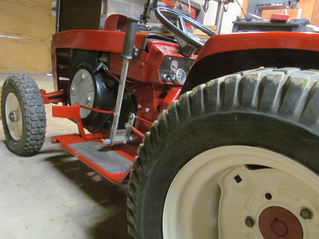

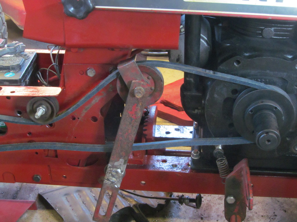

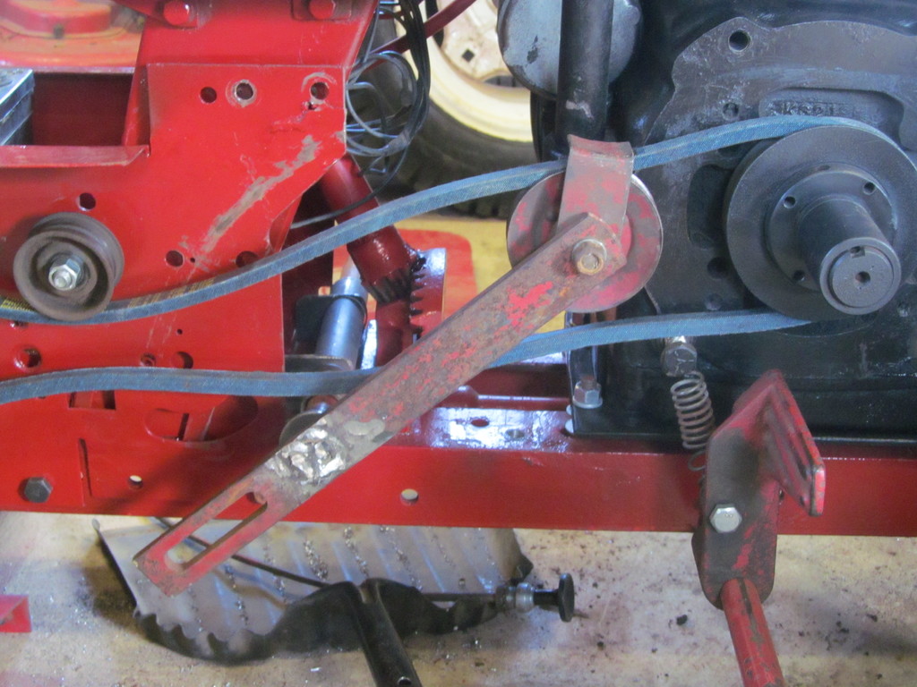

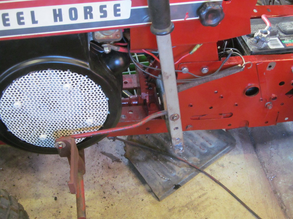

Tgtack 780 #12 Posted May 29, 2017 (edited) 4 hours ago, 19richie66 said: would you be able to somehow put a pedal on the right side and run a spring loaded cable to the idler pulley lever? just thinking out loud. Okay, I think I got this. So I am sitting here in my chair pulling apart the Raider 10 that came in my parts lot the other day. So I have it down to the frame, and I am sitting there staring at the pedal and the brake/clutch linkage and the brain goes into analysis mode. One thing God blessed me with, is the ability to see mechanical objects in X, Y, and Z planes in my head. So this is what I came up with, using probably 85% or more WH parts. Using the left side pedal, flip it around and shorten the tube so it fits between the stirrup and the PTO pedal on the right side. Cut off the lever, and rotate it to the bottom and re-attach it. I may have to modify the angle of the pedal some to clear the PTO pedal. Then, either open up the frame hole which is just behind the fan gear location, or weld in a new tube across the frame just below. Use a drive belt tension pulley lever/rod cut down to the correct lever length pointing down on the right side, inserting the rod through the new tube. Take a long brake/clutch accuating rod and cut it down to fit between the pedal lever and the new transfer lever/rod. Then using another short cast lever that the brake lining accuating rod attaches to, attach it pointing up on the left side. Then using the remainder of the actuating rod previously shortened, attach a rod between the new left side transfer lever and the existing brake/clutch lever. So, when you would depress the right pedal, the lever being under the pedal, it would transfer the motion rearward. This would rotate the new traverse rod and corresponding rotation to the left side. With the lever on top of the transfer rod on the left side, the rotation is forward so it pulls on the left side brake/clutch rod and functions as originally designed! I will draw up a sketch when I get time, but this should do the trick and look all original to boot! Edited May 29, 2017 by Tgtack 7 Share this post Link to post Share on other sites

953 nut 70,340 #16 Posted May 29, 2017 35 minutes ago, Tgtack said: Using the left side pedal, flip it around and shorten the tube so it fits between the stirrup and the PTO pedal on the right side. Cut off the lever, and rotate it to the bottom and re-attach it. I may have to modify the angle of the pedal some to clear the PTO pedal. May be better to make a new brake / clutch peddle, but the concept you have come up with would work well. 13 minutes ago, wallfish said: try to refrain from any more jokes. Please don't!......., The levity on this site is at least half the value of coming here. 3 Share this post Link to post Share on other sites
wallfish 20,733 #17 Posted May 29, 2017 (edited) 1 hour ago, Tgtack said: Okay, I think I got this. So I am sitting here in my chair pulling apart the Raider 10 that came in my parts lot the other day. So I have it down to the frame, and I am sitting there staring at the pedal and the brake/clutch linkage and the brain goes into analysis mode. One thing God blessed me with, is the ability to see mechanical objects in X, Y, and Z planes in my head. So this is what I came up with, using probably 85% or more WH parts. Using the left side pedal, flip it around and shorten the tube so it fits between the stirrup and the PTO pedal on the right side. Cut off the lever, and rotate it to the bottom and re-attach it. I may have to modify the angle of the pedal some to clear the PTO pedal. Then, either open up the frame hole which is just behind the fan gear location, or weld in a new tube across the frame just below. Use a drive belt tension pulley lever/rod cut down to the correct lever length pointing down on the right side, inserting the rod through the new tube. Take a long brake/clutch accuating rod and cut it down to fit between the pedal lever and the new transfer lever/rod. Then using another short cast lever that the brake lining accuating rod attaches to, attach it pointing up on the left side. Then using the remainder of the actuating rod previously shortened, attach a rod between the new left side transfer lever and the existing brake/clutch lever. So, when you would depress the right pedal, the lever being under the pedal, it would transfer the motion rearward. This would rotate the new traverse rod and corresponding rotation to the left side. With the lever on top of the transfer rod on the left side, the rotation is forward so it pulls on the left side brake/clutch rod and functions as originally designed! I will draw up a sketch when I get time, but this should do the trick and look all original to boot! I had to read it twice but get what you're saying now. Basically transferring motion from a new right side modified pedal ( changing pull of a rod to a push on the rod) to a new lever system in order to cross sides of the frame, which then connects to the arm in which the original pedal connects to now. That should work! I'll be keeping an eye out at the show ED, when I least expect it, expect it! I guess you do owe me one for that. Edited May 30, 2017 by wallfish 5 Share this post Link to post Share on other sites
