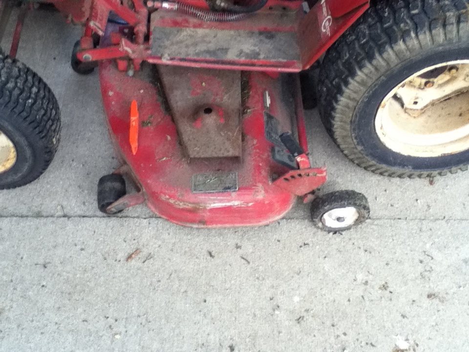

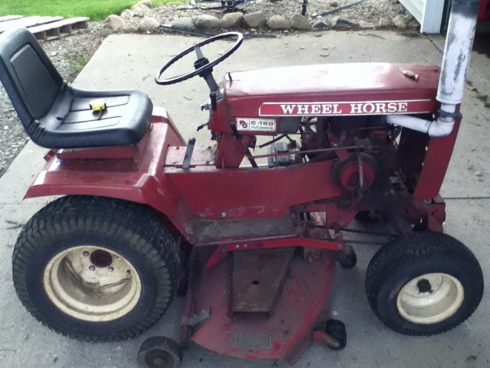

Adams94 1,071 #1 Posted May 28, 2017 I have always mowed on the second notch from the top on any wheel horse deck, but on this deck it is lower than id like and the next notch is to high, is there an adjustment? Share this post Link to post Share on other sites
slammer302 2,157 #2 Posted May 28, 2017 Their maybe a adjustment that i'm not thinking of but the first thing i would try is getting a good set of deck wheels sense this is what the deck rides on if their not right the cut will be off. 3 Share this post Link to post Share on other sites
oldredrider 2,553 #3 Posted May 28, 2017 Using the proper deck wheels might help with your dilemma. 1 Share this post Link to post Share on other sites

Adams94 1,071 #5 Posted May 29, 2017 Are either of the wheels correct? Share this post Link to post Share on other sites
gwest_ca-(File Mod) 12,460 #6 Posted May 29, 2017 108522 and 109037 wheels have been replaced by 110506 and seem to be available from many sources. They are 6" diameter x 1.75" (1-3/4") wide. Garry 1 Share this post Link to post Share on other sites
