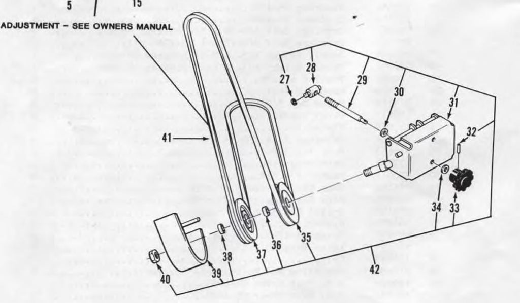

Joe Ziebert 0 #1 Posted May 28, 2017 I recently replaced one of the pulleys on the belt adjusted. Now when i engage the blades they are now getting hot.is there a spacer that goes between the two pulleys. Share this post Link to post Share on other sites
pfrederi 21,306 #2 Posted May 28, 2017 Over the years WH used various deck drives. Would be helpful if you provided a model number. The most commonly used mule drive did have a spacer. Did yours look like this. 1 Share this post Link to post Share on other sites
