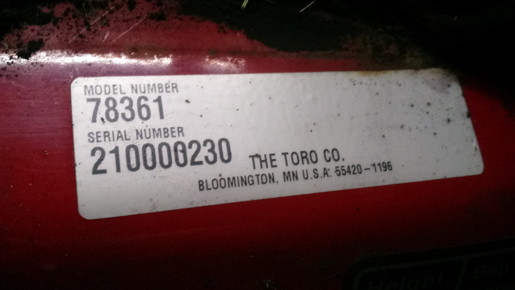

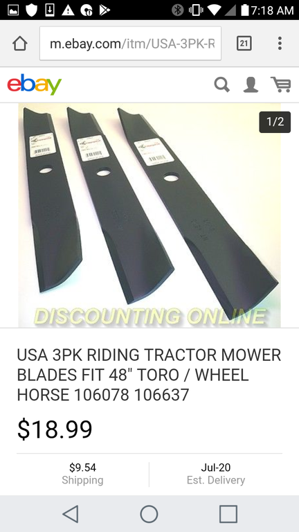

Mt Zion 520H 43 #1 Posted May 26, 2017 Where's the best place to buy and cheaper price wise? Do i need to go by a specific model number or anything? No idea what i need to look for.. Any help appreciated. Also.. Read that front should be 1/8" lower than front. Does this need adjusting again if changing height from slot to slot of does it remian constant and only need done once? Share this post Link to post Share on other sites
woodchuckfarmer 333 #2 Posted May 26, 2017 Blades on the big bay. Copperhead ,3 blade set for a 48 inch deck. 29.95. Just got a set last week. Made in USA. Wayne Share this post Link to post Share on other sites
Jerry77 1,218 #3 Posted May 26, 2017 4 hours ago, Mt Zion 520H said: only need done once Correct. 1 Share this post Link to post Share on other sites
Aldon 4,833 #4 Posted May 26, 2017 Just make sure the deck blades don't have D type holes to mount. otherwise blade length is limiting factor... Share this post Link to post Share on other sites
Mt Zion 520H 43 #5 Posted May 27, 2017 16 hours ago, woodchuckfarmer said: Blades on the big bay. Copperhead ,3 blade set for a 48 inch deck. 29.95. Just got a set last week. Made in USA. Wayne Got a link perhaps? Can't seem to find them. Maybe i'm just stressed with other things going on. 16 hours ago, Jerry77 said: Correct. Thanks much brother. Seems after lifting 1 notch.. Mine seems off quite a bit so will need to correct that asap. Hadn't looked before because figured guy i got it from knew things and would have it right. Oh well. 14 hours ago, Aldon said: Just make sure the deck blades don't have D type holes to mount. otherwise blade length is limiting factor... Ok, will check on this too before ordering. Ty. Share this post Link to post Share on other sites
Jerry77 1,218 #6 Posted May 27, 2017 (edited) 1 hour ago, Mt Zion 520H said: Got a link perhaps Go here - lots of links - chk the numbers b4 you buy...on ebay - wheel horse 48 inch deck mower blades Edited May 27, 2017 by Jerry77 clarification Share this post Link to post Share on other sites

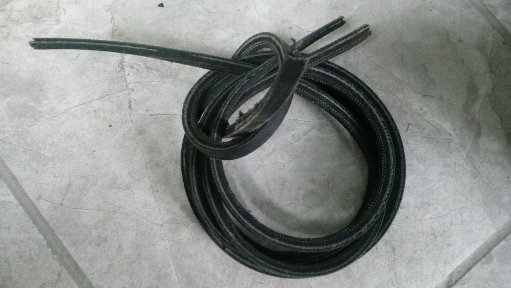

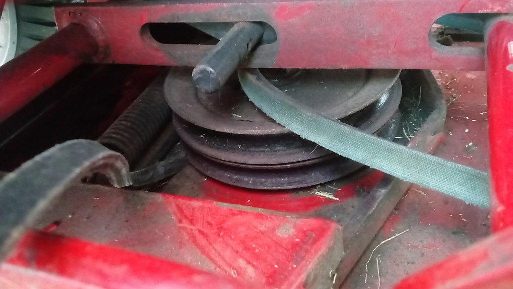

Mt Zion 520H 43 #7 Posted July 15, 2017 Haven't ordered yet.. Been side tracked a lot and still using dull blades. Grr.. Er.. Also going to need a skinny belt that connects the 3 blades to eachother as it snapped and then somehow the bigger belt dislocated from the center blades pulley. Smh. Share this post Link to post Share on other sites
gwest_ca-(File Mod) 12,511 #8 Posted July 15, 2017 Garry Share this post Link to post Share on other sites
Mt Zion 520H 43 #9 Posted July 15, 2017 7 hours ago, gwest_ca said: Garry Is that the part number for the belt that connects the 3 blades? Share this post Link to post Share on other sites

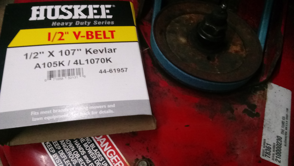

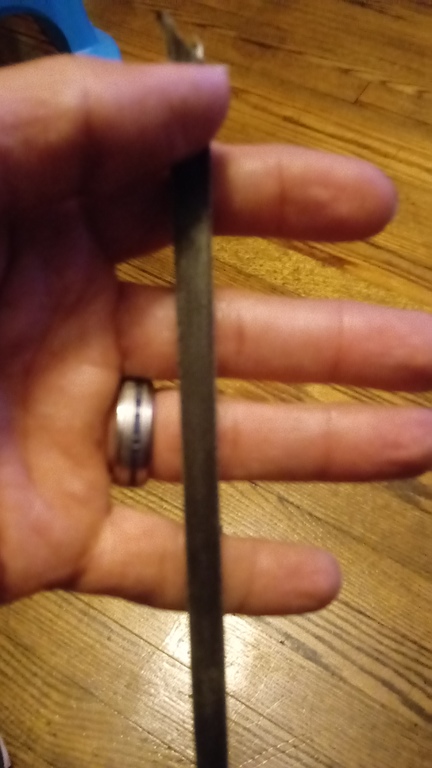

Mt Zion 520H 43 #10 Posted July 15, 2017 (edited) Need belt asap so ordering is a route i'd like to avoid. Maybe tractor suply has a belt that would work? What size / length do i need? This one got cut up and think maybe a pc missing so can't go by it's length. Any help appreciated. Edited July 15, 2017 by Mt Zion 520H Add pic Share this post Link to post Share on other sites
gwest_ca-(File Mod) 12,511 #11 Posted July 16, 2017 The belt numbers and dimensions are on this page Garry Share this post Link to post Share on other sites
Mt Zion 520H 43 #12 Posted July 16, 2017 (edited) 21 minutes ago, gwest_ca said: The belt numbers and dimensions are on this page Garry Okay.. Is it possible the belt in there was the wrong size? It's a 1/4" belt that connected the spindles and the link you gave says 1/2" belts.. Edited July 16, 2017 by Mt Zion 520H Add pic Share this post Link to post Share on other sites
Mt Zion 520H 43 #13 Posted July 16, 2017 Picked up a belt from tractor supply.. Let's see how it works out. Not sure why previous owner put tbe 1/4" belt there.. Weird.. But it's corrected now. Share this post Link to post Share on other sites

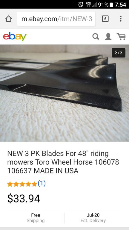

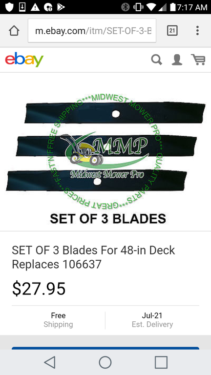

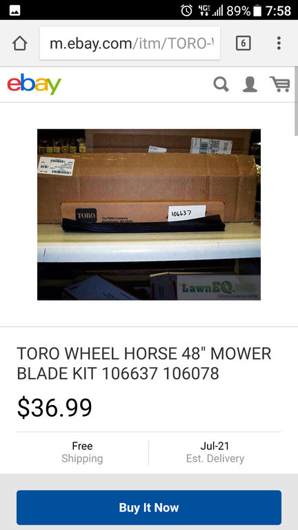

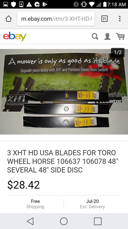

Mt Zion 520H 43 #14 Posted July 17, 2017 (edited) So i found the oem toro blades on amazon for 35-46 bucks.. And i found 3 brands of blades on ebay... XHT brand clains to be best on market because it's made with MARBAIN and are harder and hold sharpness longer... Anyone have experience with them? I think i read elsewhere they tend to shadder if they fit something hard enough.. Not sure if should be concerned as there are times i hit harder than grass obejects.. Like rocks. Lol. Edited July 17, 2017 by Mt Zion 520H Add Share this post Link to post Share on other sites
WVHillbilly520H 10,379 #15 Posted July 17, 2017 (edited) I have been using the STENS (bottom pic) brand lately and they're ok and have held up to gravel and a rock here and there, beware of the cheaper versions, but the TORO hold up the longest from my experience since 1998, Jeff. Edited July 17, 2017 by WVHillbilly520H Share this post Link to post Share on other sites
Mt Zion 520H 43 #16 Posted July 17, 2017 8 minutes ago, WVHillbilly520H said: I have been using the STENS (bottom pic) brand lately and they're ok and have held up to gravel and a rock here and there, beware of the cheaper versions, but the TORO hold up the longest from my experience since 1998, Jeff. Thank you brother; for info and pics. Much appreciated. 1 Share this post Link to post Share on other sites
