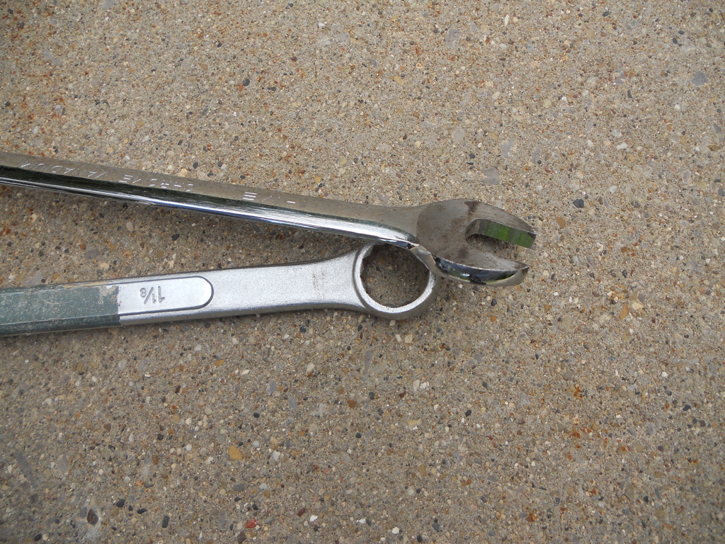

GlenPettit 1,719 #8 Posted May 26, 2017 Wheel Horse made a special wrench just for that, 11/8" with a thinner head to fit under the blade to hold the spindle while a second wrench loosens the nut. Here some for sale today on eBay under "Wheel Horse wrench": 2 Share this post Link to post Share on other sites
lynnmor 8,772 #9 Posted May 26, 2017 4 minutes ago, GlenPettit said: Wheel Horse made a special wrench just for that, 11/8" with a thinner head to fit under the blade to hold the spindle while a second wrench loosens the nut. Here some for sale today on eBay under "Wheel Horse wrench": I have one of those wrenches, it is made out of peanut butter. Useless for the intended purpose, it hangs on the wall as a collectors item. Buy a wrench at a yard sale and grind to fit. Share this post Link to post Share on other sites

pfrederi 20,367 #11 Posted May 26, 2017 For the thin wrench old blades are very tough steel they, will not bend . A hacksaw a file and some patience ... 10 Share this post Link to post Share on other sites
Racinbob 12,912 #12 Posted May 26, 2017 I went ahead and bought a quality wrench and had the open end milled down. The box end is a Reese from our RV days. No more skinned knuckles for me. For the smaller nuts like on the double D blades a chunk of 4x4 holds the blade well. 8 Share this post Link to post Share on other sites

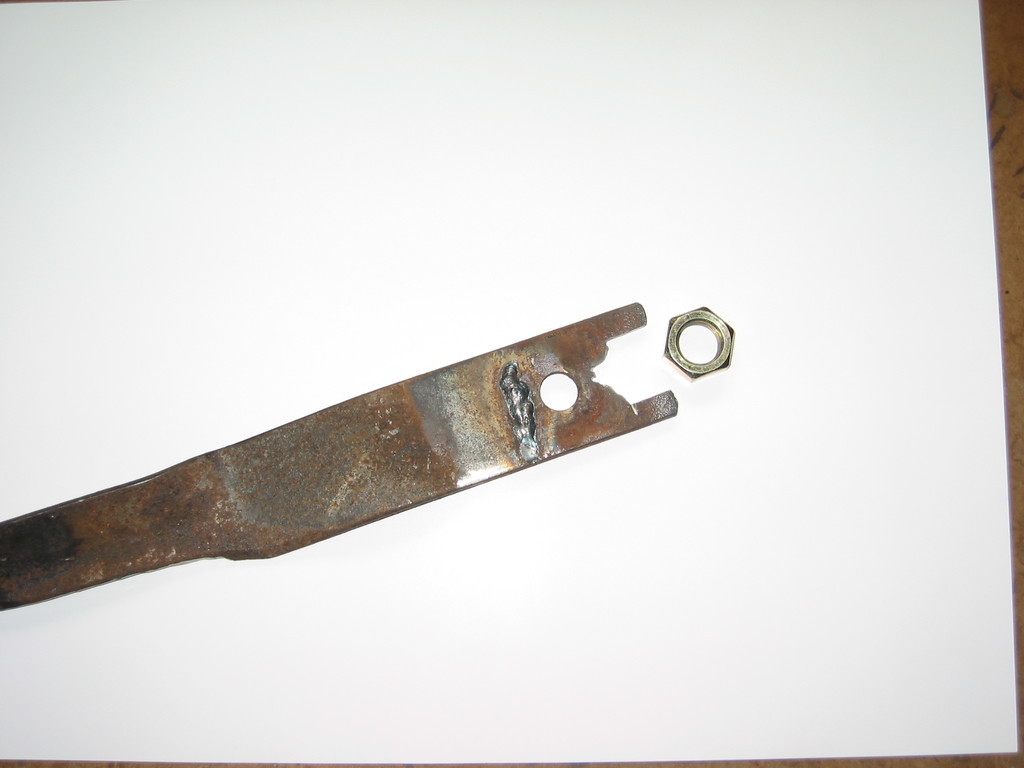

Duramax7man7 506 #16 Posted May 30, 2017 I agree on the Toro wrenches. I thought that I would be able to bust the nuts loose on a 42" SD and all that I did was bent that wrench apart so that it wouldn't grip at all. "Peanut butter"- LOL- basically yeah! I have cut a piece of 5/16 steel to reinforce the backside of the wrench and will be welding it to the wrench in hopes of a stronger tool. I'll post my results. 1 Share this post Link to post Share on other sites

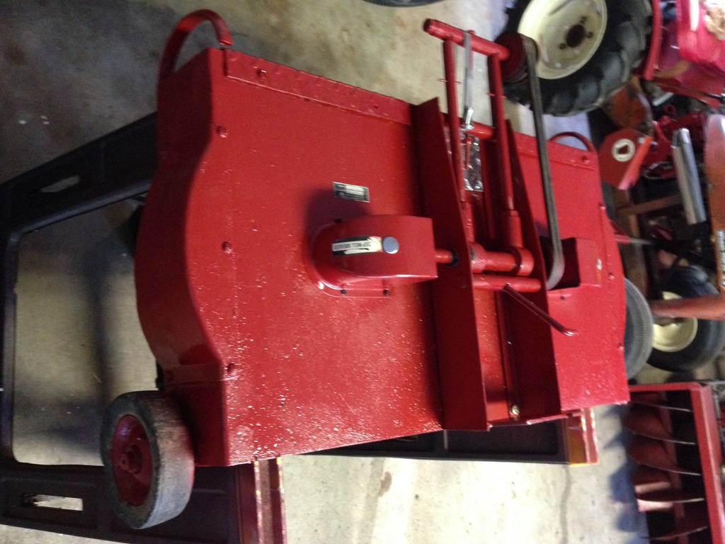

Duramax7man7 506 #19 Posted June 9, 2017 Here is the upgrade that I made to my "Wheel Horse Wrench"... The top is the section that kept getting torqued outwards. So I figured that would be the best place to weld this piece on especially considering that my more beefier wrenches this size had extra support in that area. 1 Share this post Link to post Share on other sites
