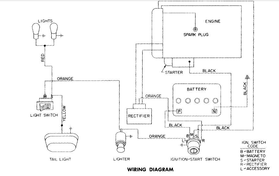

Racinbob 13,286 #2 Posted May 25, 2017 I don't have any pictures for you but this should help. 2 Share this post Link to post Share on other sites
pfrederi 21,306 #3 Posted May 25, 2017 HH 120 would be a Techy with Solid State (probably) would have to be wired like a Mag system. This is for a HH10 in a Charger. i would think it similar except teh C120 probably uses a solenoid instead of a heavy igntion switch 4 Share this post Link to post Share on other sites
Racinbob 13,286 #4 Posted May 25, 2017 Oops! Good catch Paul. Now I see that the wiring diagram in the linked manual is for a Kohler only. 1 Share this post Link to post Share on other sites

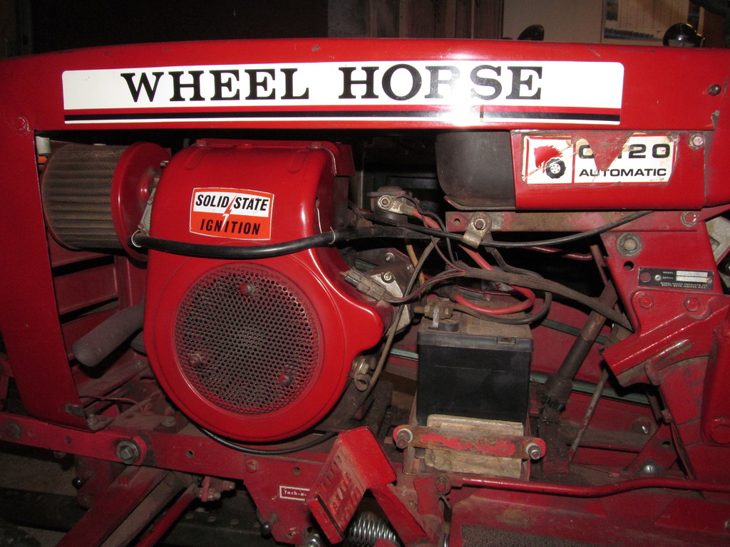

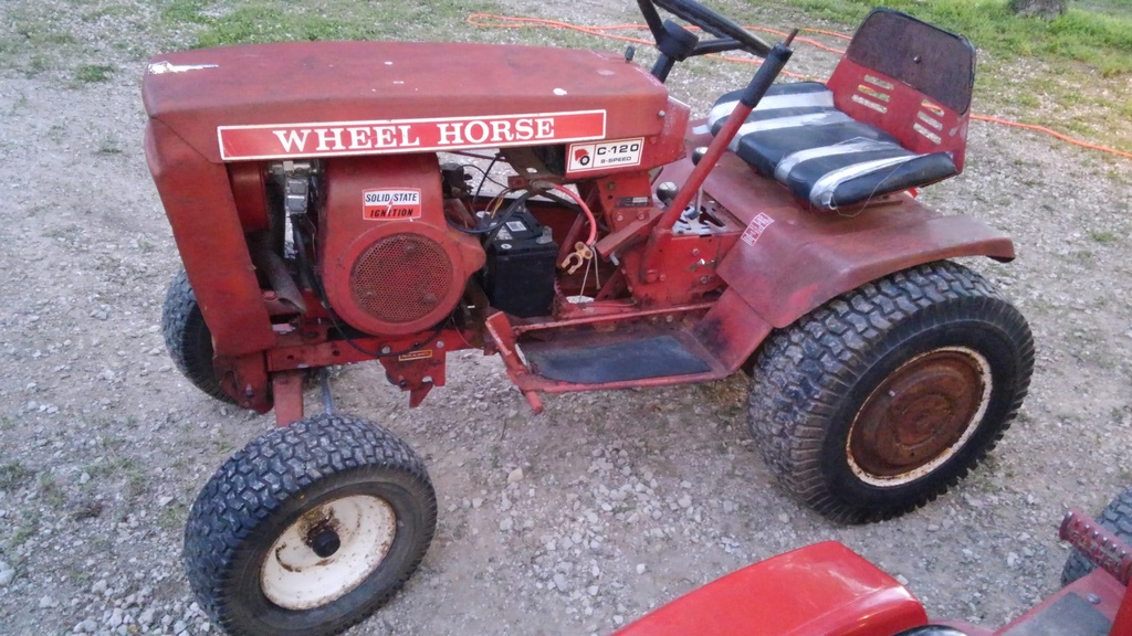

RandyLittrell 3,946 #5 Posted May 25, 2017 Thanks guys! I have downloaded every diagram and manual I could find on this tractor. The wiring isnt really too awful bad, just some loose wires hanging and would like pics so I can fix it and make it look as much as original as possible. Here is a pic of the tractor I am working on. 5 Share this post Link to post Share on other sites
Ed Kennell 47,818 #6 Posted May 25, 2017 I have that tractor....what area do you need? 6 Share this post Link to post Share on other sites
RandyLittrell 3,946 #7 Posted May 25, 2017 Ed, that pic helps right there but maybe a closer look at solenoid area, and I have no battery cables currently. Thanks so much. Randy Share this post Link to post Share on other sites

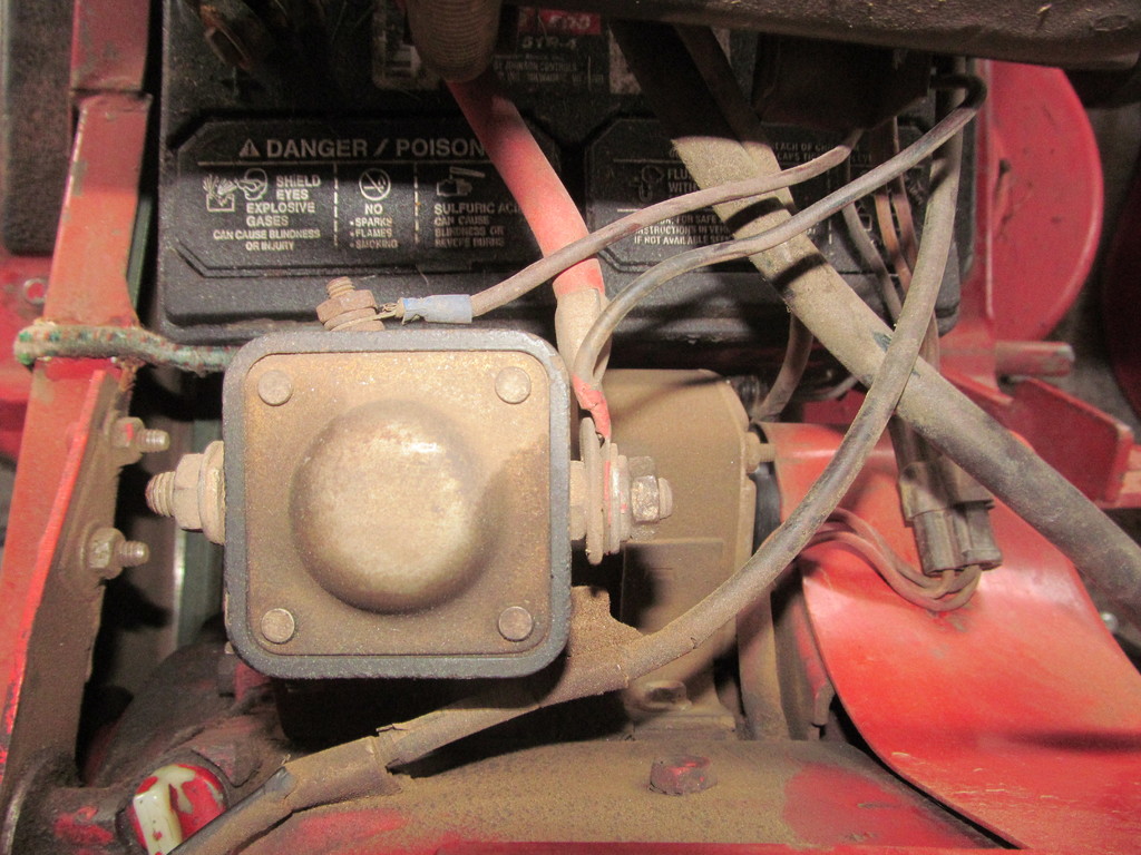

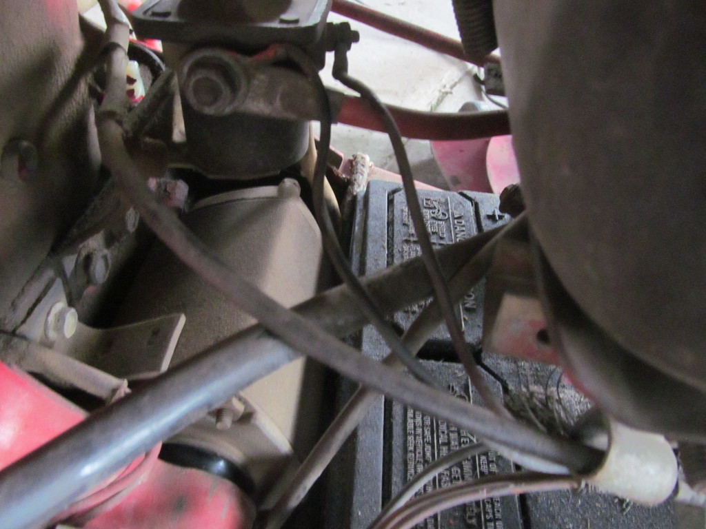

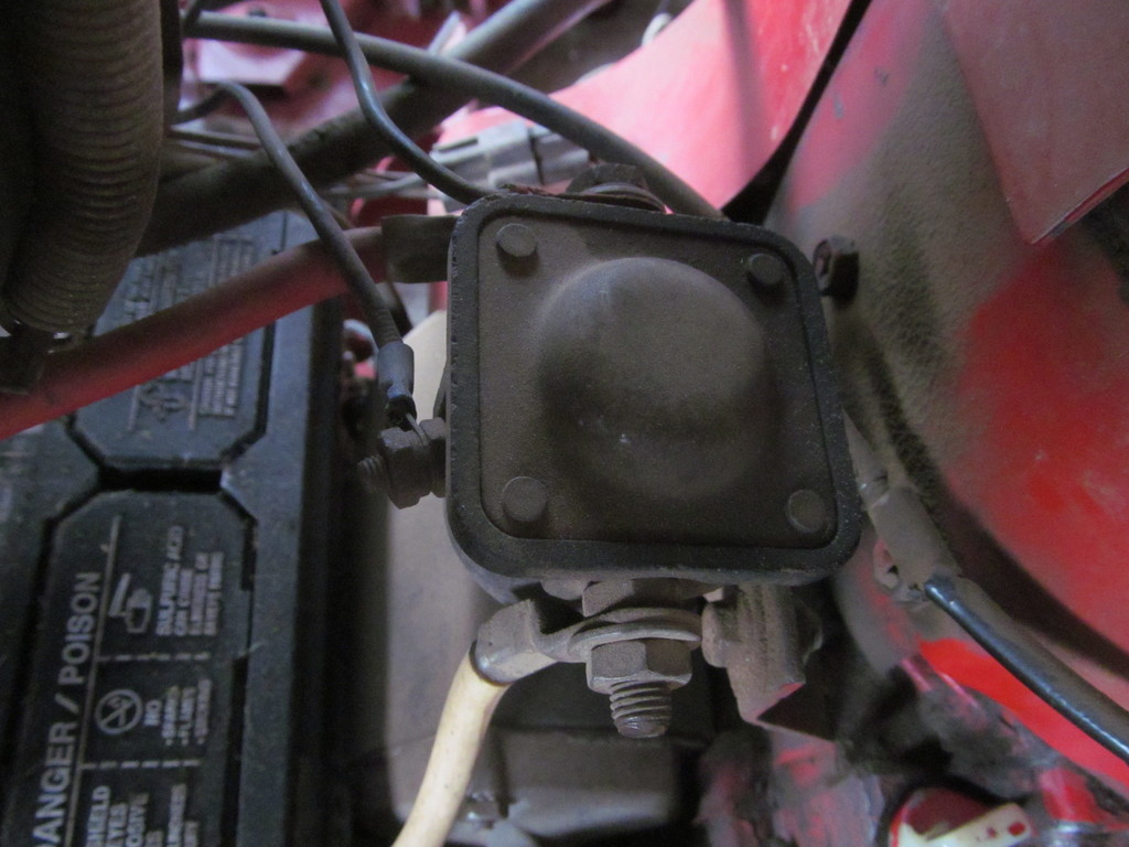

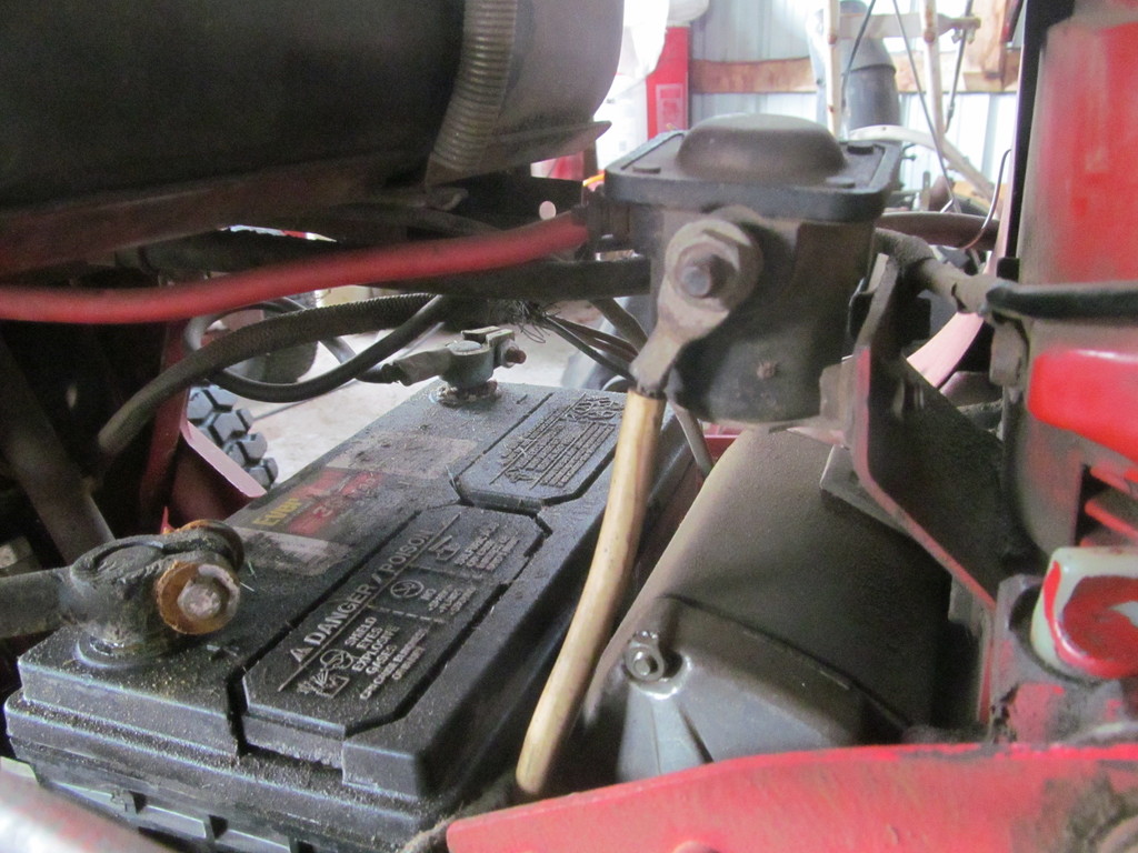

Ed Kennell 47,818 #8 Posted May 25, 2017 Here ya go. Try to ignore that fuel line, I know it's not routed correctly, but it works. 4 Share this post Link to post Share on other sites
RandyLittrell 3,946 #9 Posted May 25, 2017 Your the bomb ED!!!!!!! That will help me a lot! I currently don't have any wires hooked to the soleniod. I really appreciate it!! Randy 2 Share this post Link to post Share on other sites
