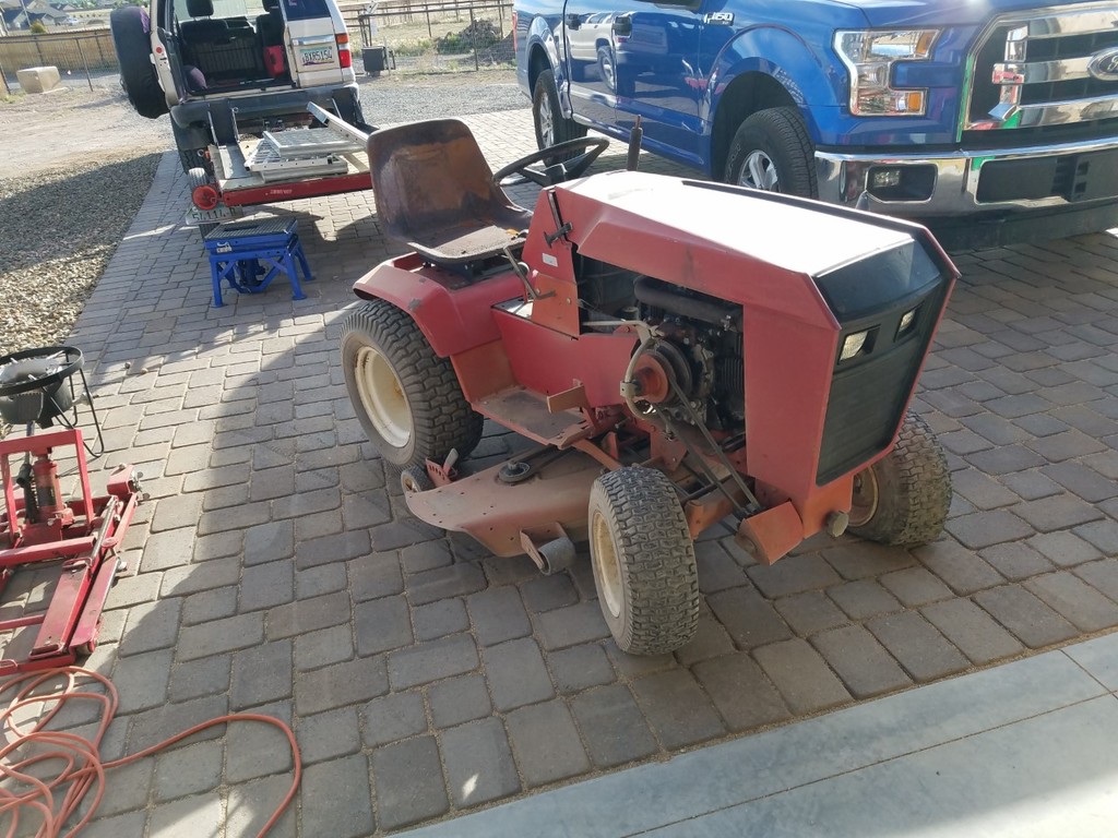

4play 0 #1 Posted May 23, 2017 I just purchased a running C-175 8 speed that needs some love. The ID tags are there on the deck & the chassis, but not legible. The 3 blade deck measures 40" blade tip to blade tip. I need a chassis and mower deck ID to reference for parts. Any idea's? This thing is burning a lot of oil but it pretty quiet. Will a set of rings usually cure the oil consumption? Share this post Link to post Share on other sites
gwest_ca-(File Mod) 12,533 #2 Posted May 23, 2017 Any info from the engine's data decal? Side or rear discharge deck? Garry Share this post Link to post Share on other sites
4play 0 #3 Posted May 23, 2017 Engine #12177848 Side discharge 42" deck Share this post Link to post Share on other sites
gwest_ca-(File Mod) 12,533 #4 Posted May 23, 2017 Kohler made serial number 12177848 in 1982 so the tractor should be a 1982 or 1983 model. 1982 tractor model 01-17K803 using Kohler Specification number 24200 (Should also be on the data decal) 1983 tractor model 11-17K801 using Kohler Specification number 24223 (Should also be on the data decal) Same OM (Operator manual) for 1983 This 42" side discharge deck was the model supplied 1981-1983 but older and newer are also a possibility. The blade center hole and the spindle bearings used may be the only way to positively ID it. Here are the 42" SD models in the order they were produced 5-1010, 5-1011, 5-1012, 65-42MS01, 65-42MS02, 75-42MS01 (Blades up to this point had a 5/8" x 3/4" double-D center hole) (The following decks used blades with a 3/4" center hole) 75-42MS02, 85-42MS01, 95-42MS00, 95-42MS01, 05-42MS01, 05-42MS02, 05-42MS03, 05-42MS04, 05-42MS05, 15-42SC01, 15-42SC02, 15-42SC03, 78345 This service manual includes maintenance Garry 1 Share this post Link to post Share on other sites
