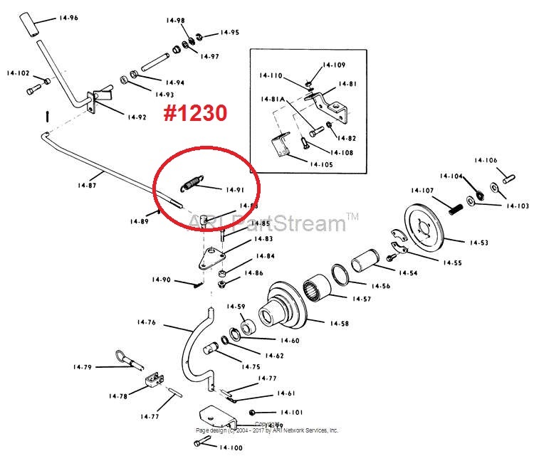

gwest_ca-(File Mod) 12,281 #3 Posted May 22, 2017 1230 pto spring Wire .040" or 1mm dia, Distance between hooks 1.750" or 44mm, Coil OD .350" or 9mm, Coil length 1.024" or 26mm, 24 coils @ 1.024" = .042667" wire diameter Garry 1 Share this post Link to post Share on other sites

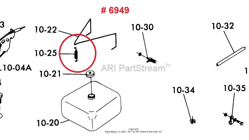

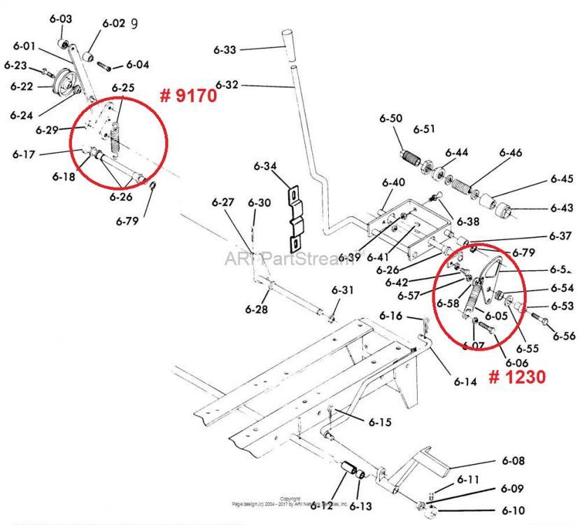

daveoman1966 3,883 #4 Posted May 22, 2017 One of them is in two schematics...here they all are listed. lets do this in regualr emails....outside of this forum. I am: daveoman@windstream.net 1 Share this post Link to post Share on other sites
Sarge 3,471 #5 Posted May 23, 2017 Just a note - when hunting springs , especially OEM ones - use the wire size/coil diameter/length overall to determine which one it is to best match what should be there if they are missing . It's tough when you don't have the correct/broken spring in hand to hunt a new one as those specs are unknown and not listed in any parts drawings/lists that I'm aware of . This is where the forum comes into play - you'll need someone to remove an existing spring off the same model to get those specs . Tape measure is fine for length/coil diameter but wire size requires a pair of calipers or a wire gauge , both of which are really good to have around when working on these tractors (as well as other things) . Putting the wrong spring in certain places will cause issues , such as the brake return centering spring , drawing #6-05 above or the belt tensioner spring #6-25 . You can do some investigation/experimenting with different sizes/wire gauge and get them close , but the OEM original parts are pretty high quality and engineered to work correctly , or at least that's been my experience . I spend spare time hunting the net and various sites with parts lists for every tractor I have to obtain NOS replacement parts stock to keep around - it's saved my butt more than once to be able to swap out a broken wear item quickly and get back to work . Just something to keep in mind , I don't trade/sell very often and tend to keep my various models for a very long time here . Sarge 1 Share this post Link to post Share on other sites
