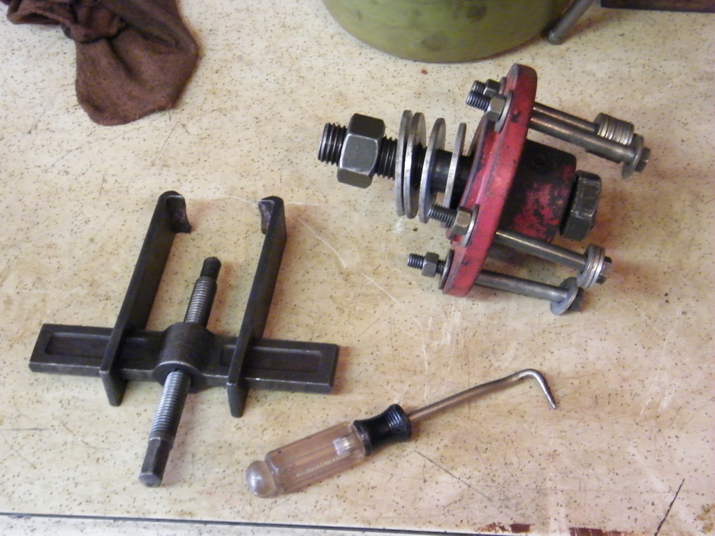

stevasaurus 23,816 #8 Posted May 28, 2017 I use what is called a carter key puller to pull out seals. Works great...the tool on the bottom left is a Craftsman. 1 Share this post Link to post Share on other sites
