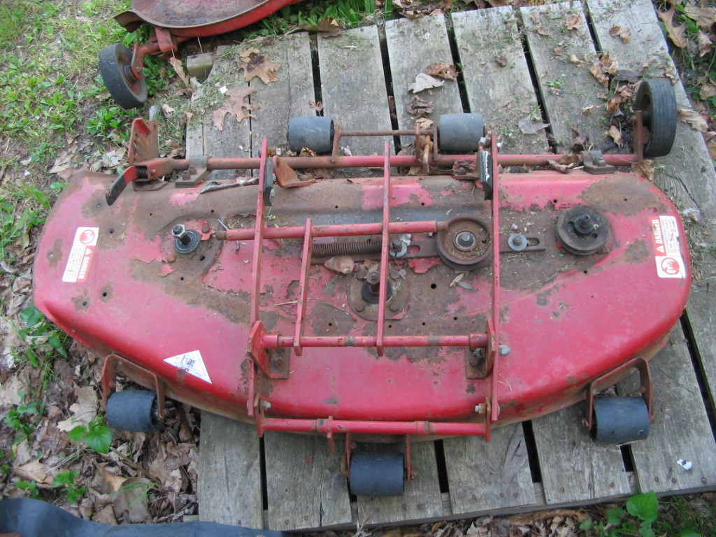

daveoman1966 3,884 #2 Posted May 21, 2017 (edited) your deck looks like this...right? with covers off... (no chute on this one). You will probably have to remove the outer spindle...the one you clipped... and HAMMER FLAT the four mounting holes in the deck. If the deck mount is just even 1/16" out of FLAT, the effect on the blade tip is exponentially out of alignment and the blade tips will meet. With spindle off, lay the shell surface flat on a BUG wood block and hammer the 4 mounting holes area back to where the area is FLAT. again.. Edited May 21, 2017 by daveoman1966 2 Share this post Link to post Share on other sites

tgranthamfd 29 #6 Posted May 21, 2017 8 hours ago, daveoman1966 said: your deck looks like this...right? with covers off... (no chute on this one). You will probably have to remove the outer spindle...the one you clipped... and HAMMER FLAT the four mounting holes in the deck. If the deck mount is just even 1/16" out of FLAT, the effect on the blade tip is exponentially out of alignment and the blade tips will meet. With spindle off, lay the shell surface flat on a BUG wood block and hammer the 4 mounting holes area back to where the area is FLAT. again.. Yes it has the cut outs where the spindle assembly mounts. I don't think the whole deck is sprung, I think II just have a slight bend in that cut out, over on the shoot side. Share this post Link to post Share on other sites
