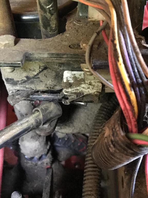

Russ2491 0 #1 Posted May 19, 2017 Hi new to forum so thank you in advance. I need help with my 312-H on some parts. Where the lever goes from the column for forward and reverse goes down and connects to the connecting rod that goes back to the transmission. It appears that a shear pin broke there??? The handle just goes forward and back and has no tension on it so I'm unable to go forward or back. Also I attached a picture of another part but I can't figure out the part number Share this post Link to post Share on other sites
gwest_ca-(File Mod) 12,533 #2 Posted May 19, 2017 Will guess you are looking at the neutral switch in Part 5, page 88, item number 8 but the one for the hydro models is not illustrated. A member with more knowledge on this model will likely chime in. The shift linkage is in Part 1 on page 18. An original parts list is better than the online lists because they identify what models use what. Shared manuals between different models can be confusing. Garry 1 Share this post Link to post Share on other sites
