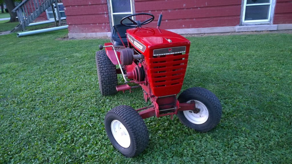

Stepney 2,356 #1 Posted May 17, 2017 Hello, all. Well, after some carb work, another flush on the tranny and engine, some valve adjustments and amongst other things a fresh coat of Penetrol, here she is! I've mowed 5 decent sized yards now, and so far it's doing very well! It burns about a quart of oil every two house, a rebuild will be in order here sooner or later. Now I just need to go through the generator, a idler pulley for the transmission belt, a few odds and ends, and we should be set! I can't believe I got this for 100.00, I only intended to get the thing for the deck, I had no intentions of even using the tractor. Well.. can't complain! I'm also pretty sure this might be original paint. I can't find any overspray or masking marks. 6 Share this post Link to post Share on other sites
Achto 32,925 #2 Posted May 17, 2017 Looks good! To keep the oil consumption down until you get to rebuild the engine. Try using a 50/50 mix of 30wt and Lucas oil treatment, this may slow down your oil consumption. Share this post Link to post Share on other sites
Stepney 2,356 #3 Posted May 17, 2017 Funny you mention that, that's exactly what I'm doing right now. Although a little less than 50-50, and I use.. I think it's Valvoline brand 20-50 due to the higher zinc content. 1 Share this post Link to post Share on other sites
KC9KAS 4,746 #4 Posted May 17, 2017 Nice tractor! Did all the 1077's have that riser on the bottom of the hood where it hinges? Share this post Link to post Share on other sites
Achto 32,925 #5 Posted May 17, 2017 2 hours ago, KC9KAS said: Nice tractor! Did all the 1077's have that riser on the bottom of the hood where it hinges? My 1076 has that riser too. I've noticed that the 8hp models do not have that riser. I think this was done to make room for the larger engines. 3 Share this post Link to post Share on other sites
