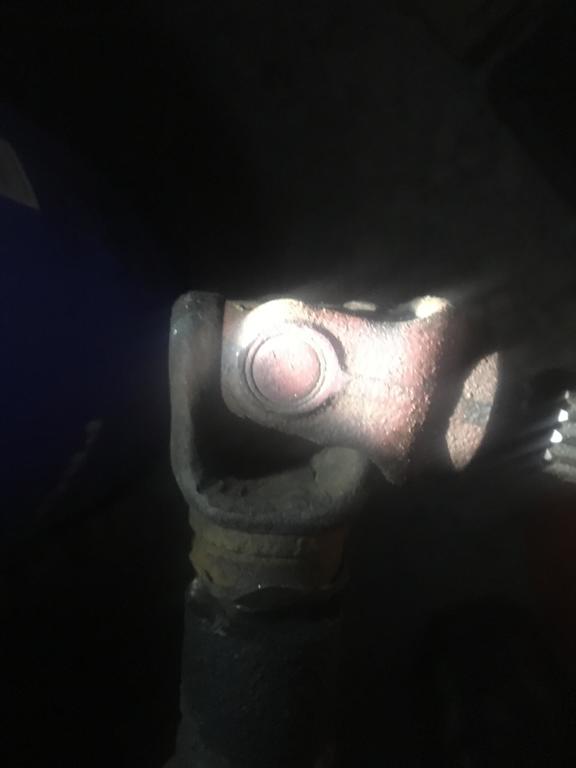

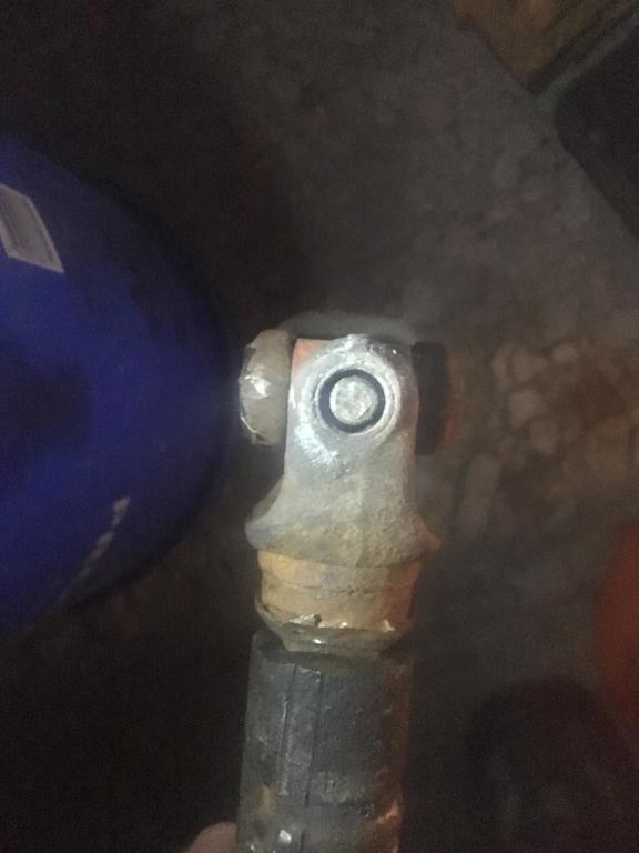

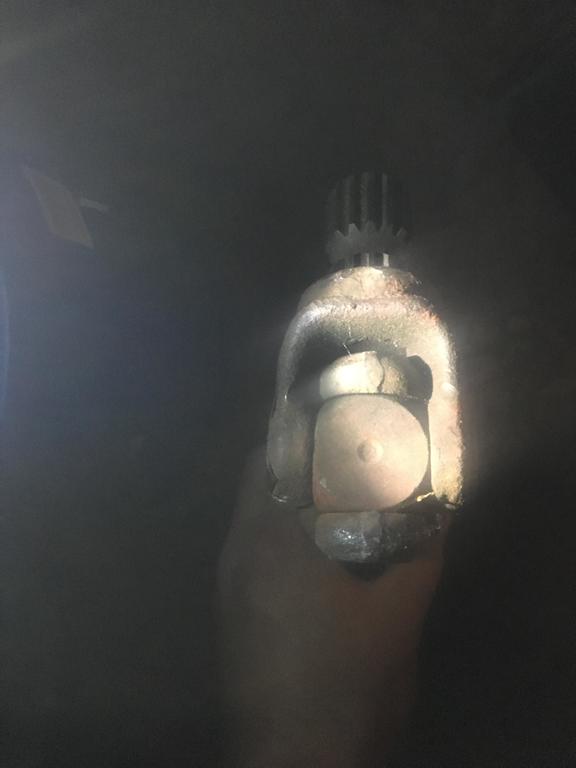

jjs342 1 #6 Posted May 20, 2017 Ok a few days late but this is what I'm working with. Share this post Link to post Share on other sites
gwest_ca-(File Mod) 12,511 #7 Posted May 20, 2017 I see what you are up against and I don't have an answer. Some original applications did not have snap rings. Instead a plastic material was injected into small holes in each eye. There was a groove machined around the center of the bearing cap which filled with plastic and that was how the cap was retained. At replacement time the plastic just sheared allowing the cap to be removed. The replacement joints came with snap rings. Perhaps you will see a groove in the eyes for an outside lock once the cap is removed using a shorter cap. Or the replacement cross will allow for an inside lock. Or it is not designed to be serviceable but have never see where that was the case. Garry Share this post Link to post Share on other sites
jjs342 1 #8 Posted May 20, 2017 I'm probably gonna bring it to a driveshaft shop and see if they can put a real u joint in it. I saw on here after some digging that I'm not the only one that's had this problem. And seems to be the only fix. Fingers crossed Share this post Link to post Share on other sites
