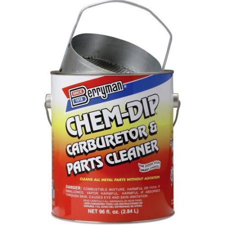

Achto 32,795 #6 Posted May 16, 2017 I use Berryman's carb cleaner, about $20 per gallon, can be bought at Wal-Mart. This stuff will clean every thing off of an old carb. An important note: Make sure that you do not leave any thing that is not made of metal on the carb, it will be gone after soaking your carb. 10 Share this post Link to post Share on other sites
JPWH 6,544 #7 Posted May 16, 2017 Is the Berryman better than the Gunk? I haven't used either one. Share this post Link to post Share on other sites
Achto 32,795 #8 Posted May 17, 2017 1 minute ago, JPWH said: Is the Berryman better than the Gunk? I haven't used either one. Both are about the same, I've used both. I've also used these products to remove paint build up on a spray guns. Like I said, if it's not metal it will be gone. I finish up by spraying parts down with brake cleaner & drying off with a blow gun. 2 Share this post Link to post Share on other sites

tims tractors 119 #13 Posted May 17, 2017 I,ve used Berrymans for 30 years good stuff. If using on a carb rinse with hot soapy water rinse again clean water an blow out all passages. 3 Share this post Link to post Share on other sites
r356c 375 #14 Posted May 17, 2017 (edited) A flea market or garage sale crock-pot makes a good hot tank for Berrymans or Gunk. The flash point of thinners would be too low for me to use them around heating elements. Edited May 17, 2017 by r356c Safety concern. Share this post Link to post Share on other sites

WHX?? 58,218 #17 Posted May 17, 2017 2 hours ago, ohiofarmer said: carb cleaner you bought was as hot as fire and worked much better than what we have today.. We had this discussion before where Berrymans had to take some of the VOC's out of their product to make it more "environmentally friendly" but it reduced it's effectiveness. Still is works good for me and a can lasts a long time. 1 Share this post Link to post Share on other sites
Tim.0 43 #18 Posted May 18, 2017 I use the gallon carb cleaner with the metal basket. Not sure what brand it is and have had it for a long time. Preclean, disassemble, let sit over night, clean with brake clean, and blow out. 2 Share this post Link to post Share on other sites

buckrancher 2,697 #21 Posted May 19, 2017 Berrymans is great stuff if you actually don't need to clean anything brian Share this post Link to post Share on other sites
