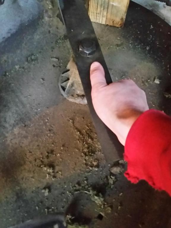

porschpow 7 #1 Posted May 16, 2017 So I was tightening the blade to the spindle and I had noticed there was some play when I tried to move the tightened blade up and down (shown in the pic) This normal? Share this post Link to post Share on other sites
pfrederi 20,874 #2 Posted May 16, 2017 no should not be any play if the appropriate washers are used and spindle nut tight Share this post Link to post Share on other sites
daveoman1966 3,884 #3 Posted May 16, 2017 Should be NO PLAY at all.... where is your pic? ? ? ? Share this post Link to post Share on other sites
pfrederi 20,874 #4 Posted May 16, 2017 In addition the spindle bearings if the deck shell is compromised, rust, cracks etc. that can lead to play Share this post Link to post Share on other sites
porschpow 7 #5 Posted May 16, 2017 I can't upload pics I know there's a nut UNDER the blade when you take the blade off and a under the other side on the pulley for the belts. I guess I can tighten those. But the deck looks in good shape as well as the spindle Share this post Link to post Share on other sites
porschpow 7 #7 Posted May 16, 2017 If I pull up vertically on the blade there is a tiny bit of play Share this post Link to post Share on other sites

cleat 9,053 #13 Posted May 17, 2017 Well, all the parts to a spindle are shown. If you have everything shown in the exploded diagrams and both top and bottom nuts are tight then either your bearings are bad or spindles are worn. Share this post Link to post Share on other sites
porschpow 7 #14 Posted May 17, 2017 Gotcha! I guess I will take a look at the spindle, going by the DWG on one of these threads it doesn't seem like a pain in the butt to do. Where does anybody get parts for these classic rigs? I take it a spent bearing is easier to replace then a spindle Share this post Link to post Share on other sites
