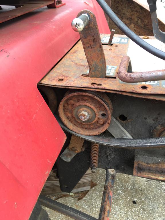

GreenMntRanger 38 #12 Posted May 17, 2017 (edited) Now the problems.... In the picture, the two front mounting points for fender are gone, giving the seat a "free float " feeling. Figure a few minutes with a welder to fab up 2 new tabs is the way to go. The arrow on the console is where the Tramsmission Drive Clutch Engage/ Disengage lever should be and it not. What exactly is the function, because the tractor runs and powers the mower deck fine? how hard of a fix is it? And yeah, she needs a new seat Edited May 17, 2017 by GreenMntRanger Share this post Link to post Share on other sites
WVHillbilly520H 10,379 #13 Posted May 17, 2017 47 minutes ago, GreenMntRanger said: Now the problems.... In the picture, the two front mounting points for fender are gone, giving the seat a "free float " feeling. Figure a few minutes with a welder to fab up 2 new tabs is the way to go. The arrow on the console is where the Tramsmission Drive Clutch Engage/ Disengage lever should be and it not. What exactly is the function, because the tractor runs and powers the mower deck fine? how hard of a fix is it? And yeah, she needs a new seat The engagement lever is for an idler pulley on the hydro drive belt, the newer versions ('90s?) eliminated this provision, now is it an issue that needs fixed I can't tell you as you say it runs/drives ok, but I'm sure someone with more knowledge of these style will come along shortly, Jeff. Share this post Link to post Share on other sites
19richie66 17,950 #14 Posted May 17, 2017 If that lever is gone, chances are the hydro belt is always engaged, therefore allowing the tractor to drive. Lever is probably just gone. I may have an extra if you need one. Nice tractor for the price. Share this post Link to post Share on other sites
GreenMntRanger 38 #15 Posted May 17, 2017 1 minute ago, 19richie66 said: If that lever is gone, chances are the hydro belt is always engaged, therefore allowing the tractor to drive. Lever is probably just gone. I may have an extra if you need one. Nice tractor for the price. A replacememnt lever would be nice...let me know what you would want for it Share this post Link to post Share on other sites
19richie66 17,950 #16 Posted May 17, 2017 Let me get home and check my parts tractor. 1 Share this post Link to post Share on other sites
19richie66 17,950 #17 Posted May 17, 2017 Here is the lever. Send me your address and Ill try and get it off and send it to you. Just pay shipping. 2 Share this post Link to post Share on other sites

19richie66 17,950 #20 Posted May 29, 2017 Went to pull the lever and it is almost worn in two from it being loose. I am starting to see why I got this thing so cheap. Sorry but I have no other good ones. Share this post Link to post Share on other sites
