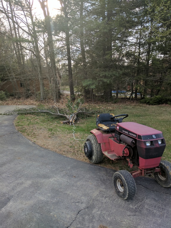

Roadhouse 12 #1 Posted May 14, 2017 Hey everyone me and my wife just bought our house in January and her father gave us his old too. It's a 93 312-8. He bought it brand new but it hasn't been used much the last few years. I had it running all winter, using the snowblower Wich worked awesome until the chain broke. Now i took the blower off and was getting it read for the mower deck and it won't start. It just cranks and cranks. From what I've read online it sounds like the carb needs to be rebuilt. The last time it ran I was constantly adjusting the choke. Just want to make sure that's what I need before I start throwing money at it. I would love to get it back into good shape and running right. It has the 12 horse Kohler, any help would be grateful. Thanks! 6 Share this post Link to post Share on other sites

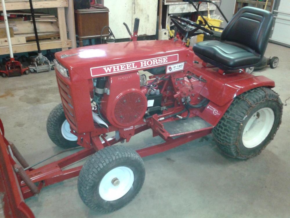

BOB ELLISON 2,983 #21 Posted May 14, 2017 14 minutes ago, Roadhouse said: I'm trying to be a sponge because I don't know anything about these old tractors, but I love the look and nostalgia that comes with them. I would love to restore this tractor and let my daughter pull it at the fairs. I was the same as you. I love to work on a good quality machine. I got my first wheelhorse and it was a mess but I saw it as a great machine that someone neglected so I joined this forum to get all the info I could get about this tractor. All the guys here helped me and I got all the experts telling me what I must do to get it running and working. I now support this site and help others with the knowledge I have. It's a Great place to get help.this is my before and after. You can make that wheel horse look like new and we will help you all the way. read read read and you'll find it in the search on main page . WELCOME TO THE BEST WHEEL HORSE SITE IN THE WORLD. 3 Share this post Link to post Share on other sites
Roadhouse 12 #22 Posted May 14, 2017 That is one heck of a transformation! Nice work man. I will let you guys know as soon as I get some parts. 1 Share this post Link to post Share on other sites
