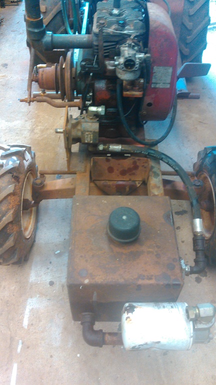

JPWH 6,544 #2 Posted May 13, 2017 Take a look at My raider 12 modification thread. That is a K181 motor. The hydraulic tank is the biggest issue. 1 Share this post Link to post Share on other sites
Huntemcd 239 #3 Posted May 13, 2017 1 hour ago, JPWH said: Take a look at My raider 12 modification thread. That is a K181 motor. The hydraulic tank is the biggest issue. Could you add a pic of it please? Share this post Link to post Share on other sites

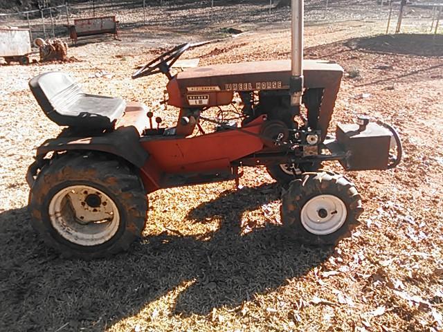

JPWH 6,544 #4 Posted May 13, 2017 thi is the way I used it for a few years. 1 Share this post Link to post Share on other sites
