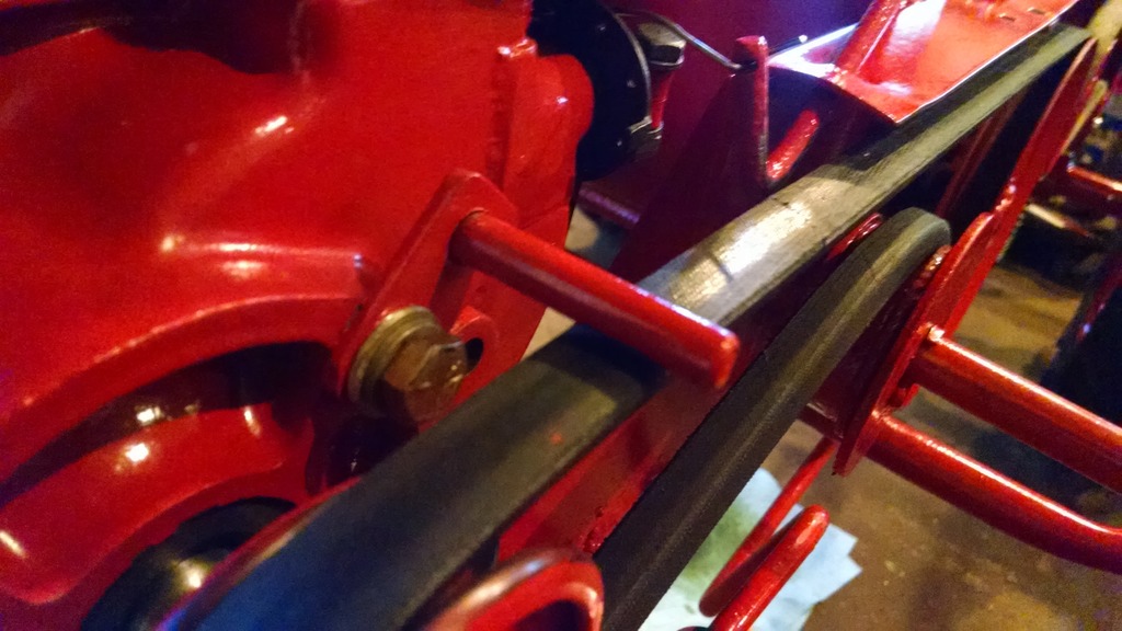

Achto 31,619 #2 Posted May 13, 2017 (edited) 2 hours ago, ebinmaine said: Any thoughts or ideas of how I can do this? What have you done to yours? Here is a belt brake that I made for a recent project that I'm working on. It's made from a piece of flat steel and round stock. A cut off bolt will work in place of the round stock also. Edited May 13, 2017 by Achto 1 Share this post Link to post Share on other sites
ebinmaine 78,354 #3 Posted May 15, 2017 Here's my solution to the problem: I poked around looking at several other threads and the pics in them... and then went for a stare at my own tractor. The stock belt shield has a tab sticking out the engine end, top and bottom. I bent them towards the belt to take up the extra air space created by the much smaller pulley. It worked !! Share this post Link to post Share on other sites
