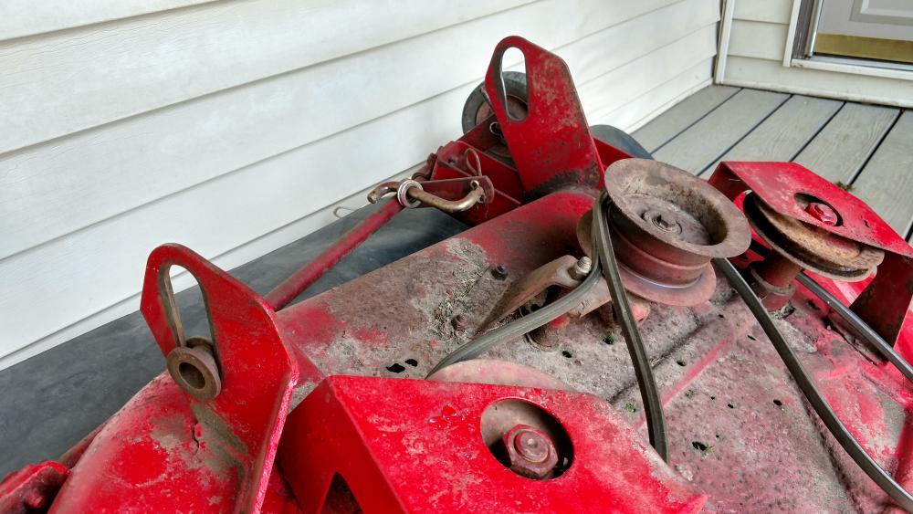

CountryRock 199 #4 Posted May 16, 2017 Is there supposed to be a bushing in the left rear lift slot like there is in the right rear. Picture for reference. Share this post Link to post Share on other sites
evanloock 266 #5 Posted May 16, 2017 The manuals that guest_ca posted show the guide bushing on both the right and left side brackets. Share this post Link to post Share on other sites
CountryRock 199 #6 Posted May 16, 2017 Probably should have checked those earlier. I just went by the diagram on the toro parts store site. Thanks. Share this post Link to post Share on other sites
