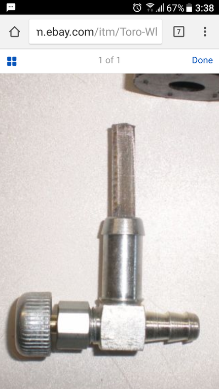

WVHillbilly520H 10,379 #4 Posted May 12, 2017 Don't forget the "partstree.com" tractor model and serial #s or Kohler engine model/serial #s should get you parts/ numbers you're looking for, another thing that could be an issue is the bronze screen/filter on the tank shut off bung could be getting clogged up after all those years especially if you have ever run ethanol fuel, Jeff. 2 Share this post Link to post Share on other sites
jeff lary 173 #5 Posted May 12, 2017 Hi Hillbilly , Yes good catch there but alas no joy there either. I just took the petcock out and the very bottom of the screen had a very tiny amount of stuff on it. I sprayed some WD 40 backwards through the outlet to wash the screen from the inside. Then I hit it with lots of air and bing bang boom clean screen. I did forget about parts tree maybe I will try there. Next time I go to the shop I will look in the book or maybe on the engine for a model number. Then see if I can use that to find one at parts tree. I sometimes forget how to search different web sites so if that happens I may be back ! It wont be tonight and we are Mothers "daying "it tomorrow so maybe Sunday morning. Share this post Link to post Share on other sites
