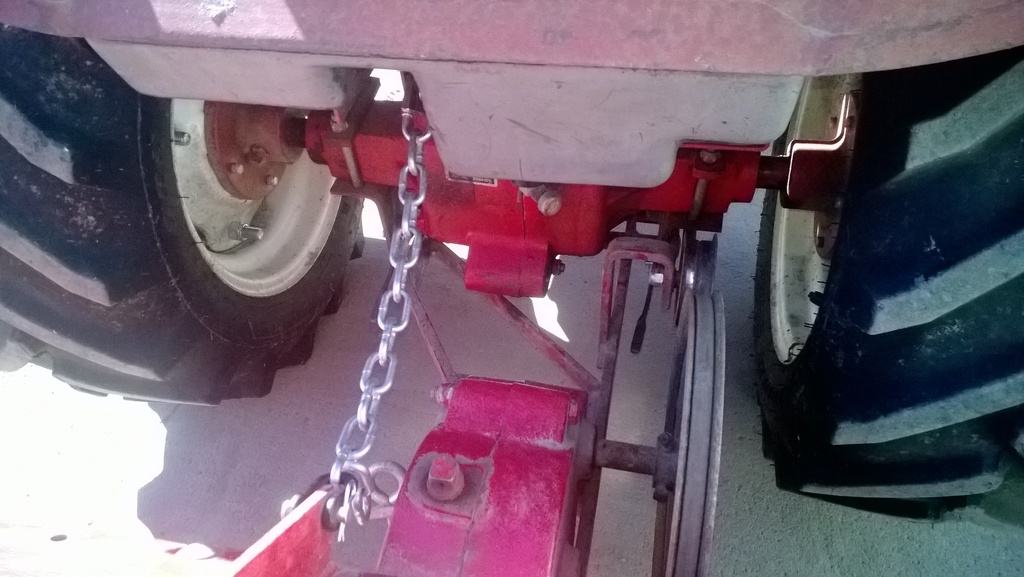

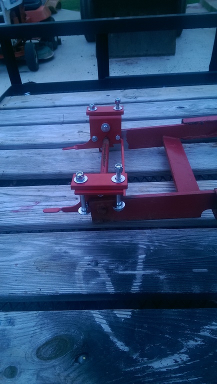

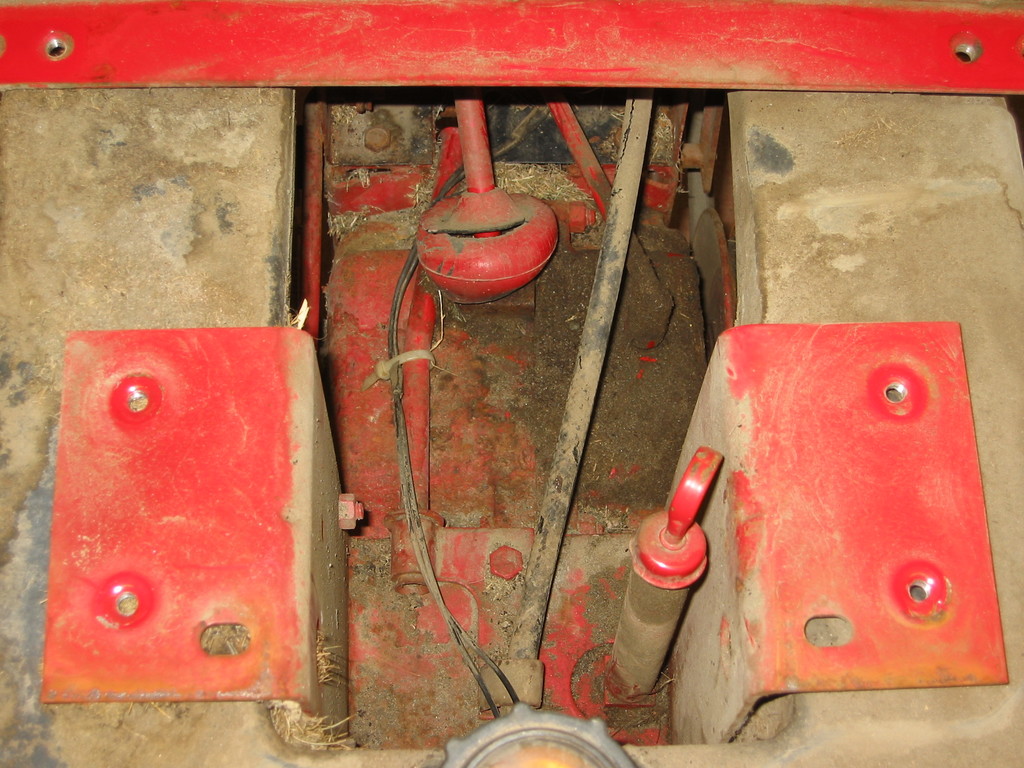

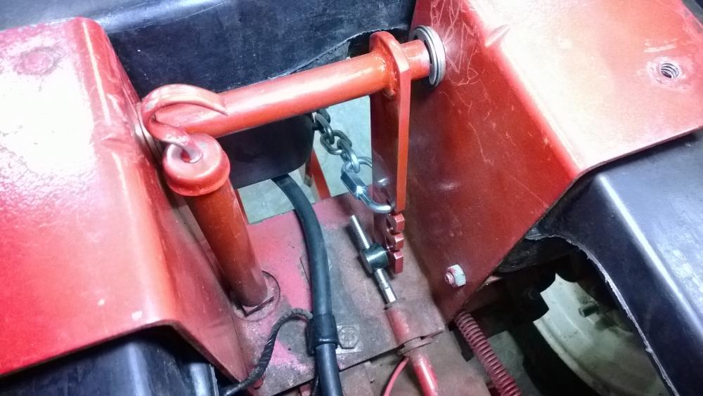

wheelhorseman 3,256 #3 Posted May 12, 2017 Here are some pictures 2 Share this post Link to post Share on other sites
jsPond 51 #4 Posted May 12, 2017 Thank you. Very helpful. Now, would you happen to have a shot of where the lift cable goes by the shifter? The area ahead of what the first shot in your post shows? That area is my problem area. I do not have the rocker shaft but I have two parts machines that I need to check out before I order anything. Share this post Link to post Share on other sites

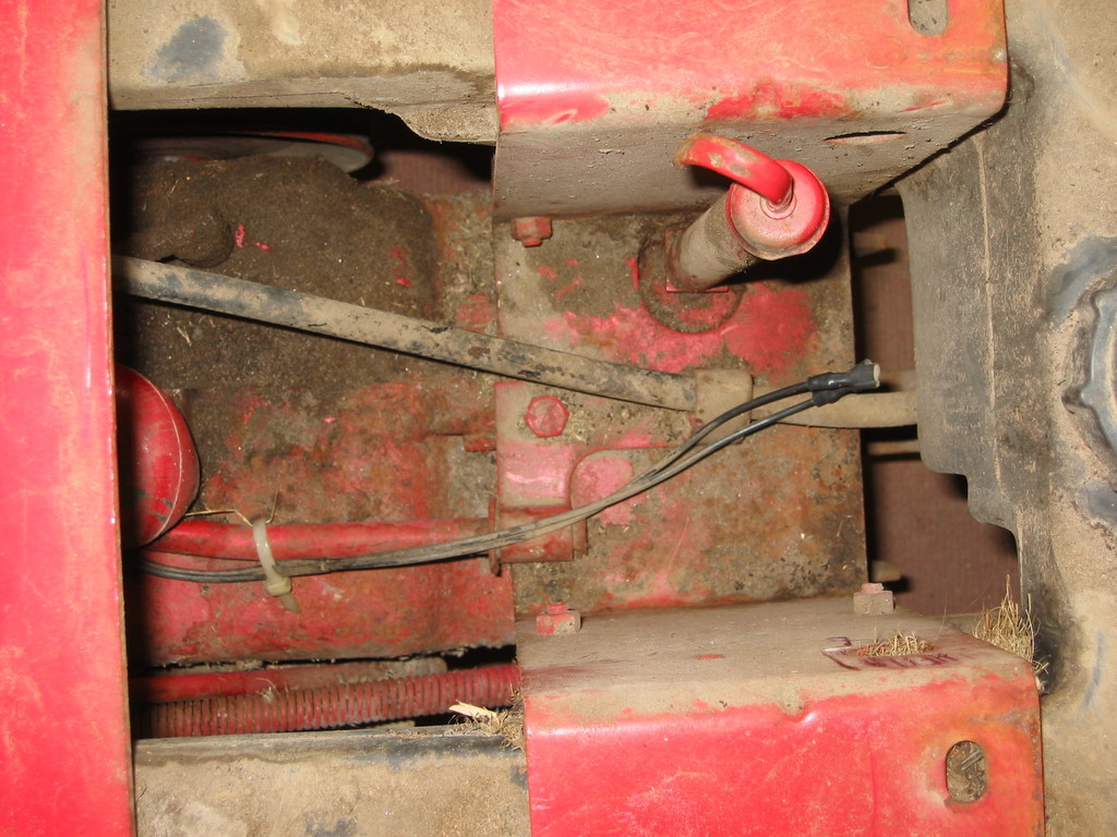

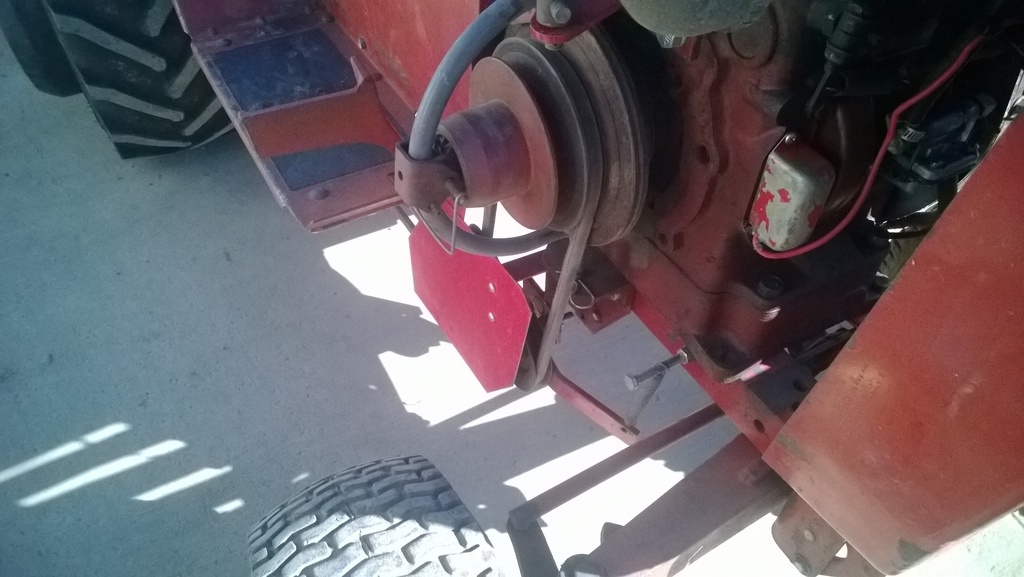

WVHillbilly520H 10,379 #7 Posted May 12, 2017 I don't have pictures of a manual trans all mine are hydro but where the frame (4) bolts to the trans there's a small hole (maybe 5/16" diameter) about dead center at the top where the cable goes through (its kinda a PITA but not all that bad approximately where the orange wire with silver clip is hanging in my pic) then the cable is attached via a clevis to the mower/mid rockshaft (where the snow blower lift link is in my pic) and the guide tube really is a necessity as the cable will wear through the trans case without it as well as the rear under seat rock shaft and the snow plow axle quick hitch to fit the tiller up, Jeff. 1 Share this post Link to post Share on other sites

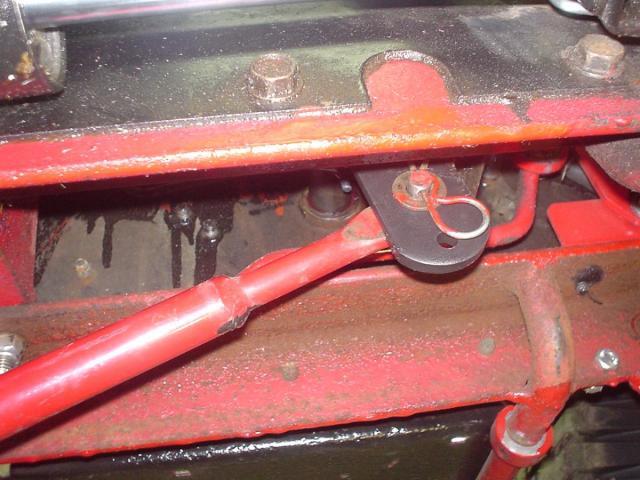

pfrederi 21,231 #8 Posted May 12, 2017 Pictures of the tube in an 8 speed. Look to me like the tube is sort of necessary or the cable will be rubbing on the shifter 2 Share this post Link to post Share on other sites

jsPond 51 #10 Posted May 13, 2017 3 hours ago, pfrederi said: Pictures of the tube in an 8 speed. Look to me like the tube is sort of necessary or the cable will be rubbing on the shifter Yes, that's what I was looking for. I did manage to find where everything goes this evening. I actually got a piece of small PVC to run a tube, just to try it. I realize it won't last long but it may give me enough time to get the daughters garden tilled. 29 minutes ago, clueless said: If you don't have the rear rock shaft your going to need a larger cable to try and I mean try to lift the tiller. The rock shaft is the back bone of the tiller, depth, lifting, and lowering. You can probably cut some corners, but it's just not going to work well. Boy, you're not kidding. The guy I bought the tiller from didn't have the rock shaft either. He was running it straight cable. Armstrong hydraulics for sure! I'm going to try a little something that may help and get me going until I can get the proper parts. I want to eventually get another horse that is a dedicated tiller tractor and forget all this nonsense. I threw my back out trying to lift the stupid thing to see how high it can go so worked stopped for tonight. Will try all this tomorrow. Thanks for the help guys! Share this post Link to post Share on other sites
