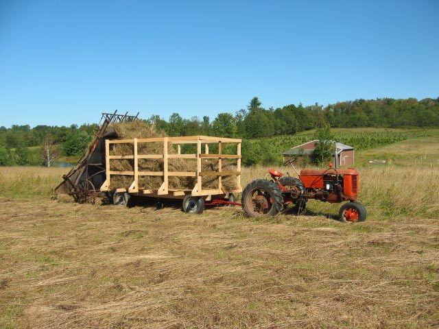

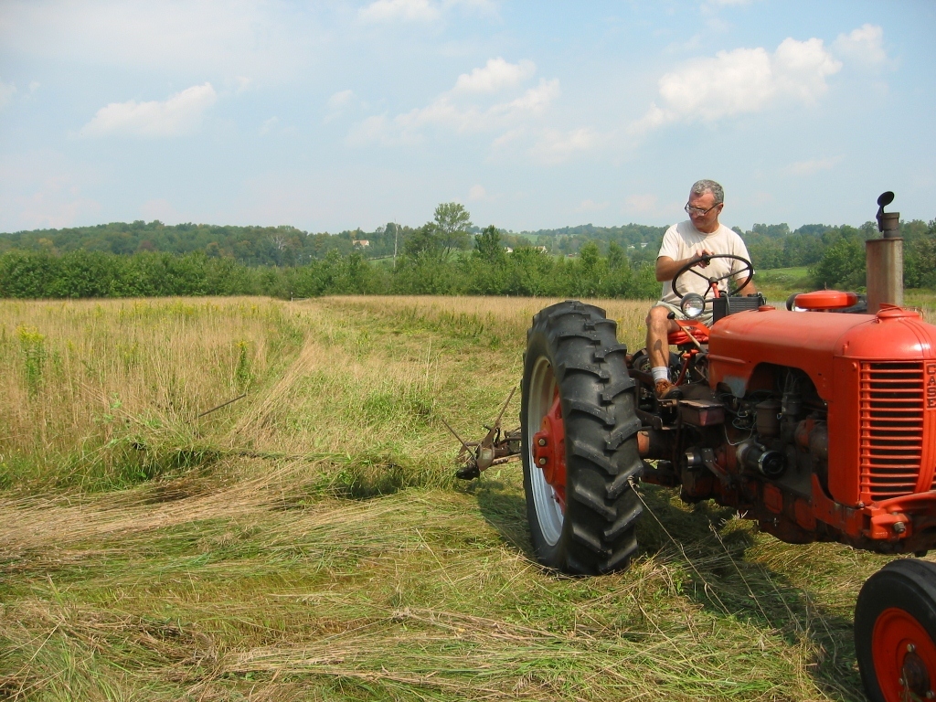

pfrederi 21,231 #8 Posted May 10, 2017 (edited) Almost gone Edited May 10, 2017 by pfrederi 2 Share this post Link to post Share on other sites
pfrederi 21,231 #9 Posted May 10, 2017 Using a sickle bar is differnet than a more modern a discbine or the like. You do not go as fast and they do not like damp/wet grass. I have a753 with a sickle bar. I switched out the tranny to make it an 8 speed. That way i can get the ground speed correct as to fast will create clogging and jamming. Like Gary I do not run it at full throttle. On my DC3 above I run it in 1st or second gear at about half throttle. 1 Share this post Link to post Share on other sites
