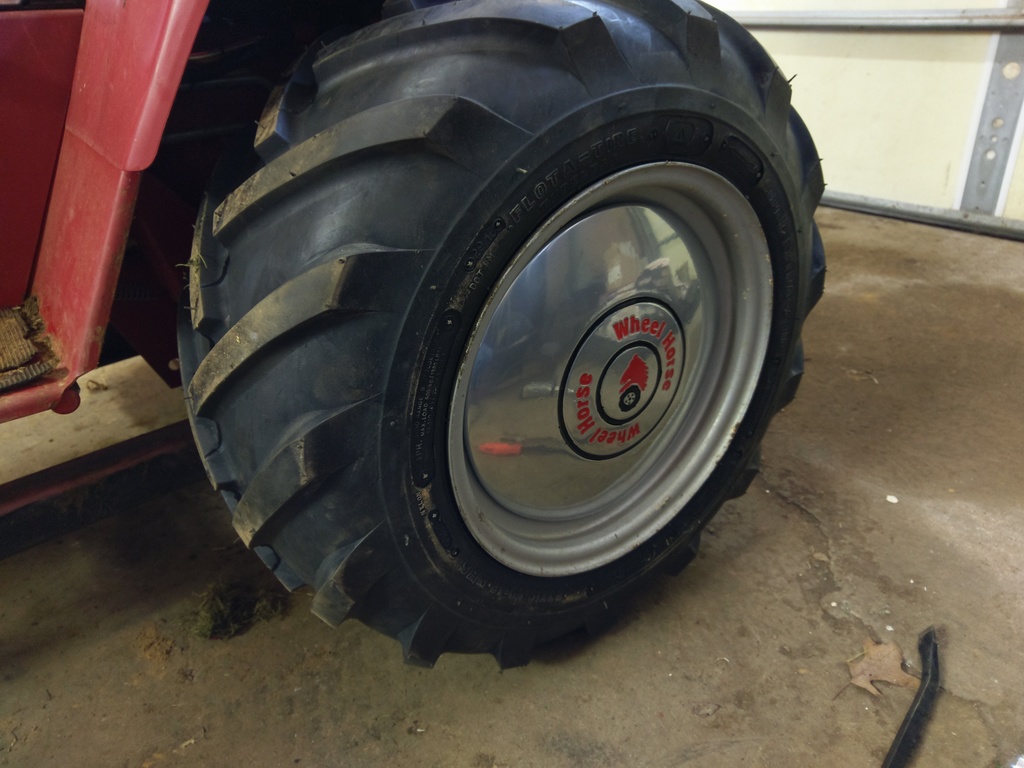

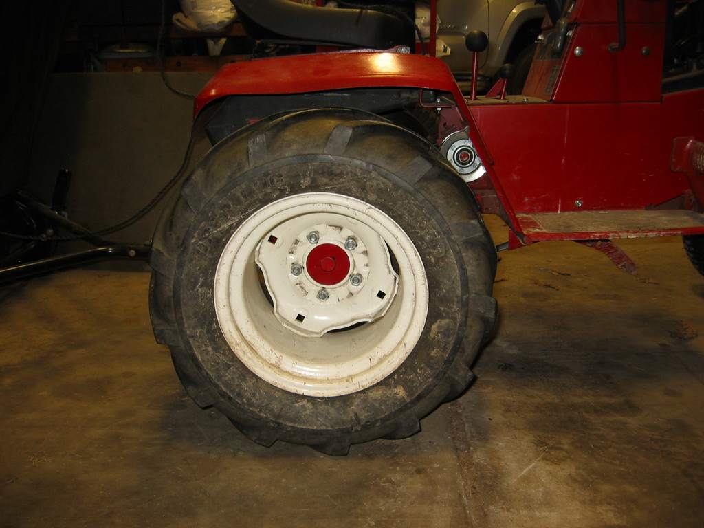

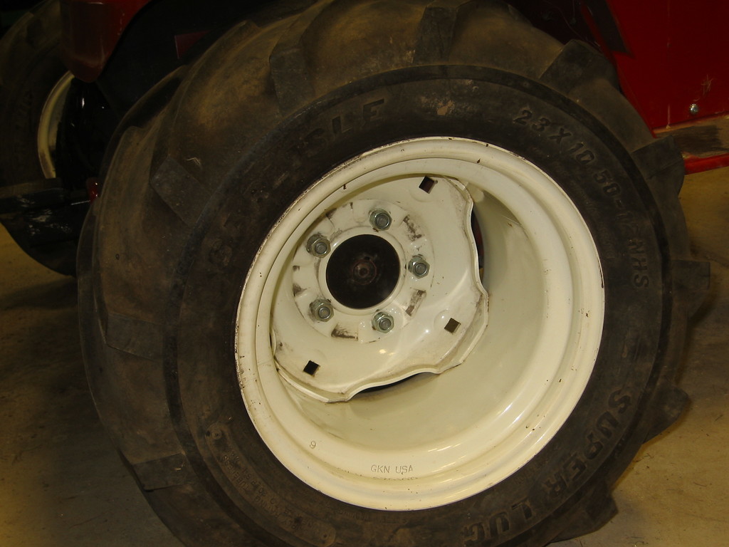

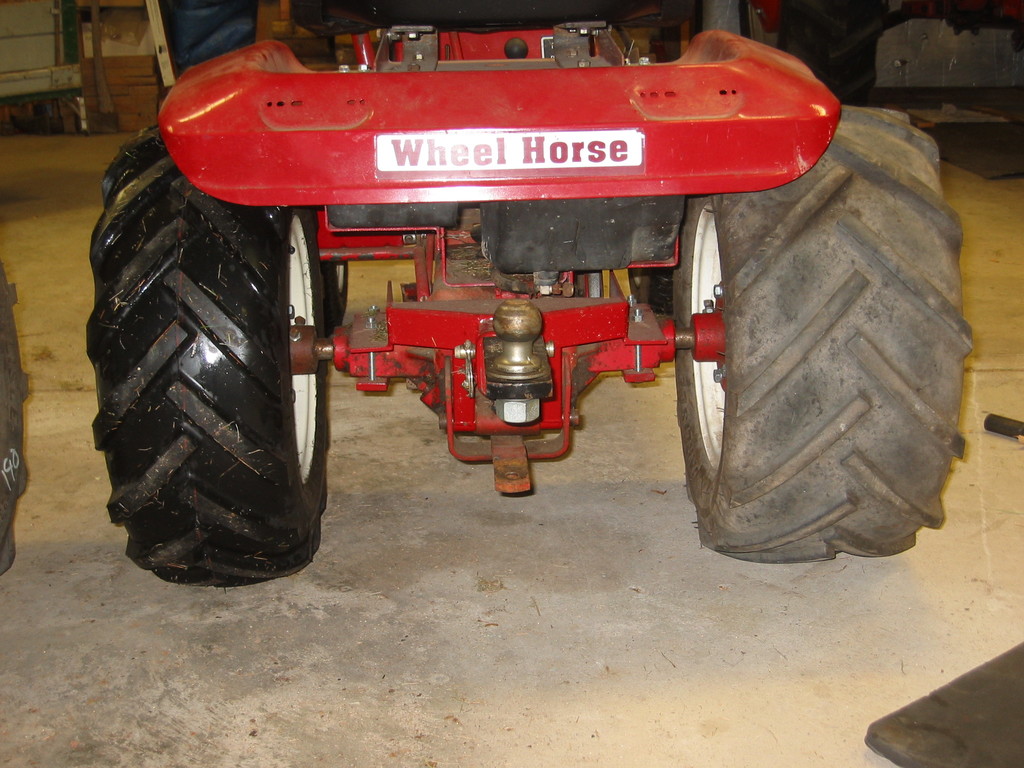

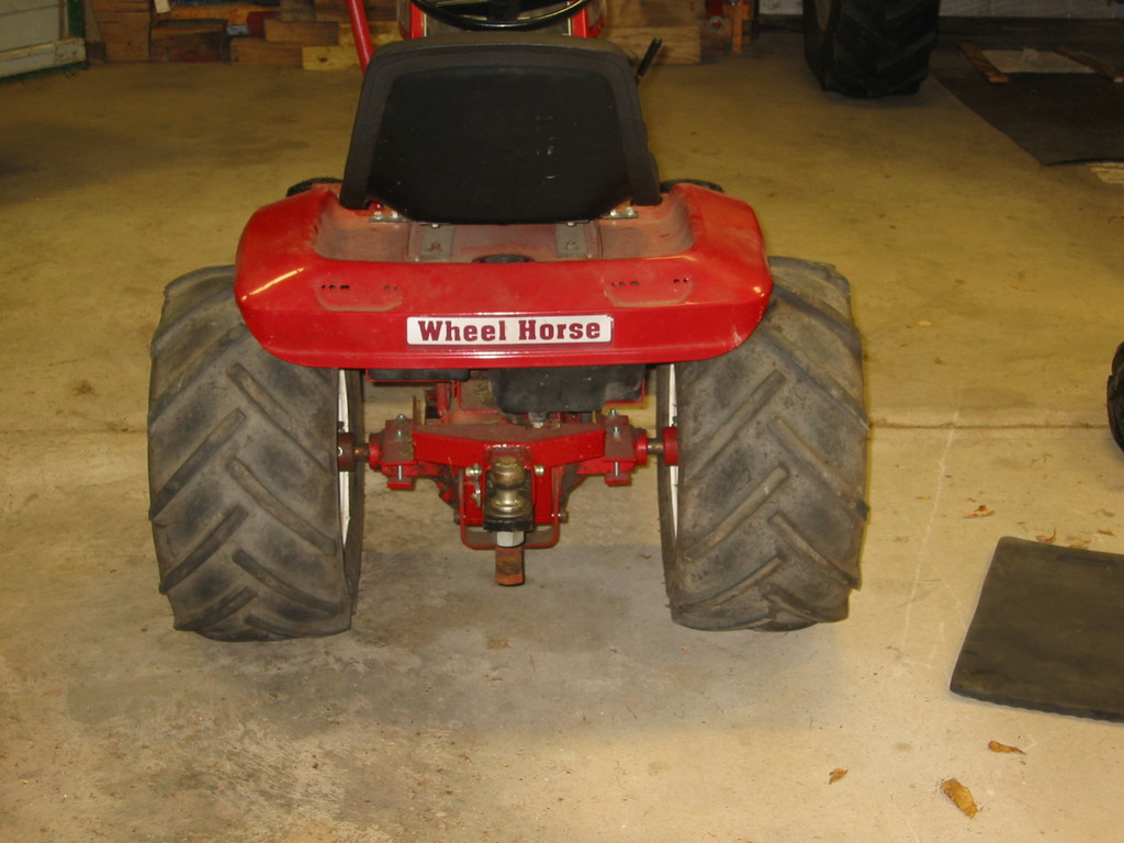

pfrederi 21,306 #2 Posted May 9, 2017 I have them on my 310-8 which should have the same fender clearances as your 314. Note how much wider they are than the deestones of the same size 2 Share this post Link to post Share on other sites

BigRed84 65 #5 Posted May 9, 2017 WOW!! Thanks for the pic...that almost looks too wide for what I was expecting. Both of those tires in the comparison photo are labeled as 10.5?? That does bring me to another question then....My main use for the tractor will be garden work, hauling a semi-heavy cart around, eventually I would love to have a plough set up, and snow blowing the paved driveway and path down to my wood shed which is on grass and hills. Maybe a narrower tire would be better? I'm confused, all my knowledge of tires comes from the mud tires I get for my jeep and truck, and the concept was always wider being better for off road use, narrow being better for snow. True for tractors as well? I don't think the 314 has a locking diff right? (one tire-fire if I started spinning?) Share this post Link to post Share on other sites

Achto 32,924 #7 Posted May 9, 2017 You could drop to a 23-8.50x12 Carlisle, you will only loose an inch of width and if you wish to use a mold board plow it will fit a little better in the furrow. Just my opinion. Or the Deestone 10.50's are actually closer to 9.50 in width if you wish to stay close to original. 1 Share this post Link to post Share on other sites

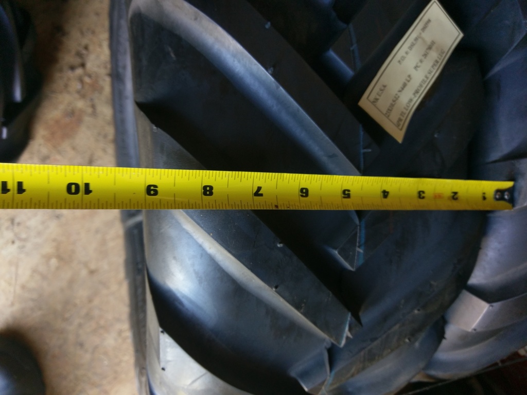

BigRed84 65 #8 Posted May 10, 2017 So if the Carlisle 10.50 is that much wider than the Deestone....would it be safe to say the Carlisle 8.50 runs slightly wider than advertised as well? I measured the turf tires I have on there now. Advertised as 9.50....the tread themselves only measures 9"....i can see 9.50 if I measure straight out from sidewall to sidewall but i didn't think that was the accurate measurement. I definitely didn't want to lose any height either so if the Deestone runs small on height as well as width I might stick with the 23 x 8.50 from Carlisle. Thanks for the advice fellas. 1 Share this post Link to post Share on other sites

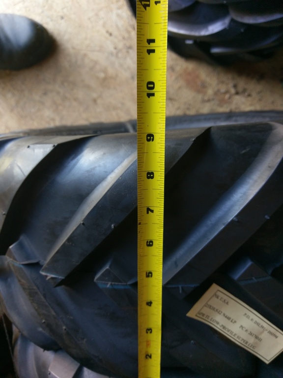

WVHillbilly520H 10,379 #10 Posted May 10, 2017 These Nanco 23x10.50-12 Ags I bought run right at 9.50 wide mounted and inflated, might be exactly what you want I'm very satisfied with them, Jeff. Share this post Link to post Share on other sites

pfrederi 21,306 #12 Posted May 10, 2017 (edited) Yes both tires in my picture are 23 10.50 x12 Deestones run small. Also you have an open differential it will spin one wheel. (That is why I converted the 310-8 in my pictures to a 10 pinion limited slip) As to China and quality...try to find a small tire NOT made in China anymore. Edited May 10, 2017 by pfrederi Share this post Link to post Share on other sites
