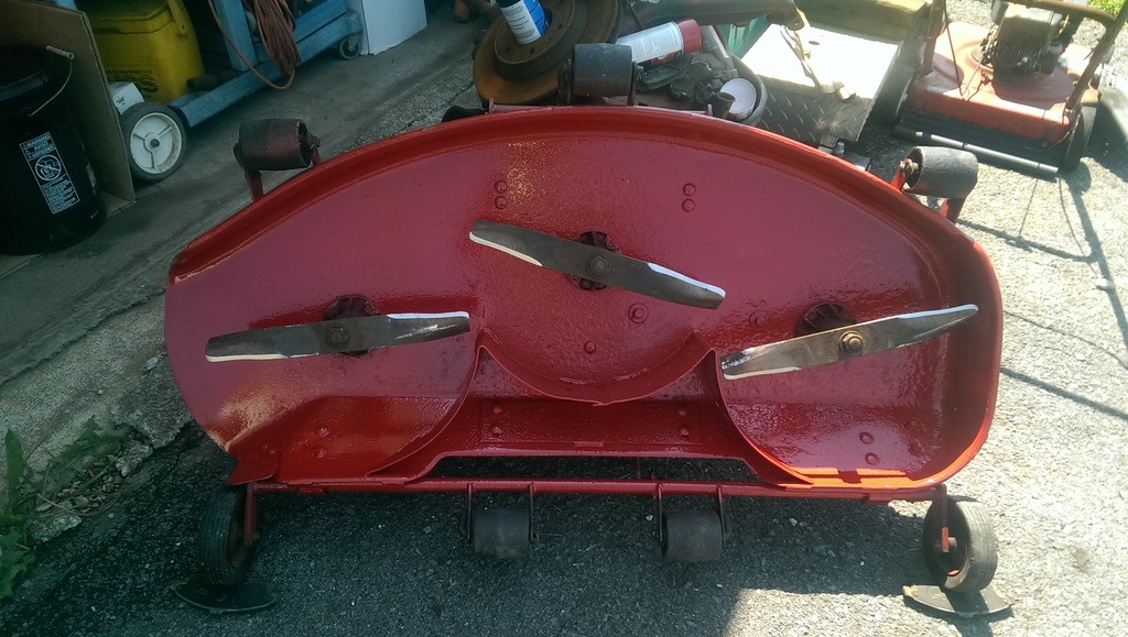

gwest_ca-(File Mod) 12,259 #5 Posted May 9, 2017 My dad bought a new tractor and deck in 1985. After he cuts each time the deck comes off and he made a stand that will support the deck if the front is lifted and rolled over so the bottom is exposed. It hangs there at about a 15 degree angle with the bottom facing up. It is bushed or scraped to remove all cuttings and left in that position until the next cut. There is not a spec of paint left on the bottom but there is no rust either. Simply because when flipped over it can dry. It gets a coat of oil in the fall after the last cut and that is it. Garry 3 Share this post Link to post Share on other sites
slammer302 2,157 #6 Posted May 9, 2017 When I buy a used deck I always power wash the under side. If it's already rusted I coat with oil and will repeat coating with oil frequently till the metal gets seasoned. If the deck has no rust I will repaint or use graphite coating or por15. Share this post Link to post Share on other sites

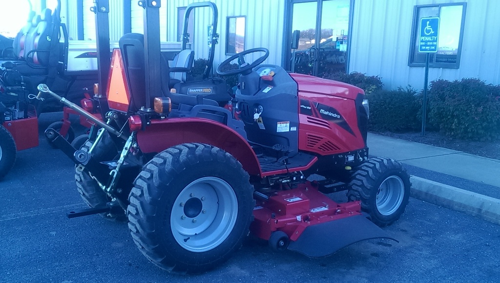

WVHillbilly520H 10,378 #11 Posted May 10, 2017 How would you like to drag and flip the 480 lb 60" cut fabricated deck on my new Mahindra? Anyway on my 520s with 48" decks I use a set of metal (in my case) 8" car ramps drive up on them till nearly in the tire "pockets" then crawl under scrape the worst and "wash" with garden hose sometimes deck running (yes a safety NO NO) but then either let it set a dry or use compressed air to dry, then some "cooking spray" or "MoDeck" to help with grass not sticking as bad till I sling mole hills then that clay builds up worse than the grass, till removing whole deck for blade swap and thorough clean, repeat, repeat ect till fall, no rust through yet on my bought new 520 in 19 years can't say the same on the last 2 I brought home last year, Jeff. 3 Share this post Link to post Share on other sites
