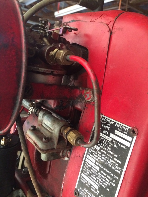

Joshwah Valentine 3 #1 Posted May 9, 2017 Hi im a little new to wheel horses and i got a 1975 wheel horse b80 4 speed. recently when i went out to start it it started but then it ran for ten sec and died. its been doing this for a month now and i cant figure out the source of the problem, at first i tryed the plug and that wasnt the problem then i rebuilt the carb, that didn't work. so i replaced the coil and still doing the same thing as before. so if anyone has some info to what the problem could be i would be greatful. thank you 1 Share this post Link to post Share on other sites

Racinbob 13,047 #9 Posted May 9, 2017 I'm thinking yes, it should have a fuel pump on it. My 76 B-80 did. Not that it wouldn't work on gravity but I'm wondering if the previous owner messed with it. Here's the pump. Your fuel line will be different because this is a 64 but the pump is in the same place. 3 Share this post Link to post Share on other sites
Joshwah Valentine 3 #10 Posted May 9, 2017 OK it's like that it's a rubber hose insted of the metal one. Thank you all for helping me figure this out I'm going to check all this out and see if it works 1 Share this post Link to post Share on other sites
