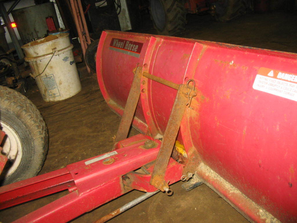

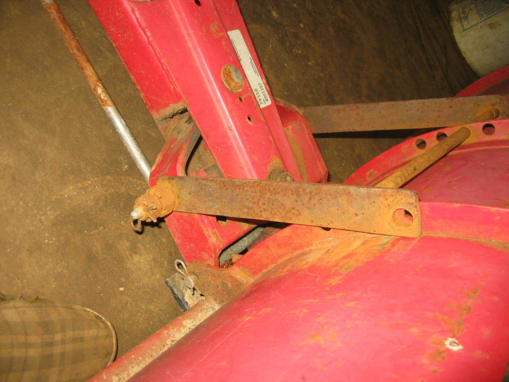

daveoman1966 3,884 #2 Posted May 9, 2017 I did this..... the flat stock is about 1/4" thick..... Use springs to plot the two hole locations... 1 Share this post Link to post Share on other sites

daveoman1966 3,884 #6 Posted May 9, 2017 The flat bar stock that I installed on each side, in place of the springs, works very well in pushing hard-pack snow or cutting into a mound of packed dirt / gravel.....without tripping the blade. Of course, slow speed to avoid the FAST IMPACT is common sense. 1 Share this post Link to post Share on other sites
