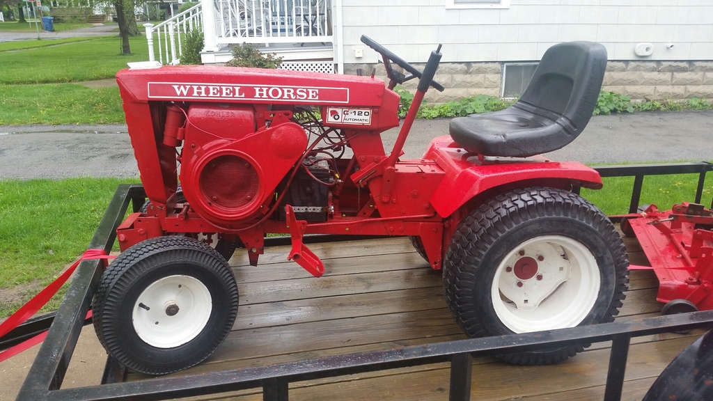

Tgtack 780 #1 Posted May 8, 2017 I "intended" to give it a clean up and replace the wiring, and one thing led to another, and I think I got a little carried away! 11 Share this post Link to post Share on other sites
squonk 48,327 #2 Posted May 8, 2017 I think you used too strong a cleaner! 6 Share this post Link to post Share on other sites
DennisThornton 4,773 #3 Posted May 8, 2017 Should have brought it in sooner! Today's UV rays are brutal! Don't know how the tires survived! Share this post Link to post Share on other sites
Tankman 3,528 #4 Posted May 8, 2017 Due to your WHA (Wheel Horse Addiction) you're spoiling the Horse. Looks great! Welcome to the WHA Association. Share this post Link to post Share on other sites

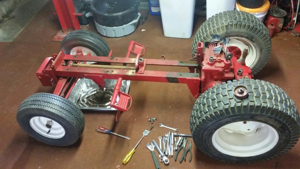

Tgtack 780 #5 Posted May 9, 2017 Thanks, found some stress cracks on some of the sheet metal, so pulled them and had the cracks ground out and tig welded, so one thing led to another, and getting ready to separate the frame from the rear end/tranny so I can flip it over. New tie rods are in order, and there is some play in the front axle, so gotta look at that as well. 1 Share this post Link to post Share on other sites
Tgtack 780 #6 Posted May 9, 2017 (edited) Found that the rear frame plate that bolts to the tranny has been cracked and bugger welded, will have to grind it out and get it rewelded! Edited May 9, 2017 by Tgtack Share this post Link to post Share on other sites
