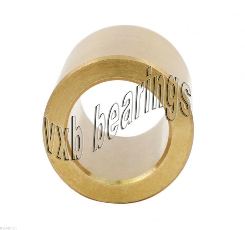

Molon_Labe 731 #5 Posted May 9, 2017 I cut down one of these 1/4"x7/16"x1" bronze bushings for a Walbro carb on a K241 years ago, the price was certainly right and had enough left over for a few more if ever needed. Ace Hardware also sells Hillman bronze bearings 1/4"x7/16"x1/16" PN#58087-A which work just as well and are easier to seat than the thicker bushings. http://www.ebay.com/itm/1-4-x-7-16-x-1-inch-Bronze-Brass-Cast-Bushing-Plain-Sleeve-Bearings-0-25-Bore-id-/360738272987?hash=item53fdad36db:g:1OkAAOxyM89ScpZo 2 Share this post Link to post Share on other sites
