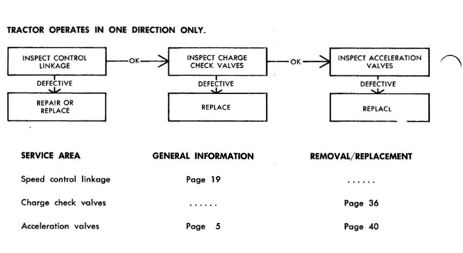

pfrederi 21,306 #5 Posted May 8, 2017 Try leaving the deck up and see how long it stays. If there is an internal flaw in the cylinder it may get worse as the oil thins out. Failure to operate in one direction diagnostically lead to charge relief valve and/or acceleration valves. Acceleration valves would not influence the lift cylinder but the charge relief valve could. I note yours still works in reverse but get weaker slight leakage gets worse with heat???? Share this post Link to post Share on other sites
