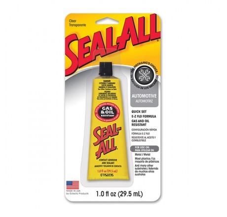

Duramax7man7 506 #1 Posted May 7, 2017 Anyone ever had to replace one of these? Long story short.... I do and the screws were not coming out... I cut the head of the screws off... I had to cut the nuts out. The plastic knobs surrounding the nuts on the inside of the tank are still there. QUESTION: Is there any type of fuel proof adhesive or sealant that I can use to reattach the knobs on the inside of the tank? Q2: Anyone have any ideas to install a new FLS unit that had to be cut out? I can post a photo of what I'm working with if need be. Share this post Link to post Share on other sites

Duramax7man7 506 #5 Posted May 7, 2017 Good idea. Last night I was thinking of using a hot glue gun with polyolefin glue sticks. I read that this type has the best adhesion and repair properties of all hot glue sticks to HDPE which is what I believe the tanks are made of... The outside of the tanks inner plastic bubbles that held the nuts for mounting the sending unit are still intact. So what I use, I would need to just place the new nuts inside the bubbles and glue them completely shut. Seems like the old ones are aluminum and were massively corroded. Share this post Link to post Share on other sites
Tankman 3,528 #6 Posted May 7, 2017 Slowly, using a soldering gun PE (polyethylene) welds nicely. 1 Share this post Link to post Share on other sites
Duramax7man7 506 #7 Posted May 7, 2017 touching the plastic or no? Share this post Link to post Share on other sites
Tankman 3,528 #8 Posted May 7, 2017 (edited) 4 hours ago, Mastiffman said: touching the plastic or no? Yes. Gun on the plastic, melt and slowly pull. Although plastic welding rod is sold, never purchased any. Have cut some strips from milk jugs and used that when I needed a little filler. UV is polyethylene' worst enemy. Exterior latex house paint blocks UV and is designed (engineered) to expand and contract. Edited May 7, 2017 by Tankman 1 Share this post Link to post Share on other sites
