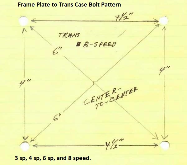

953 nut 70,057 #2 Posted May 6, 2017 Howard, sorry to hear of the problem. For the most part any transaxle will bolt up. The things that have changed over the years are mostly involving the brake band and how the lever that actuates it is connected. As long as the exterior appearance is close to the same it will work fine. 4 Share this post Link to post Share on other sites
daveoman1966 3,884 #3 Posted May 6, 2017 Here is the frame-plate bolt pattern....uniform for 4, 6 , 8 and automatics. Thats what I like about these machines.....easy swaps. You MAY have some linkage issues, but those parts are everywhere available from members... 6 Share this post Link to post Share on other sites
