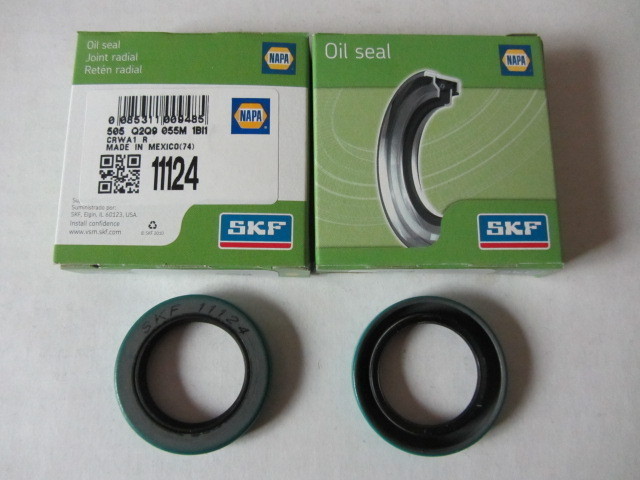

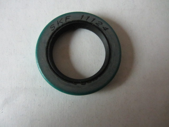

muz123 1,193 #1 Posted May 5, 2017 Just pulled off the seal off of one of the right side of the rear axle. Not sure of the replacement part number as parts tree doesn't show it. Anyone know the seal part number? Thanks, Dave Share this post Link to post Share on other sites
gwest_ca-(File Mod) 12,478 #2 Posted May 5, 2017 https://www.partstree.com/parts/toro/mowers-lawn-garden-tractor/31-12ke01-312-h-toro-312-h-garden-tractor-1990/transaxle-312-h-416-h/ 6449 is the Toro number Garry 4 Share this post Link to post Share on other sites
pfrederi 21,095 #3 Posted May 5, 2017 or CR11124...excuse me SKF 11124 still Chicago Rawhide for us old farts. 5 Share this post Link to post Share on other sites
ztnoo 2,302 #4 Posted May 5, 2017 http://www.napaonline.com/napa/en/p/NOS11124_0338963144?interchange=1 5 Share this post Link to post Share on other sites

muz123 1,193 #11 Posted May 7, 2017 Thanks for the help all. Just ordered the one from eBay. 1 Share this post Link to post Share on other sites
