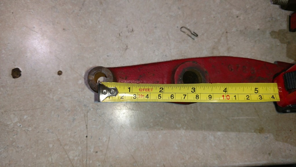

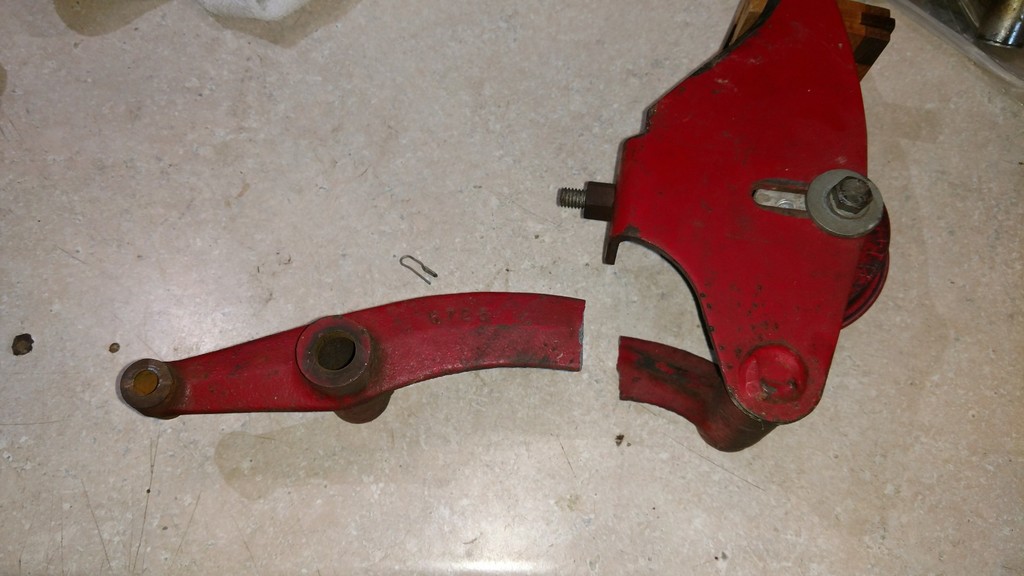

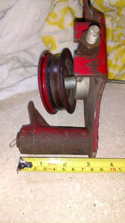

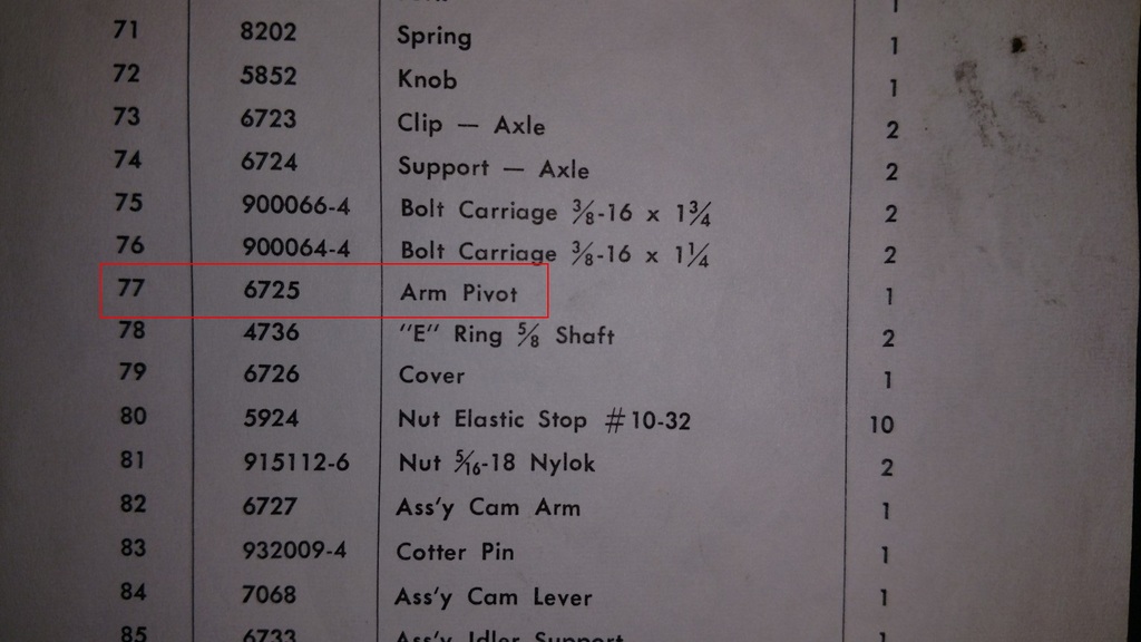

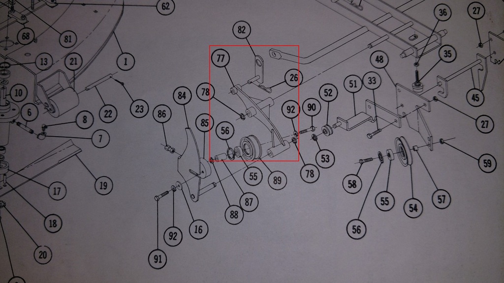

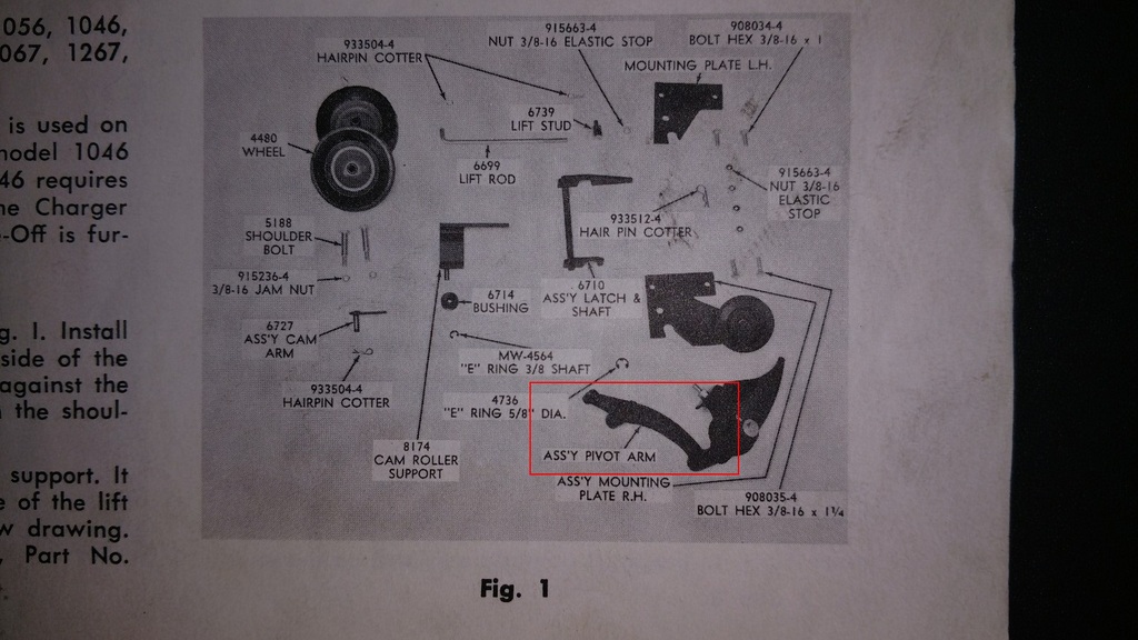

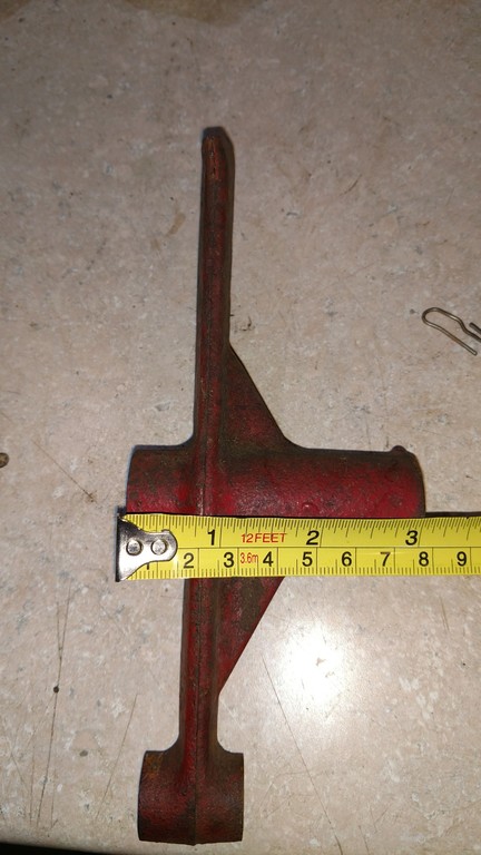

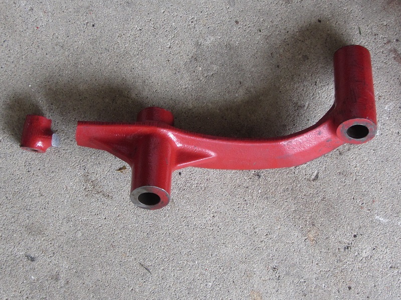

HoosierDude 4 #1 Posted May 5, 2017 Probably a long shot, but.... I'm looking for a replacement "ASS'Y PIVOT ARM" for a Wheel Horse Rotary Mower Model 5-1422. It's item # 77 on the drawings, part # 6725. Anyone have any idea where I can find one? Or should I go ahead and try to find a fabrication shop that will take it on? See pics. Thanks in advance! Share this post Link to post Share on other sites
Ed Kennell 47,019 #2 Posted May 5, 2017 They are cast iron, but they can be welded. I have welded several arms using a good arm as a jig to keep the pieces in alignment during welding. I also have several good used arms. There should be plenty of these available in your area. Good Luck and to the . Share this post Link to post Share on other sites

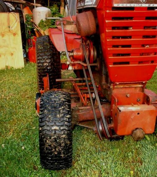

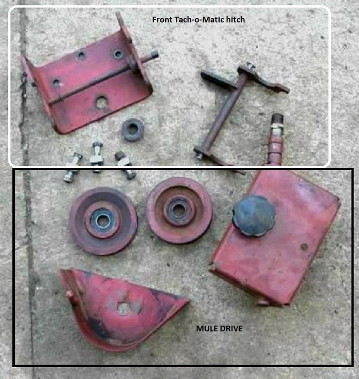

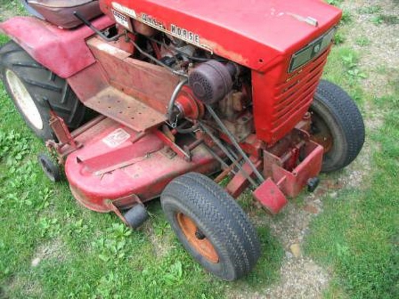

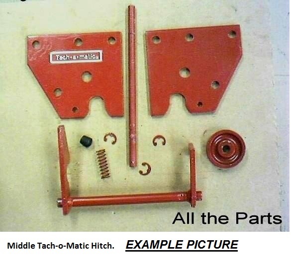

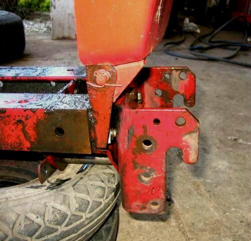

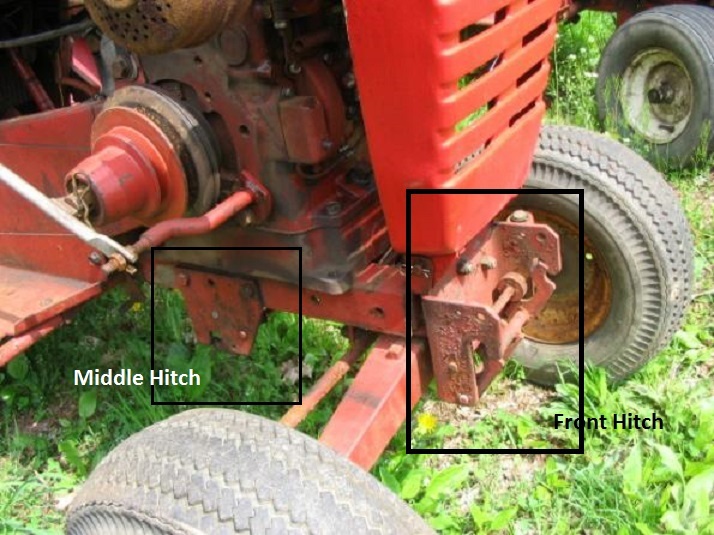

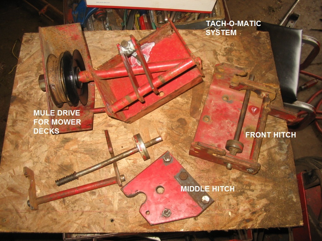

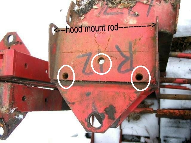

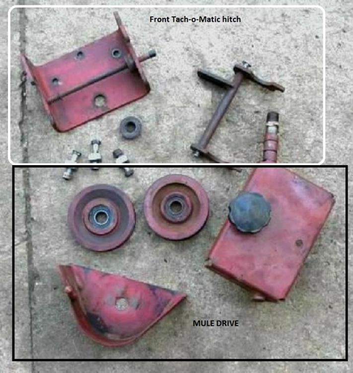

daveoman1966 3,884 #3 Posted May 5, 2017 This side-ways-mounted belt adjustment system is not a very good design and is fraught with calamity...like you just experienced. It is quite an easy one-hour operation to change over to the FRONT mounted MULE DRIVE whereby the belt is routed around the front axle and adjusted by a KNOB to set the belt tension. Here are a few pics of the 'upgrade' I am suggestiong. I ahve all the parts to do this... 1 Share this post Link to post Share on other sites
ztnoo 2,302 #4 Posted May 5, 2017 (edited) I busted a 6725 about two weeks ago while working on another problem with my deck which was caused by mindless carelessness and inattention on my part. I busted the small end. I immediately posted here to RS and to three WH Facebook sites ISO the part. To my amazement, within an hour a guy whom I never met, living within my country, replied and said he had one and was willing to sell for only $25! I had it in my hands by 9:30 am the next morning. It turned out to be NOS. Unbelievable...... All I had to do was pop out the drive in grease zerks from my old part, and plastic mallet them into the holes in the new 6725. I doesn't get any better that that! I was very, very lucky!!! AMEN.. Edited May 5, 2017 by ztnoo 1 Share this post Link to post Share on other sites
HoosierDude 4 #5 Posted May 6, 2017 (edited) 4 hours ago, Ed Kennell said: They are cast iron, but they can be welded. Thanks for the tip! I don't know why I assumed the cast part couldn't be welded. I thought a custom fabrication bill might be in my future. Are you willing to sell me one of your spares? Thanks for the welcome to the site. 2 hours ago, daveoman1966 said: Here are a few pics of the 'upgrade' I am suggestiong. I ahve all the parts to do this... Are you willing to sell your Mule Drive kit? I'm assuming I'll need a longer deck drive belt to accompany the mod? This tractor has been in my family since it was nearly new, and as much as I'd like to keep it "correct," one of my predecessors converted it to manual PTO at some point so... This tractor was used to mow several acres for decades. Now it's going to get a fraction of the run time it used to get as I'm using it on a tiny subdivision lot. But anything to make it more reliable is a definite plus. 1 hour ago, ztnoo said: I busted a 6725 about two weeks ago while working on another problem with my deck which was caused by mindless carelessness and inattention on my part. To my amazement, within an hour a guy whom I never met, living within my country, replied and said he had one and was willing to sell for only $25! All I had to do was pop out the drive in grease zerks from my old part, and plastic mallet them into the holes in the new 6725. Mine got busted about two weeks ago as well, but it wasn't by me. The Mrs. was trying to help out by mowing for me while I was at work (also I think she just wanted to joy ride on the ol' Horse but wouldn't admit it ). She ended up having a problem, that turned into a bigger problem, that resulted in the broken part. I was admittedly pretty upset with her, mainly because she has absolutely no "mechanical sympathy" and has a history of being hard on my old stuff. But also because I figured the part was "unobtanium." I see you're in Gas City. My family used to use the Gas City exit off 69 as a half way meeting spot between Fort Wayne and Indy. I'm sure your neck of the woods is just crawling with old Horses. I'm originally from Fort Wayne and that's where my tractor came from. Would you mind sharing the names of the Facebook groups and any contacts you have up your way for parts? My part doesn't have any grease zerks, only two small holes (one on each pivot point). I wonder if I have an older variant? The holes look way too small to accommodate a grease zerk, but I've never actually removed/installed one. Edited May 6, 2017 by HoosierDude Forgot to ask Ed if he'd sell one of his spares, fixed an emoji Share this post Link to post Share on other sites

ohiofarmer 3,470 #7 Posted May 6, 2017 (edited) If you want one for $40.00 Put your part number in here, as I did.for you. i called in an order on the phone for a cast pulley I needed, and he had it at a great price and 6.00 shipping. He even corrected my mistake in giving him the wrong part number happy camper, I am Here is your part. I actually prefer this tensioner over the mule drive. [I have both] It takes a shorter belt and the belts seem to last longer http://a-ztractor.com/product/6725-01-u/ Edited May 6, 2017 by ohiofarmer Share this post Link to post Share on other sites
ztnoo 2,302 #8 Posted May 6, 2017 I would say "GO FOR IT"! I've purchase from Lincoln before and he's an excellent communicator (at least from my experience), and very quick to ship. I'm pretty sure what I paid locally was undervalued, so I think you are pretty fortunate to locate a part source that old, this quickly. Make the call or place an online order. I would call if I were you. He might be able to get it out the door yet today, Saturday via USPS. Share this post Link to post Share on other sites
HoosierDude 4 #9 Posted May 8, 2017 Thanks for all of the info, gang. I just placed my order for a replacement 6725 and a belt with Lincoln at A-Z Tractor! Thanks @ohiofarmer for the lead on A-Z Tractor, glad I found a source with online presence and inventory for this old tractor. Share this post Link to post Share on other sites
