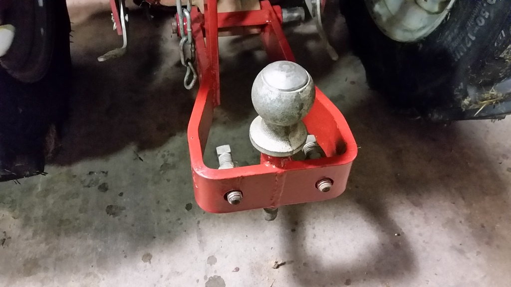

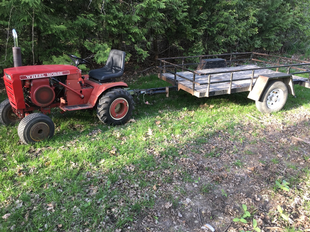

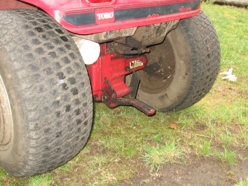

Buzz 503 #1 Posted May 5, 2017 I want to be able to tow my landscape trailer around the yard. What do you guys use to attach a ball to the rear of your 520s? I have a bar that slides in the sleeve hitch of my 856 but this is the setup my 520 has. The existing hitch is too low to the ground for what I need. Thanks. Share this post Link to post Share on other sites

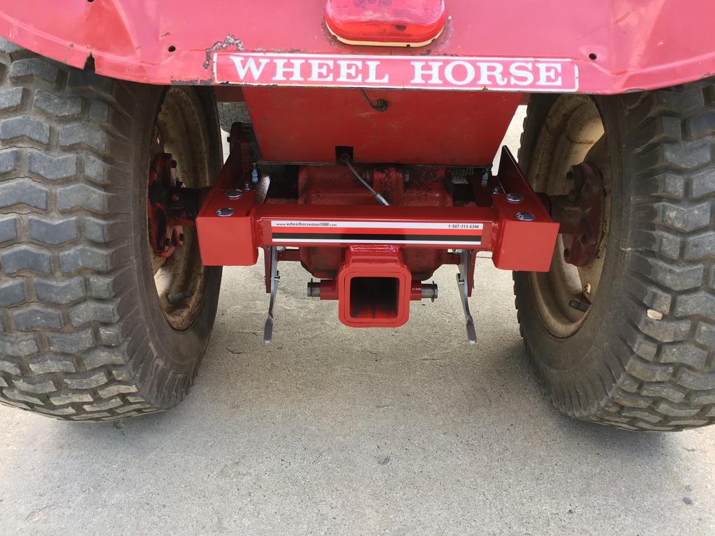

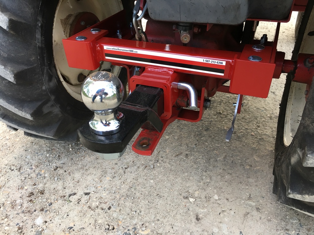

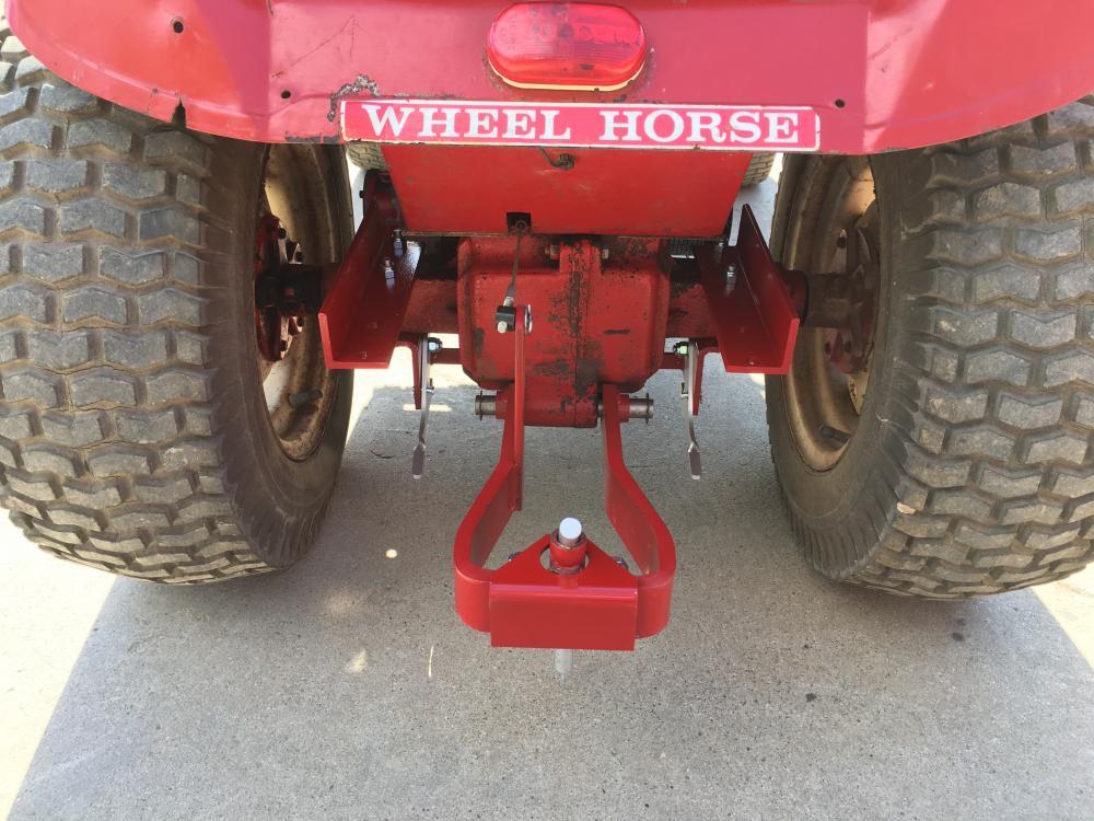

Shynon 7,728 #2 Posted May 5, 2017 Just was out to see @wheelhorseman1000 and he has a sweet looking hitch setup, that is very versatile all painted up and ready to go. I think this will be a must have item. Another well built, custom product for our Wheel Horses. Great job Lowell you are the master fabricator. 4 Share this post Link to post Share on other sites
shallowwatersailor 3,222 #3 Posted May 5, 2017 Check the Vendor Section. Tom has a decent hitch also. Share this post Link to post Share on other sites
classicdmax 190 #4 Posted May 5, 2017 ^what he said. Great product 1 Share this post Link to post Share on other sites

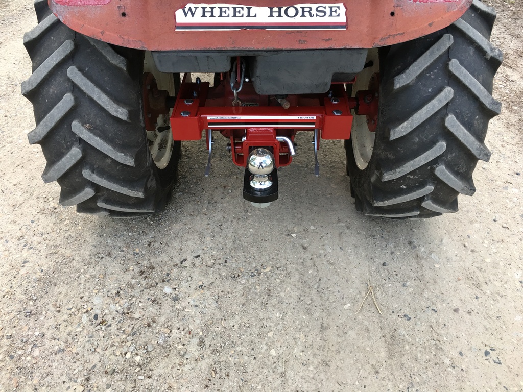

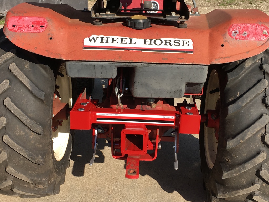

wheelhorseman 3,256 #5 Posted May 6, 2017 This is what I use 11 Share this post Link to post Share on other sites
WHX?? 58,347 #6 Posted May 6, 2017 Um ah ...so much for mums the word!....when does production start? 5 Share this post Link to post Share on other sites
wheelhorseman 3,256 #7 Posted May 6, 2017 1 hour ago, WHX11 said: Um ah ...so much for mums the word!....when does production start? This weekend!!!! 2 Share this post Link to post Share on other sites
cleat 9,405 #8 Posted May 6, 2017 Wow, great upgrade on a proven hitch design. I am fortunate to have heavy duty hitches on two 520's and 2 lifting hitches that will also allow for the use of rear attachments on two others. You have combined the best of both worlds. Really a necessity for those with only one Wheel Horse. You really do come up with some great products. 3 Share this post Link to post Share on other sites

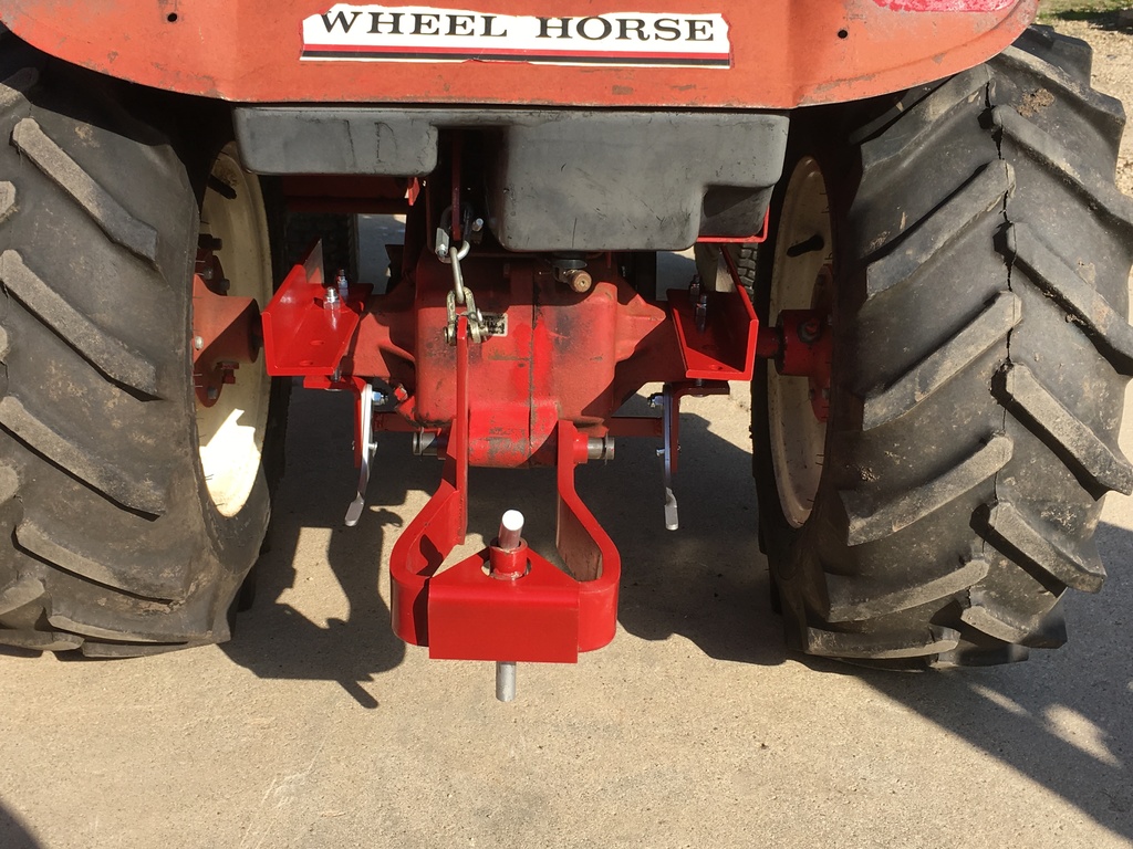

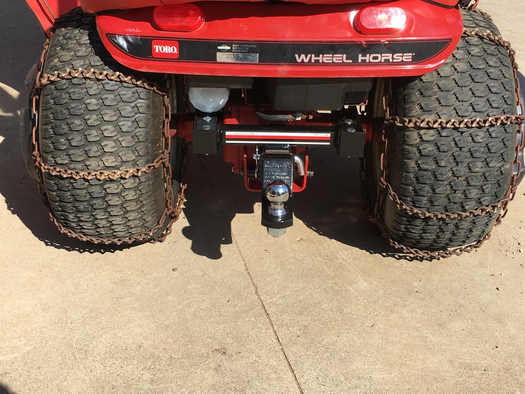

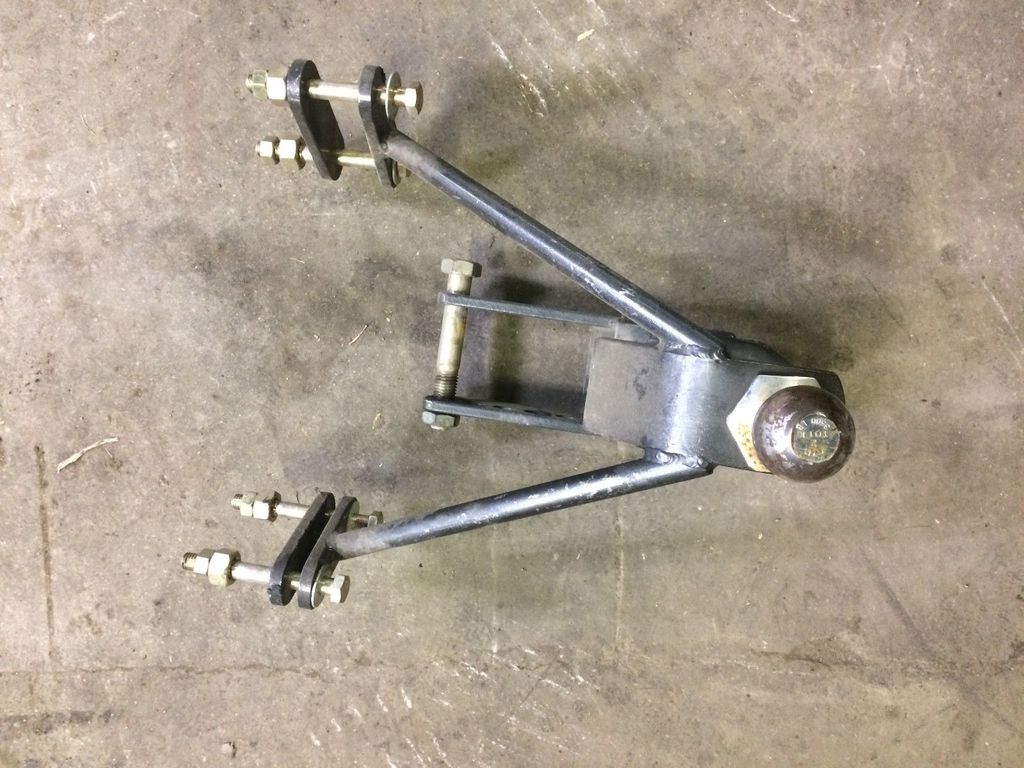

Lee1977 7,809 #9 Posted May 6, 2017 (edited) I don't build them to sell, but I built a couple for my self. This mount to the axle housing and the top of the transmission. This one mounts like "The Hitch Guys" with one exception I can mount the clevis hitch with it . image uploadcertificity.com The clevis hitch has been modified too. Edited May 7, 2017 by Lee1977 4 Share this post Link to post Share on other sites

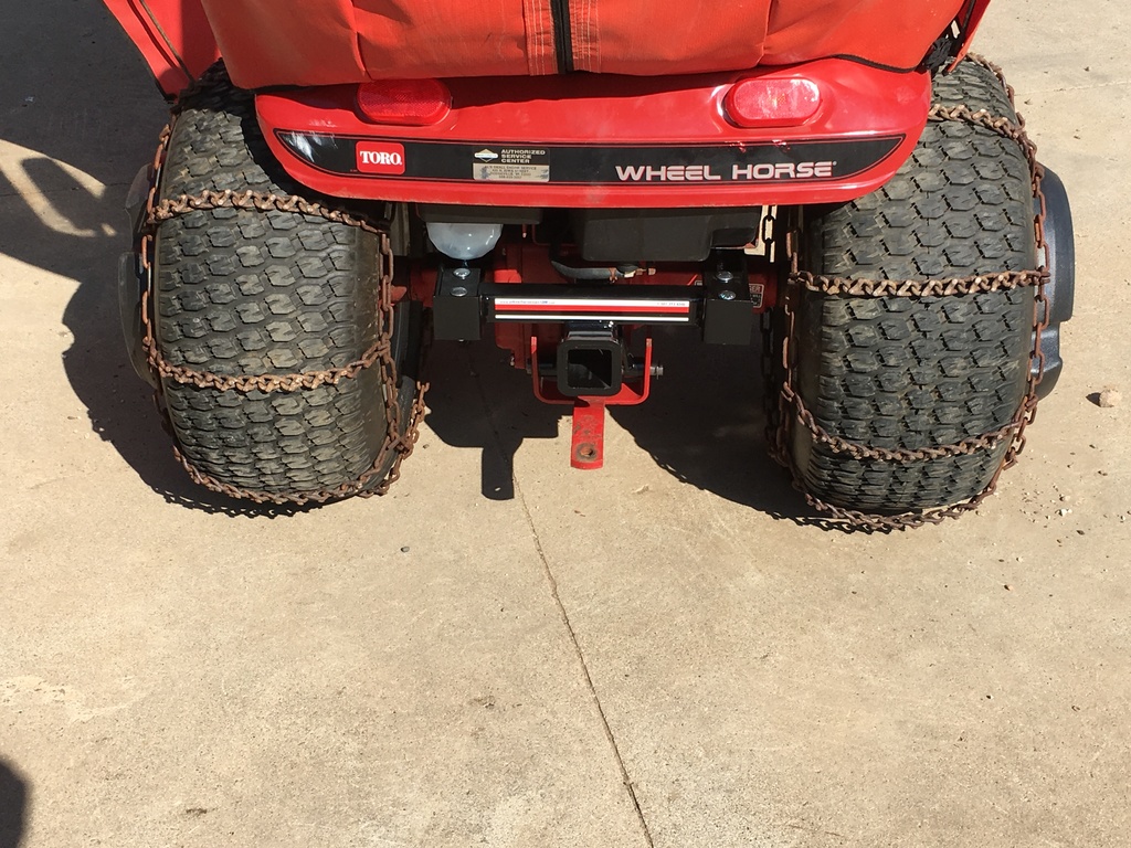

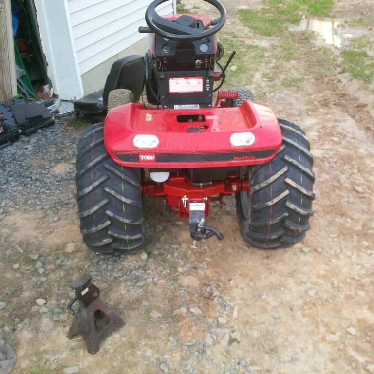

953 nut 70,338 #10 Posted May 6, 2017 I saw this one for sale on a while ago and saved the picture for future reference. It uses the hitch pin at the rear of the transaxle and bolts to the axle housing, Take a look, not too hard to make and gets the hitch ball up where you need it. 4 Share this post Link to post Share on other sites
DennisThornton 4,773 #12 Posted May 7, 2017 13 hours ago, 953 nut said: I saw this one for sale on a while ago and saved the picture for future reference. It uses the hitch pin at the rear of the transaxle and bolts to the axle housing, Take a look, not too hard to make and gets the hitch ball up where you need it. Just when I think I've seen every style of rear hitch I see a really nice improvement and then something radically different! I'll be following for sure! 2 Share this post Link to post Share on other sites

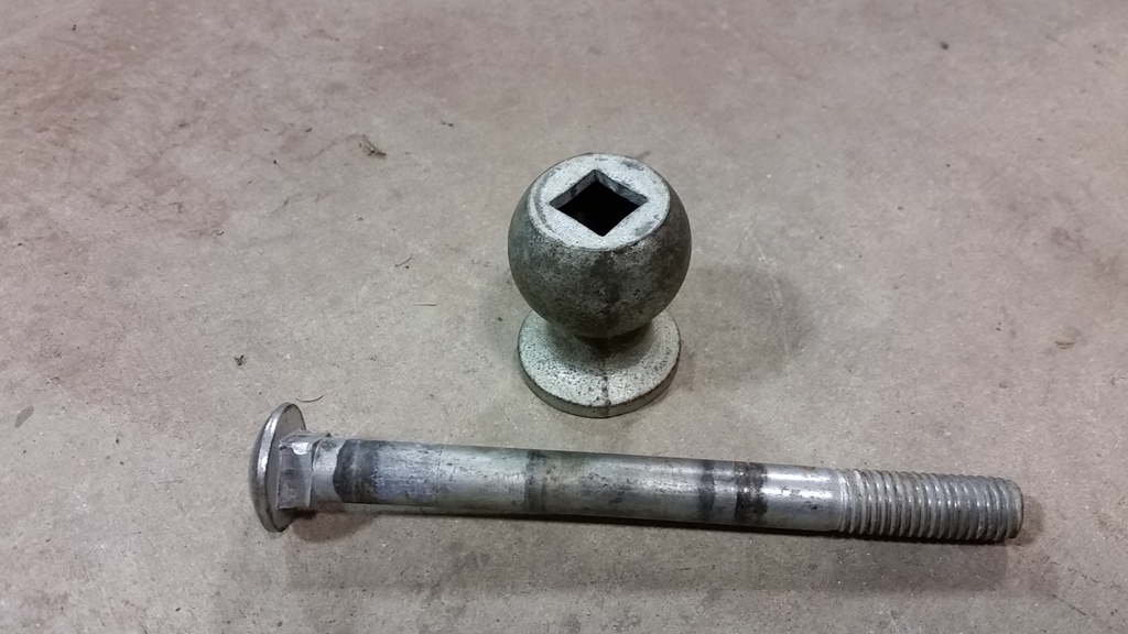

Thor27 892 #14 Posted May 7, 2017 Real basic here. Ball with a 5/8" carriage bolt found in a box of stuff from a purchase Fits perfectly here. 1 Share this post Link to post Share on other sites
