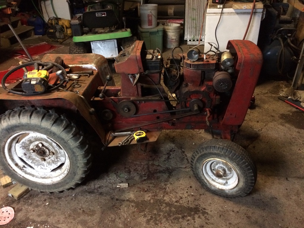

Bakersenterprises 23 #1 Posted May 5, 2017 I'm looking for the motor oil drain plug on 1962 953 wheel horse 12 Share this post Link to post Share on other sites
953 nut 70,338 #2 Posted May 5, 2017 The engine oil drain plug is on the bottom of the oil pan. Love the chuck wagon, what time is supper? Oh, by the way, the 953 was a 1963 model, but if your serial number begins with a 62 it is a very early production unit. 2 Share this post Link to post Share on other sites

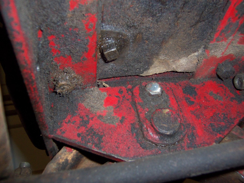

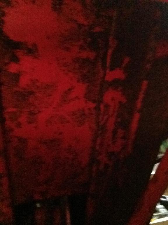

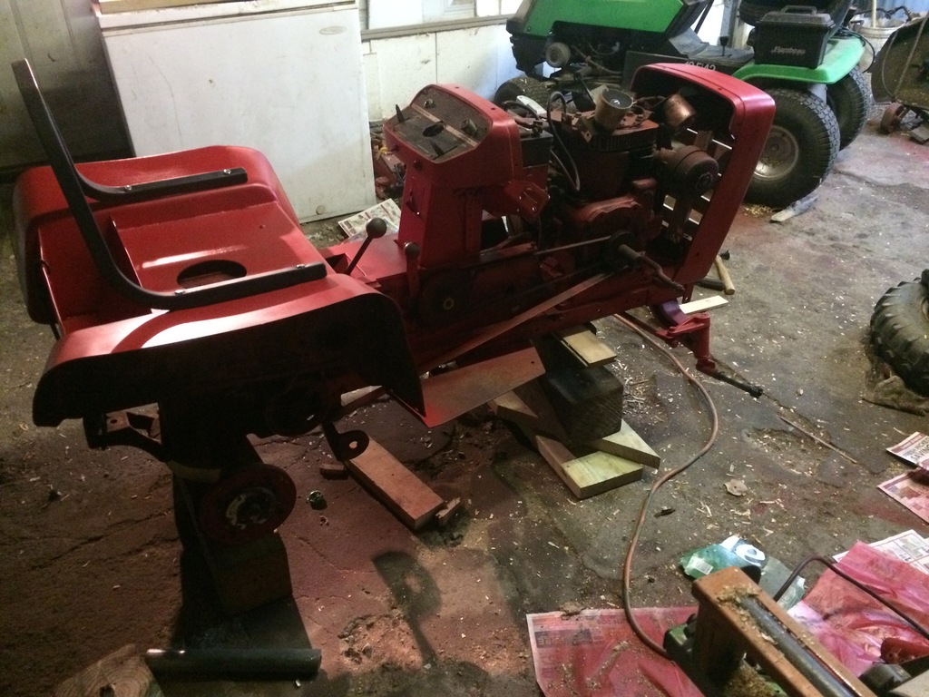

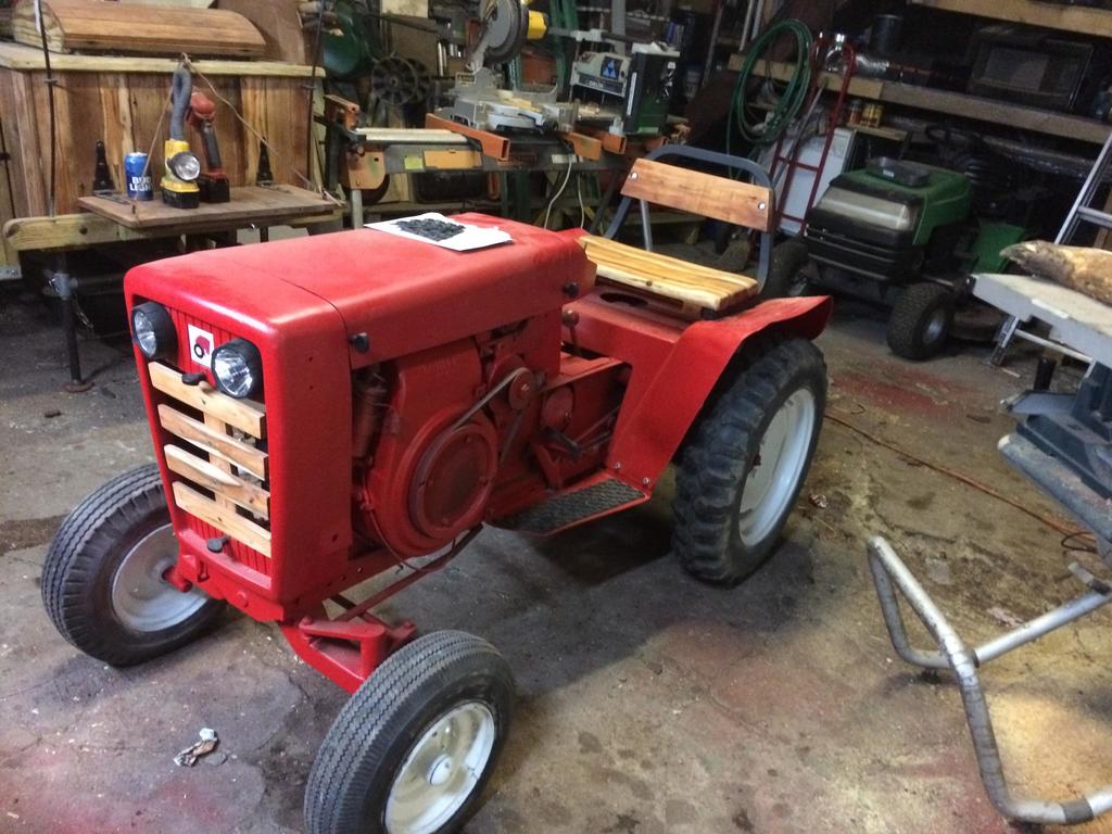

Bakersenterprises 23 #7 Posted May 5, 2017 Thanks for the likes.. there is no drain plug on the oil pan... Few more pics 3 Share this post Link to post Share on other sites

Bakersenterprises 23 #10 Posted May 5, 2017 7 minutes ago, WHX11 said: Love that wood work eh 953nut!! How often you see wood on a horse. You two guys must have went to the same school of woodworking. Bet you built the wagon too Baker? Yes I did thanks! I'm still looking for the oil drain plug. There nothing on the oil pan bottom of motor or on the side of the block 12 hours ago, 953 nut said: The engine oil drain plug is on the bottom of the oil pan. Love the chuck wagon, what time is supper? Oh, by the way, the 953 was a 1963 model, but if your serial number begins with a 62 it is a very early production unit. Seems like there no oil plug anywhere on the bottom or side of block thanks all for the likes Share this post Link to post Share on other sites
pfrederi 21,306 #11 Posted May 5, 2017 Kohler parts shows a pipe plug in the end. You have the deeper pan Share this post Link to post Share on other sites
Bakersenterprises 23 #12 Posted May 5, 2017 Thanks, there is no plug. It's milled out flat area for one on each end of block. But no drain plug. I may have to bore and thread one in. 1 Share this post Link to post Share on other sites

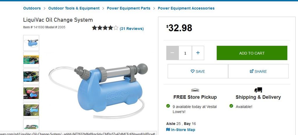

Bakersenterprises 23 #14 Posted May 5, 2017 Scary thought, runs good sounds great.. long story short repair shop in Florida claims there a pump they used to suck oil out of other brands. Share this post Link to post Share on other sites
pfrederi 21,306 #15 Posted May 5, 2017 Couple of ideas...make sure you have it well warmed up so the gunk maybe in suspension so the pump can get it. 1 Share this post Link to post Share on other sites
953 nut 70,338 #16 Posted May 5, 2017 (edited) 6 hours ago, Bakersenterprises said: no oil plug anywhere No telling what has been done during the past half century plus. Three of mine appear to have original engines and all of them have a pipe plug on the bottom of the pan between the frame rails. Edited May 5, 2017 by 953 nut 1 Share this post Link to post Share on other sites
WHX?? 58,347 #17 Posted May 5, 2017 That is just bizarre that it has no drain plug. Maybe back in the day it was made it just missed a machining step??? Those oil pumps are used for changing oil in marine inboards. 1 Share this post Link to post Share on other sites
953 nut 70,338 #18 Posted May 5, 2017 8 hours ago, Bakersenterprises said: no oil plug anywhere on the bottom Just so you will know I am not a delusional old man (well not about the oil drain plug anyway ) I took a picture of the drain plug on my old worker. This is from under the 953 looking forward. 1 Share this post Link to post Share on other sites
Bakersenterprises 23 #19 Posted May 5, 2017 Thanks I do not have in the same place 1 Share this post Link to post Share on other sites
Bakersenterprises 23 #20 Posted May 5, 2017 Thanks to everyone for the help. I only found 4 mount bolts. Nothing on each end of the block. I was trying up load pic. So all could see. Some reason it exceeded the allowed 2.55mb. It is a k241 motor ss#. 62-534 4 hours ago, pfrederi said: Couple of ideas...make sure you have it well warmed up so the gunk maybe in suspension so the pump can get it. 1 Share this post Link to post Share on other sites
pfrederi 21,306 #21 Posted May 5, 2017 When dealing with 50 yr old stuff you just never know what has happened.... I guess a pump is easier than turning the tractor upside down 3 Share this post Link to post Share on other sites
Bakersenterprises 23 #22 Posted May 5, 2017 Yes, warm the oil understand thanks so much 2 minutes ago, pfrederi said: When dealing with 50 yr old stuff you just never know what has happened.... I guess a pump is easier than turning the tractor upside down N few wheelys oil be drained 1 Share this post Link to post Share on other sites
