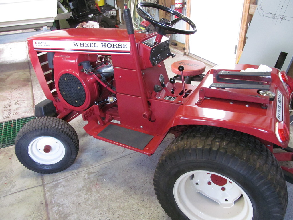

tallen4392 71 #1 Posted May 4, 2017 Do any of you folks know if a c101 has 1 1/8 axles in it thanks Share this post Link to post Share on other sites
oldlineman 1,802 #3 Posted May 4, 2017 I have a 1979 and it has them. Share this post Link to post Share on other sites
C-101plowerpower 1,606 #4 Posted May 4, 2017 mine doesnt Share this post Link to post Share on other sites
tallen4392 71 #5 Posted May 4, 2017 So am i to assume that some came with them and some did not ?????? Share this post Link to post Share on other sites
Racinbob 13,118 #6 Posted May 4, 2017 I'm thinking because it a European build maybe? 1 Share this post Link to post Share on other sites
C-101plowerpower 1,606 #7 Posted May 4, 2017 Just now, Racinbob said: I'm thinking because it a European build maybe? that and mine has a 4speed Share this post Link to post Share on other sites
Racinbob 13,118 #8 Posted May 4, 2017 (edited) It's interesting about all the differences. All the C-series over here had 8 speeds and 1.125" axles.............wait, that's what they all are spec'd with. We all know the things Wheel Horse did at times. Edited May 4, 2017 by Racinbob 2 Share this post Link to post Share on other sites
Ed Kennell 47,105 #9 Posted May 4, 2017 Mine has 8 gears and 1- 1/8" axles. 4 Share this post Link to post Share on other sites
953 nut 68,774 #10 Posted May 4, 2017 31 minutes ago, Racinbob said: European build maybe? Or a previous owner put the four speed in it at some time during the past half century. 4 Share this post Link to post Share on other sites
stevasaurus 23,816 #11 Posted May 4, 2017 The #5086 transmission has the hi/low range shifter with 1" axles (4 pinions). All 1 1/8" axles newer then 1967 will have the hi/low range shifter with either 8 or 10 pinions in the differential. I would just measure the axle on the outside of the hub. 1 Share this post Link to post Share on other sites
meadowfield 3,177 #12 Posted May 9, 2017 I've had a C-81 and 312-8 transmission both with 1" axles... Bendys front end is 1" axle 1 Share this post Link to post Share on other sites
