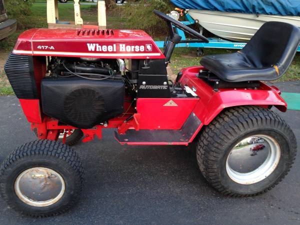

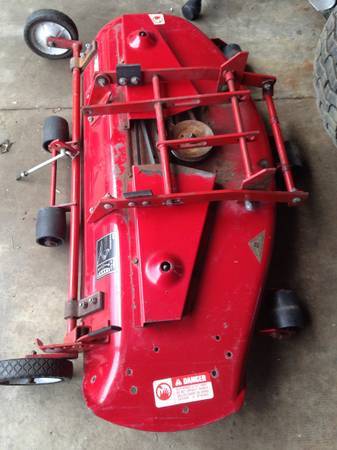

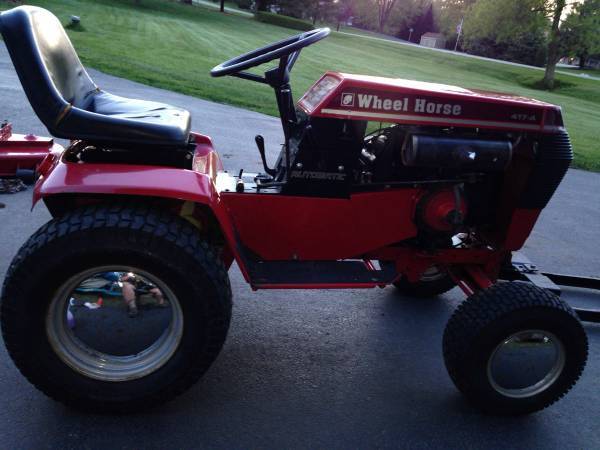

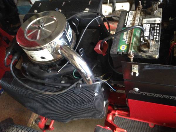

scubaduderon 18 #13 Posted May 5, 2017 Hey, thanks everyone for all your help. I'm gonna try to post a pic of it. Looks to be in very good shape and the owner did not hesitate when I suggested a pull test for the tranny. It is coming with the original 42" deck and snow blade. What do you guys think a fair price is for what you see? Thanks you, Ron 5 Share this post Link to post Share on other sites
WHX?? 58,347 #14 Posted May 5, 2017 Only thing I can say is priceless Dude.....ugly seat aside I would go 900 in my area. ...more if my grass was getting long. 2 Share this post Link to post Share on other sites
SPINJIM 1,998 #15 Posted May 5, 2017 The 417 in your pictures looks to be in great condition. I paid $600 for my 417-8 speed with electric lift, and it wasn't in such good shape, and it didn't have a deck. Automatics with hydro lift bring more. I bought my 418 Automatic for $800 with a snow blade, weights, and 42" deck, but I was surprised when the seller accepted my low offer. I've noticed that spring time has been bringing higher prices on WHs, so I think that anywhere from $800 to $1000 would be fair considering the low hours. Offer him $800, but be very willing to go higher if everything checks out. Be sure to check the spindles on the deck, and ask why the deck is off of the tractor. You'll love the 417A. Good luck, Jim 1 Share this post Link to post Share on other sites
scubaduderon 18 #16 Posted May 8, 2017 Well, I bought her and successfully got her home! That was an adventure I'll relate later. She seems healthy too. Dug a couple of holes to test the trans. No problem. She starts up almost instantly from cold (low 50's) with just a tad of choke. The deck is very clean and the spindles are perfect because the deck was rarely used. He claimed maybe 5 or 6 uses. The fellow who originally owned the tractor used it mainly in the winter for pushing snow. He had a dedicated mower for his grass. The snow blade is in fair shape, but it is a little different than what I have seen online so far, One of the linkage parts seems home made. Maybe its looks different because of the hydraulic lift, I'm gonna have to research that. I'll put up some pics with my questions when I get settled into the new house. I'm gonna be asking lots more questions on how to get her back to tip top shape. I realize I'm gonna have to work on tightening up the linkages and what not. Also at least one of the hubcaps needs to be smoothed out and polished. Lots of little spots of rust starting to creep out too. I need to learn how to fix these rust spots and paint them. Also most of the decals have faded out, so It looks like about $90 for those. Is there a guide available here for guys who want to tune up the function or restore their 417-A's? If not their aught to be. The fellow I purchased her from is into Sears Suburban garden tractors from the 60's and 70's. Wow, are they nice! And talk about built like a tank! If any of you guys can help me get her back into tip top shape with tips on the linkages and other things I have mentioned I would really appreciate it! Thanks again for all your help so far. Hopefully I'll be able to return the favor one day! Smiling from gear to gear, Ron Share this post Link to post Share on other sites
