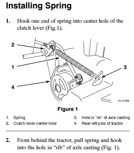

gwest_ca-(File Mod) 10,530 #1 Posted May 3, 2017 Recently someone asked which hole the clutch pedal return spring goes into. Found this. Garry 9 Share this post Link to post Share on other sites
bizzo15 52 #2 Posted May 3, 2017 2 hours ago, gwest_ca said: Recently someone asked which hole the clutch pedal return spring goes into. Found this. Garry That was me in one of my posts and it turns out the previous owner had installed the spring in the wrong hole. Awesome find Garry! 2 Share this post Link to post Share on other sites
elcamino/wheelhorse 9,076 #3 Posted May 3, 2017 Thanks Garry , I had the same question , now as soon as all my parts arrive, I can get started on the repair. 2 Share this post Link to post Share on other sites
Racinbob 10,391 #4 Posted May 4, 2017 Although the installation is the same that drawing is showing a transmission with the brake drum on the spline shaft. You may have a transmission with the drum on the 11-44 shaft. The brake band will be flipped around and the spring will 'ride' over the band and rub it. That's normal. 2 Share this post Link to post Share on other sites
