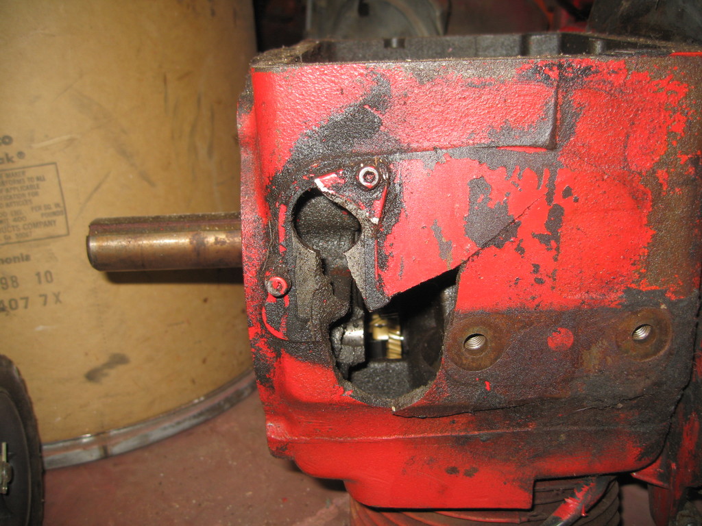

Shynon 7,642 #7 Posted May 2, 2017 Throw them out unless you want one of these. 3 Share this post Link to post Share on other sites

ClassicTractorProfessor 5,455 #14 Posted May 2, 2017 Another vote here to throw them out, my opinion its not worth the risk of ruining a block to lose a small amount of vibration. 5 hours ago, Shynon said: Throw them out unless you want one of these. Nothing a little JB Weld can't fix there When my old K301 let go last summer it blew that whole side out of the block, leaving the starter/generator laying on the battery, showering my right leg with oil, and sending fragments as far at the neighbors yard across the street. Definitely not an experience I'd like to repeat Share this post Link to post Share on other sites
