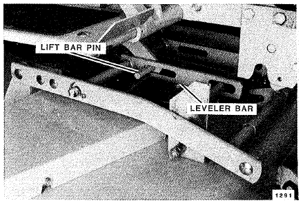

rmaynard 17,572 #4 Posted May 1, 2017 Once the lift bar pin is in the slot... The attachment rod it hooked to the tach-a-matic hitch as shown. 2 Share this post Link to post Share on other sites

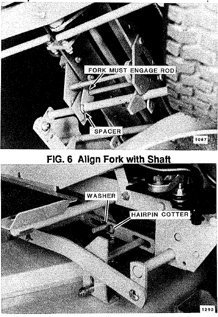

daveoman1966 3,884 #6 Posted May 1, 2017 (edited) You MUST get that fork into the rod. That is what sets the mower deck in a forward / back position (and locks it there) so as to maintain a fixed position in relation to the tractor. Without that fork/rod set CORRECTLY, the deck will slop back a forth and you'll NEVER get the belt adjusted right...evn if the correct belt. Edited May 1, 2017 by daveoman1966 2 Share this post Link to post Share on other sites

daveoman1966 3,884 #11 Posted May 1, 2017 (edited) Agreed.... using a 2x4 pry rod to lift front of deck makes quick work of it. This pic help? ? ? Edited May 1, 2017 by daveoman1966 Share this post Link to post Share on other sites
