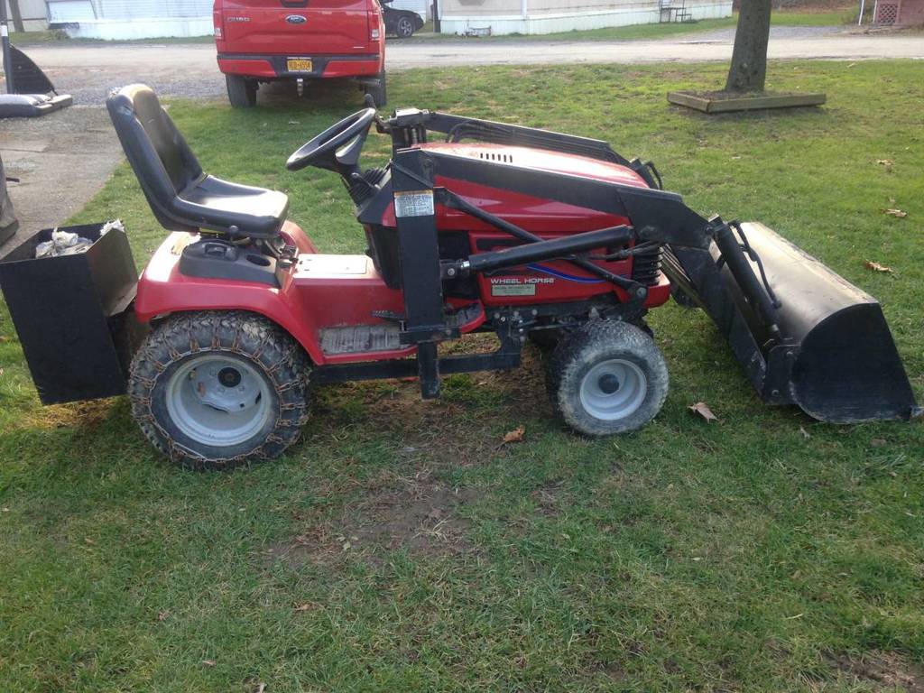

jre302 4 #1 Posted May 1, 2017 I bought a used Toro WH 520Lxi over the winter. The FEL came in very handy moving snow this winter. Now the spring is here in WNY I started moving some dirt in my yard. I noticed oil was leaking from the rear axle. Jacked it up and have a lot of play on the same axle with the leak. Bearings and seals repair to start the spring. Nayone have any advice before I start dismantling it?? Thanks 1 Share this post Link to post Share on other sites

stevasaurus 23,861 #8 Posted May 2, 2017 If you have any side to side and/or up and down play in the axle, you will have to open the transmission to replace the bearing. sorry. Share this post Link to post Share on other sites
jre302 4 #9 Posted May 3, 2017 Left axle has a ton of play. Bearing must be shot. Right side is fine, but new bearings and seals anyways. Hubs are are stuck on pretty good as well. Heat and gear puller after it soaks with PB blaster for a couple of days. Tractor seems very very well built as I disassemble it. The FEL looks like it comes off pretty easy as well. Need to find a mowing deck for it now. 1 Share this post Link to post Share on other sites
